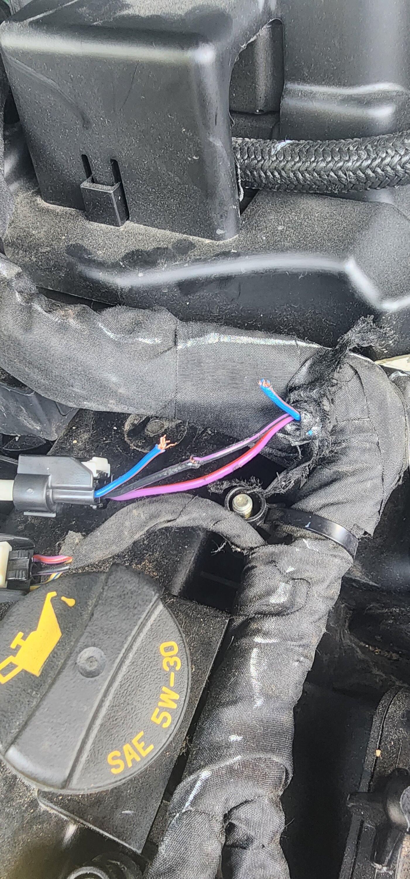

Figured they would charge an arm and a leg, i think i am just over thinking it. If its as straight forward as twisting three wires together and then tapping i think ill be okay.
Don't just twist them together and tape. If possible solder the wires and use heat shrink tubing to insulate the repair. If you can't solder, use butt connectors and use heat shrink to insulate. Super easy repair. If you can't find the repair connector, you have enough wire with the damaged part to repair and reuse it.

Will do thank you! Can i use 18 gauge wire to reconnect the broken parts?

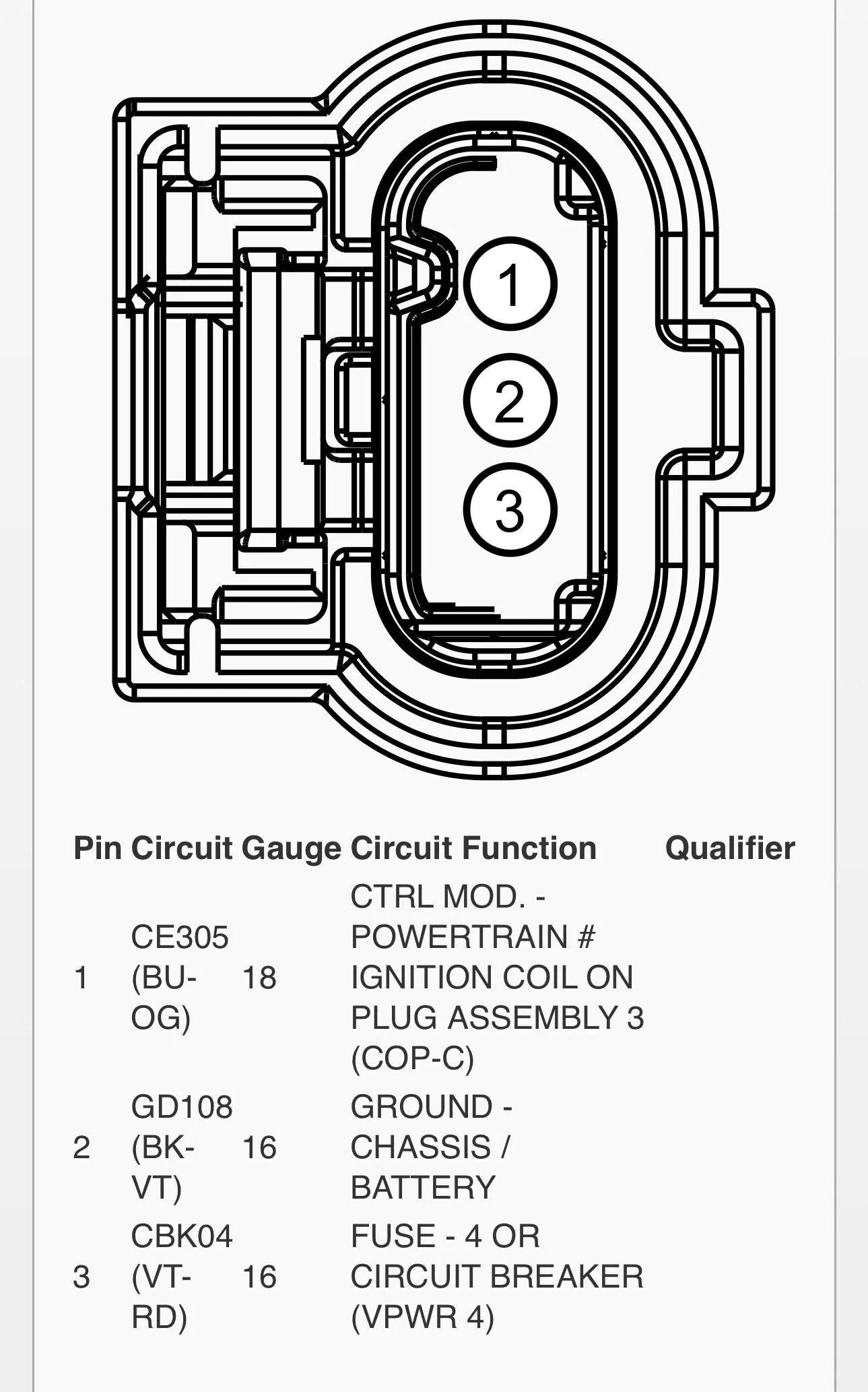

Blue cable 16 and other are 18?
Ducati1098
10,063
23,455
Midwest
Okay so i do need 18 then since the blue cable is the one completely severed
If you only need to fix that one, yes. Ideally you’ll want to use what the previous wire was. Worse case if all 3 are damaged, you can go slightly larger and use 16 on all 3. Just don’t use a smaller gauge wire
I will go 16 just to play it safe then! Thank you!

Solder if you can, always better long term than a crimp connection. Finish with shrink tube, just don't forget to slip the shrink tube onto the wire before making the repair....

last annoying question! How does this look to you? I peeled everything back i think i have more than enough cable.
If you have enough room, just splice the sides back together and don’t worry about ordering the new pigtail. I would fix that black/violet wire also.
It was just difficult for me to see how bad it was from the first picture.
