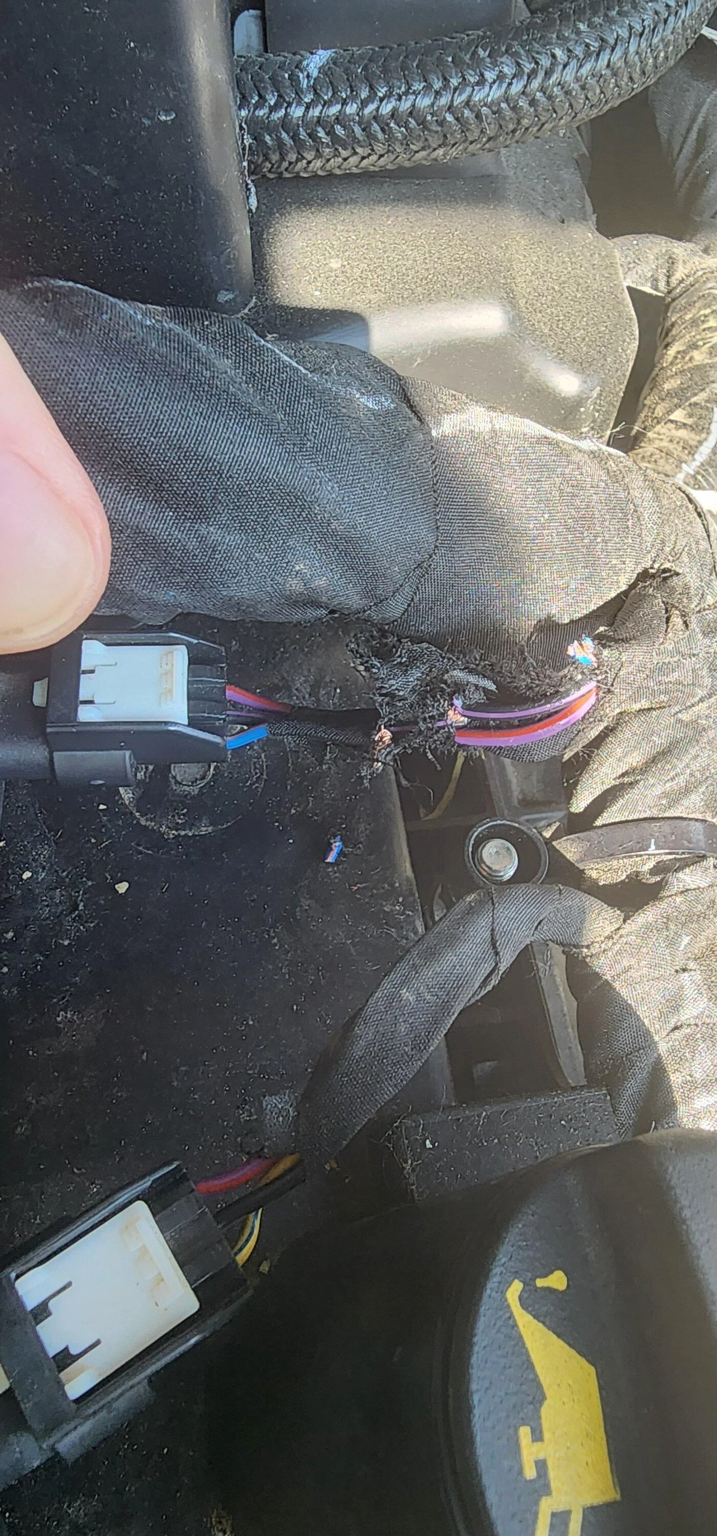

How good are you with wiring looks like you should be able to repair this your self fairly easily.
I would think the easiest way to approach this would be to peel back some of the wire protector then strip back the wires. Probably want to replace the actual plug end and rewire all three as you don't have much to work with on the blue wire.
Or just do a jumper and terminate both ends of the chewed through blue wire and call it a day

i think you're right. Blue wire is completely broken. Is this repairable? Can you link the part i would need?

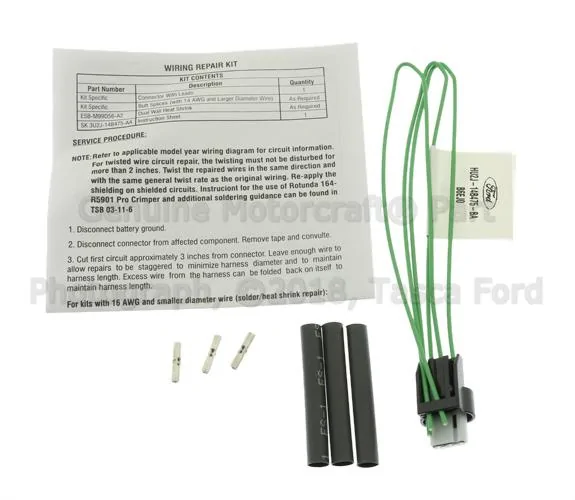

Yep, that's your problem! here is the part number for the pigtail connector. I would just wire a new one in. HU2Z-14S411-BA
Would they sell something like this at an auto shop? Do i just unwrap the tape and disconnect the old and plug in the new?
They probably wouldn't have this exact connector, no. You'll need to buy this exact connector from a dealership or maybe you can find it online.
You'll need to cut off the old connector and chewed wiring, cut back some of the harness tape to get to a good part of the wires that isn't chewed, strip some of the wiring insulation back, then splice the new connector on. You can solder it if you want, but the crimps that are supplied with this pigtail connector are more than adequate for the job. Don't forget to put the heat shrink over the wiring before crimping or soldering the wires. then just melt the heat shrink and tape up the harness.
Thanks for the help, real bummer this is the situation:/ was more comfortable doing to coil Change. Well i will go try to track this down now i guess
If you aren't comfortable with wiring, you can just buy the connector and have any shop wire it on. Doesn't need to be a Ford dealership.

Figured they would charge an arm and a leg, i think i am just over thinking it. If its as straight forward as twisting three wires together and then tapping i think ill be okay.
Just make sure they are crimped or soldered, also make sure to use the heat shrink before taping things back up. Both are critical for a correct wiring repair. I would not just twist and tape
Is a jumper just connecting the two broken pieces?
Correct. That would be my approach just make sure you use some quality connectors to ensure a good connection and cover in heat shrink. +100 if you can solder.

This might be the way until my part arrives. What type of wire do you recommend, and would i be able to get it at a hardware store?
