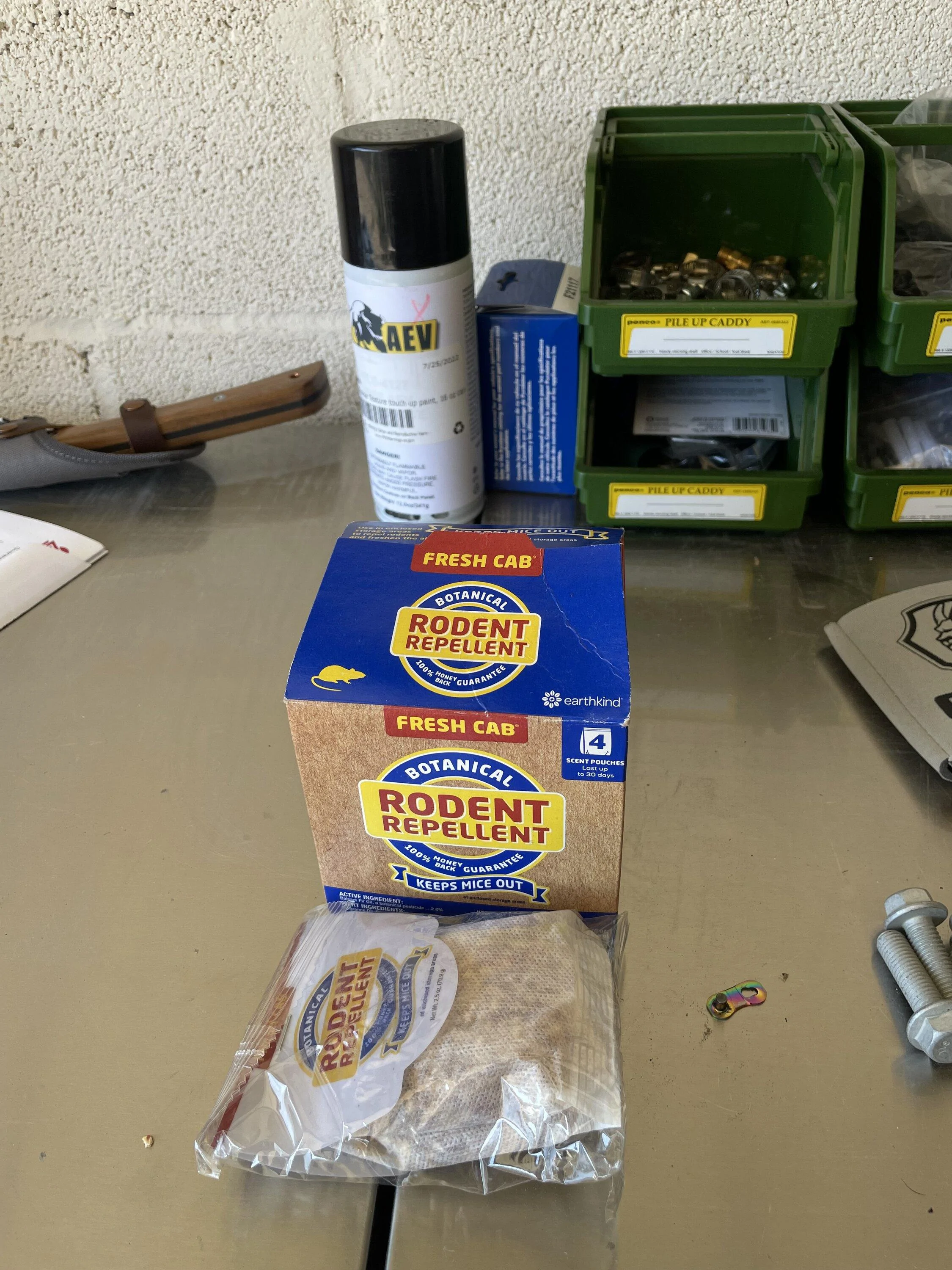

I put this stuff in the engine bay- helps keep mice out. And Bobcat Urine is pretty magic as well; used int in my FJ40.
Ford Bronco Coil failure 8k miles in. IMG_7185
