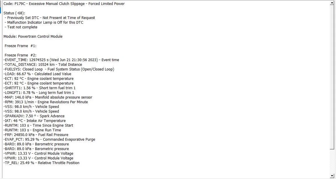

Has anyone ever gotten the below code and wrench light on their dash before? It happened yesterday when we hit 110 degrees outside while I was set on cruise control around 65mph and it suddenly lost power and went into limp mode. I ran FORScan when I limped it home and chalked it up to a hot clutch, but this morning the clutch pedal still feels spongy and there is some slip but I guess not enough to throw the code. I guess I'll see what happens as the temperature climbs today. Any thoughts or suggestions?

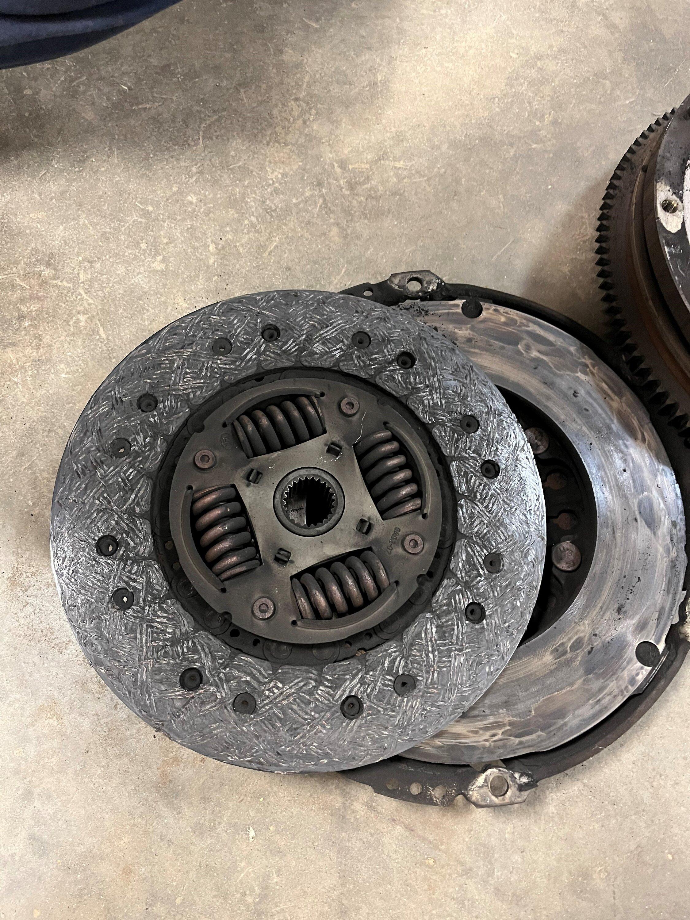

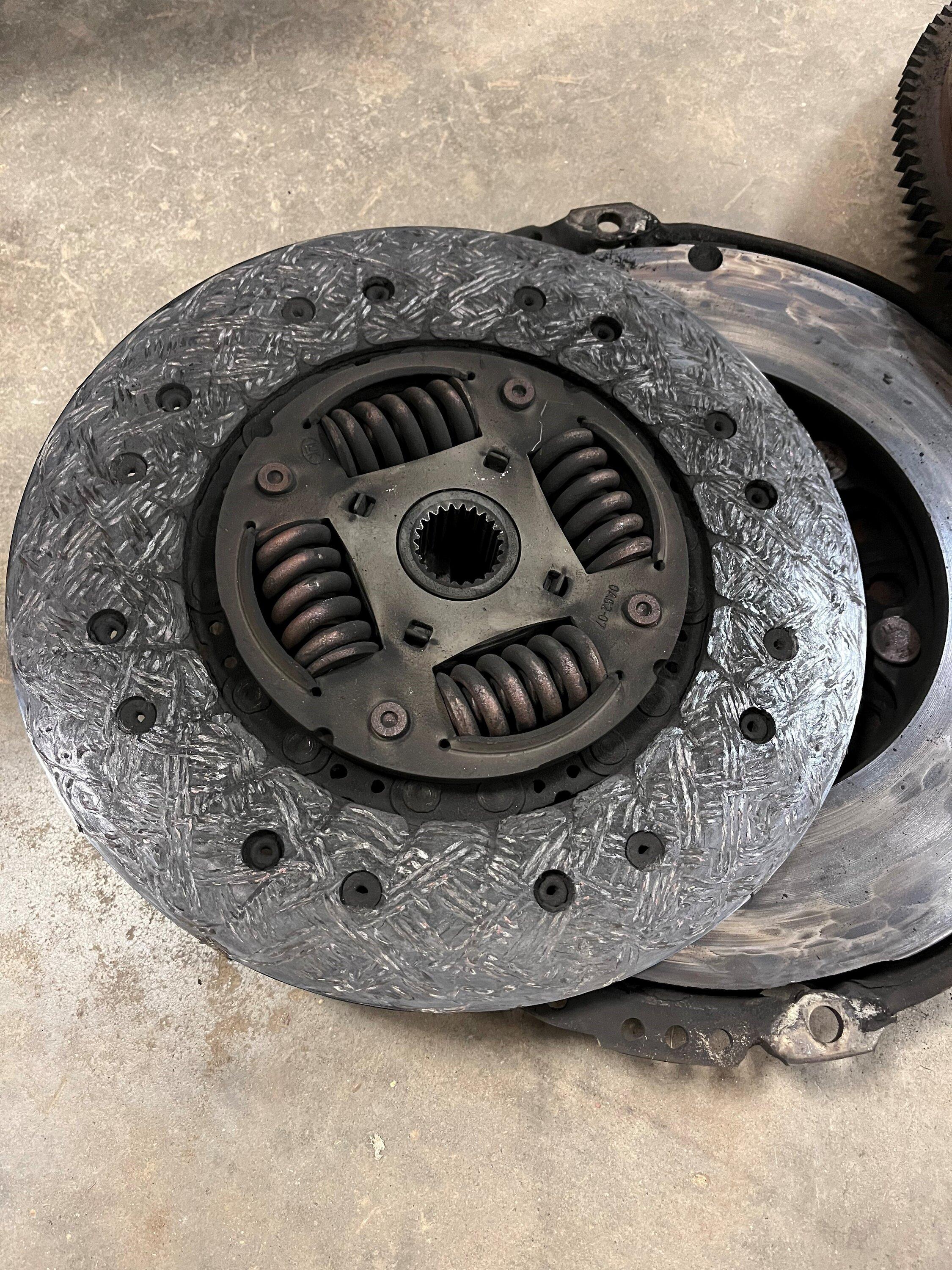

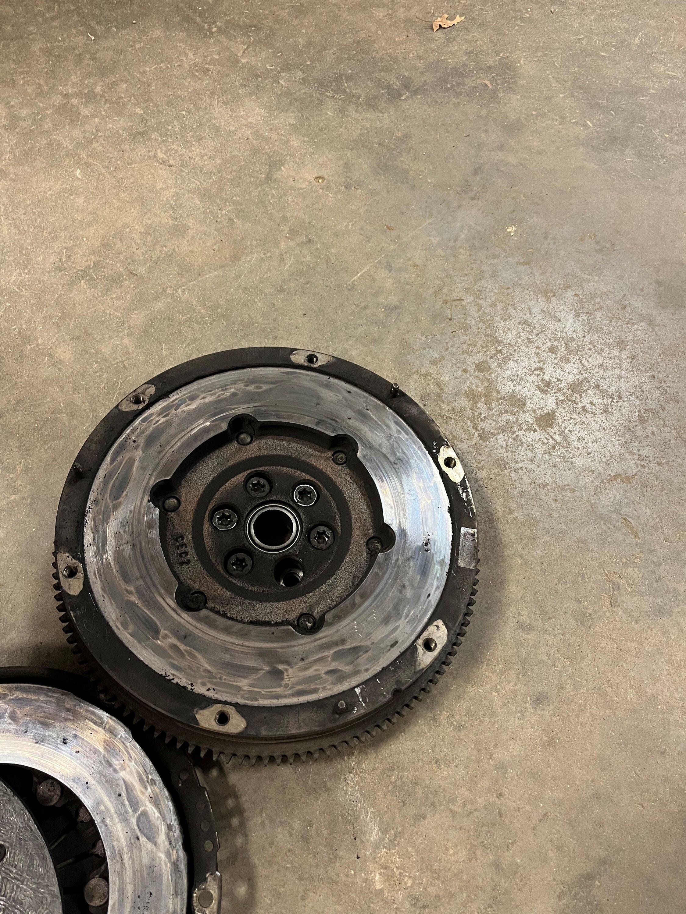

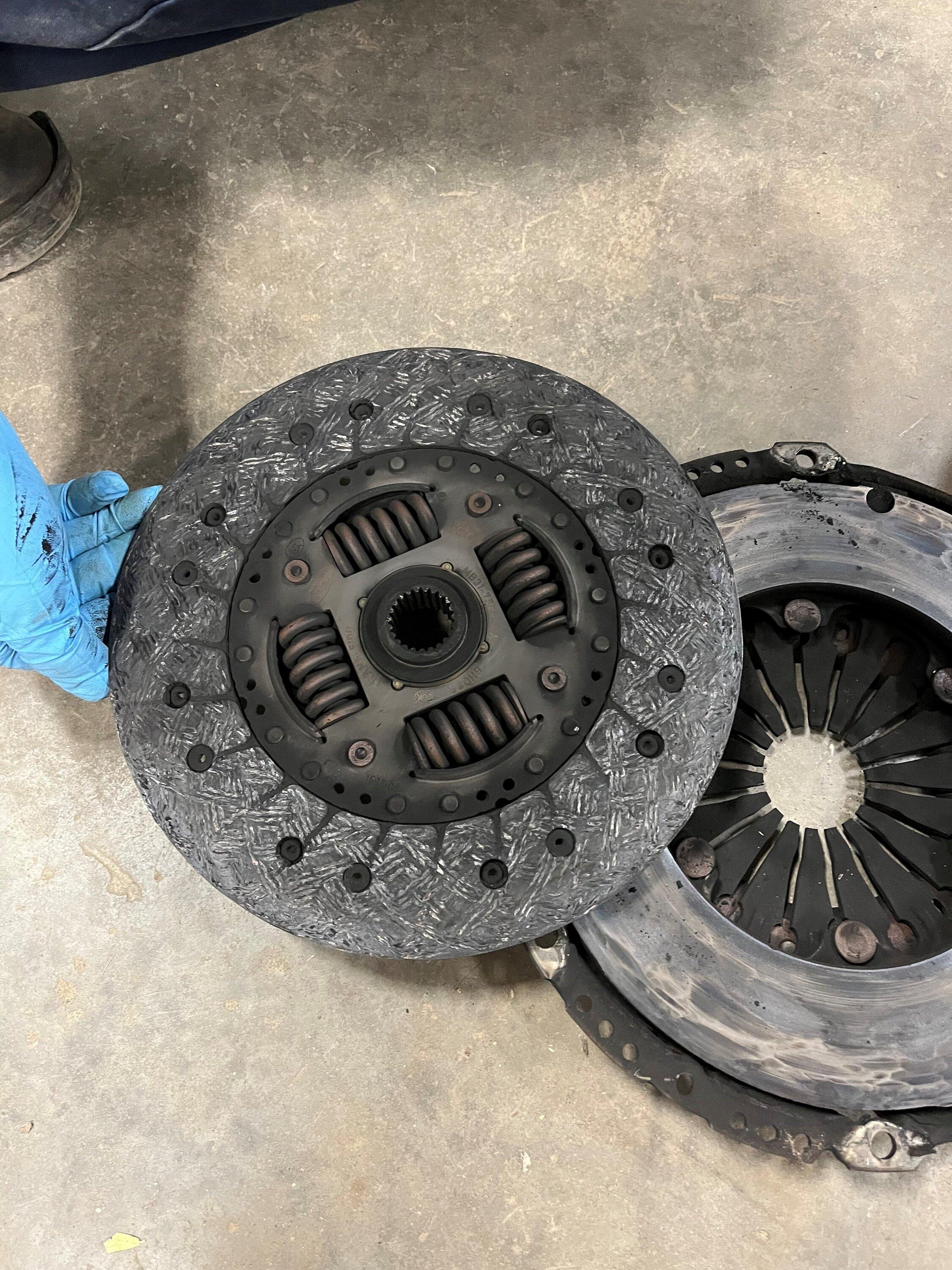

As promised, pictures of the old clutch:
Ford Bronco Code P179C clutch4
Ford Bronco Code P179C clutch3
Ford Bronco Code P179C clutch2
Ford Bronco Code P179C clutch1

OUCH...hurts to look at! I think I smell it too!
Literally smoked to a crisp. I don't claim to be gentle on my equipment, but damn I don't know what I did to cause that.
