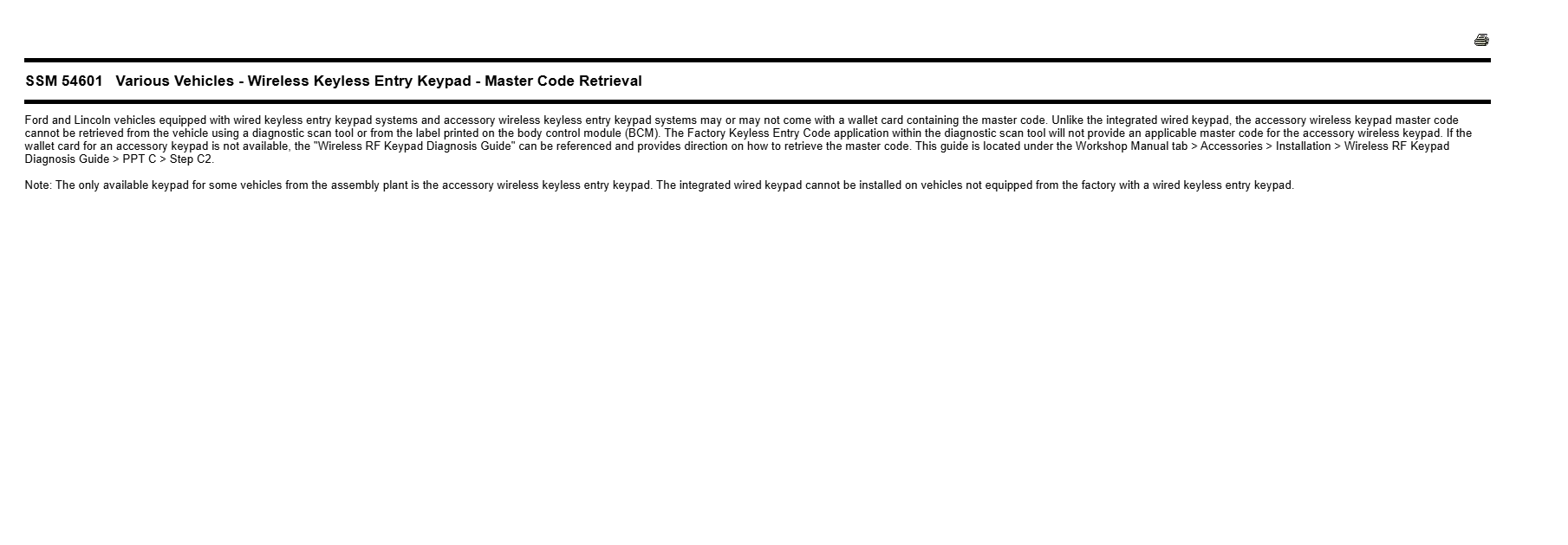

The dealership's service department can look it up.
The code by interior fuse box would be for the hard-wired keypad IF the Bronco had a hard-wired keypad. It does not... it's a wireless accessory keypad since the doors are removable.
