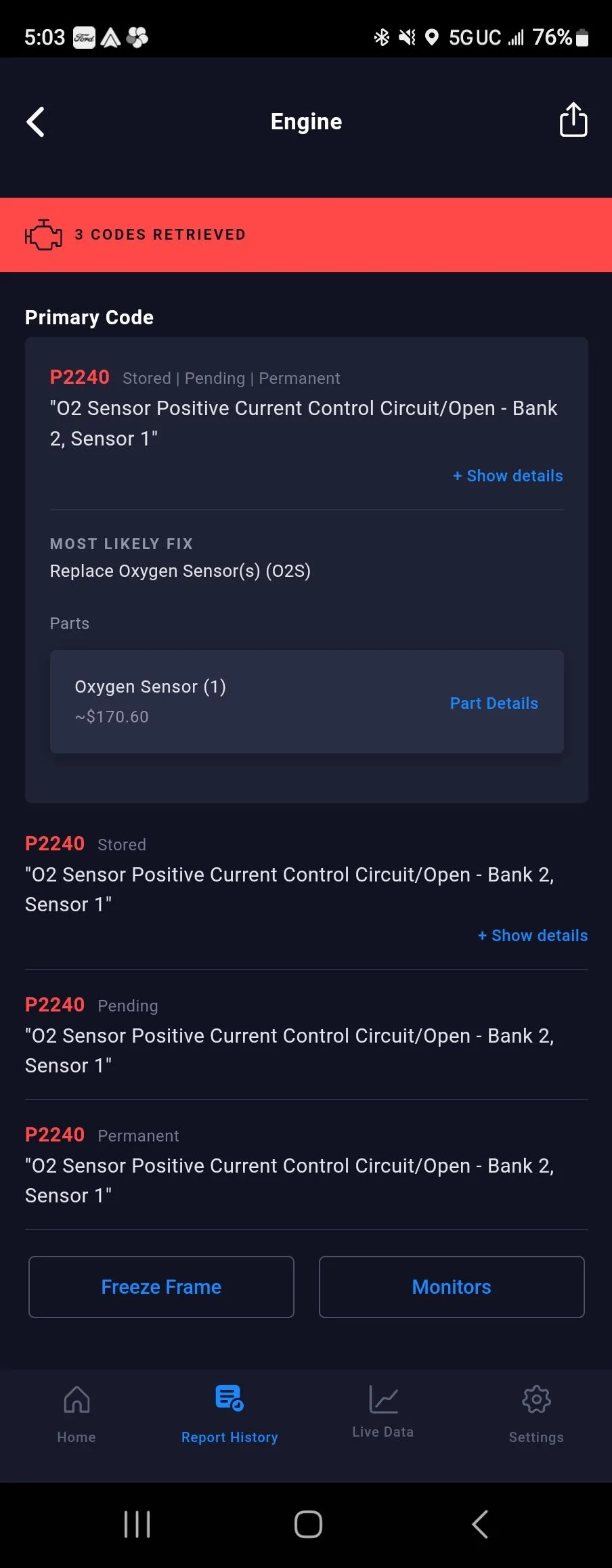

My truck (600 miles) threw code p2240 today. Which is an O2 sensor code. Just wanted to get some feedback on what people this this could be and if this is just the truck recalibrating to some bolt-ons I've installed.
Flowmaster outlaw cat back exhaust
Mishimoto oil catch cab
K&N air intake
**Update - dealership just confirmed a bad sensor and replaced**
Ford Bronco P2240 code Screenshot_20240213_170332_RepairSol2

It’s a circuit code, so it likely has nothing to do with your modifications.

Thanks, I cleared the code so I guess I'll just wait to see if it comes back

Ford dealership just confirmed the sensor was just bad and replaced
