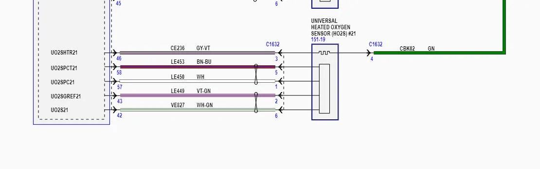

The code is saying there is a signal issue on either the BN-BU or WH wires on the driver front sensor. The pin point test has them check wire resistance from the connector at the O2 to the PC, if it's below 5 ohm and there are no pins messed up, pushed out, corroded and only the code, it says to replace the sensor and reset the keep alive memory.
The figure 8 looking thing on those wires indicates they're shielded to prevent RF or other interference. Should be pretty straight forward if the wires and terminals are good, a new sensor doesn't fix it, then it's probably a the PCM. That said, you can have acceptable resistance in a wire but it not be able to carry current if the copper strands are interrupted or damaged. I don't believe there's much current on these since it's signal.
Some of this shit is getting really complicated and might require an oscilloscope either the Ford one or Picoscope to check for "noise". We've seen weird shit happen when coils go bad and produce a lot of RF. Could also have a little corrosion bridging between the wires which can be nearly impossible to detect just with impedance testing. If there's a question of wiring, we would overlay the wires to bypass anything in between the sensor and PCM as a process of elimination if normal diag doesn't lead to a resolution.
