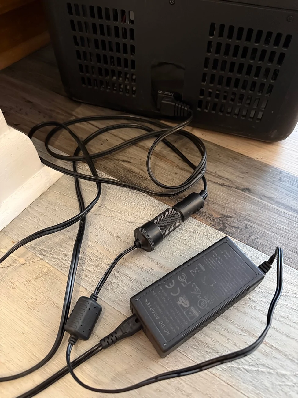

In spite of thinking I was careful, and yet again losing the contents of my setpower freezer/frig when someone moved it and didn’t check to make certain the cigarette lighter connection on the a/c power adapter was tight, I say enough is enough. And the plug easily comes loose from my Bluetti battery while on the road also. IMHO is a poor system/method of connection. Can anyone suggest a tighter more robust connection?
Any thoughts will be appreciated.

What about upgrading to the 110v plug? I run my fridge off the 110v as my first option. The outlet is low enough that it's never been an issue getting unplugged. Plus, you'll have more flexibility for other uses.
That would make things so much easier. But it is a SetPower PT45 is a 12v fridge that adapts 120 a/c down to 12v dc, so I can’t just plug it directly in 120.

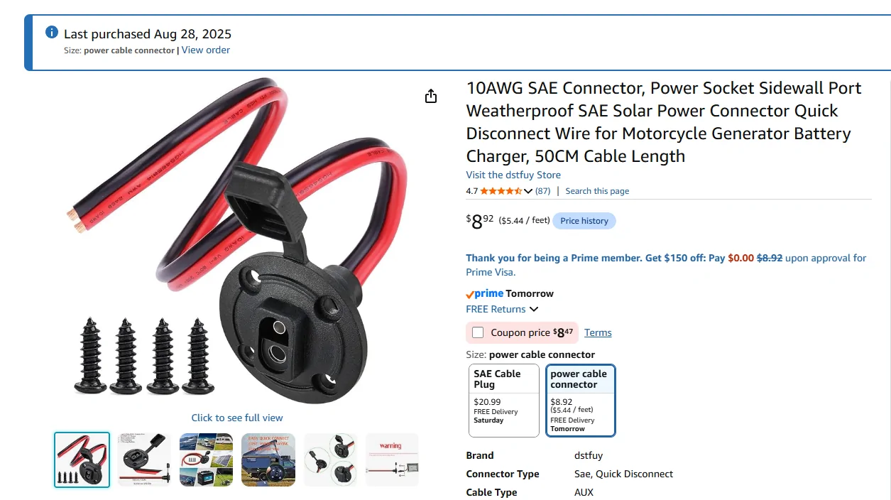

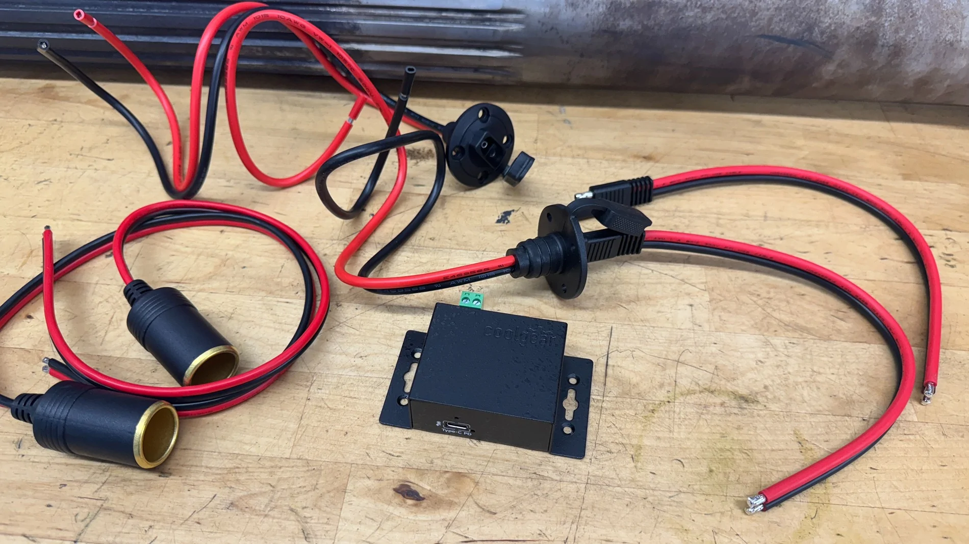

Life is great without cigarette adapters! I swapped to SAE connectors. I don't have a pic installed, but this is the mount. Andersons would have worked, but didn't need that much power.I have one mounted to each side of the cargo area (powered by a M8RIX), left the OEM rear port alone. I made various pigtails, one is a cigarette port just in case. For the fridge I cut the fridge wire, in-line fuse and SAE connector to the port.
I also hardwired (behind the M8RIX) a couple Coolgear USB-C PD power supplies (1x100W, 2x140W), one powers the Starlink, other for charging whatever. Again, was able to ditch cigarette adapters for those items.
