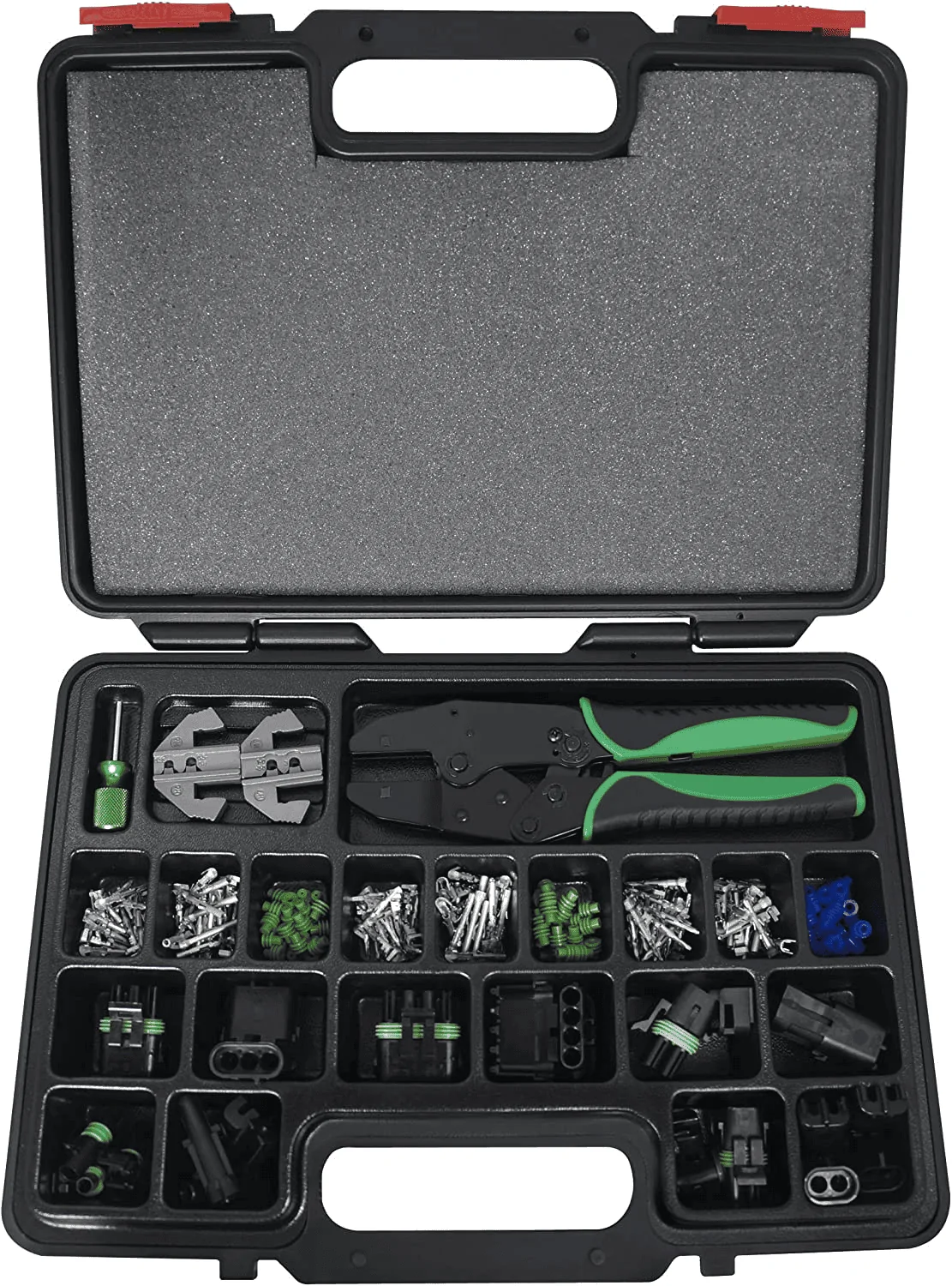

Thank you!! I had crimped and heat shrink sealed a few connections already and wish I had done this from the beginning as I absolutely will be swapping functions out over time

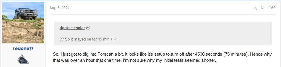

Well, this is weird. First I’ve seen this.
I shut down the truck and stayed in for a few listening to a podcast and within 30 seconds or so (didn’t open the door, which shuts the infotainment off) - a banner popped up that said +/- All Outlets Off. My 12V in the console continued to work. I didn’t check the rear.
Turned it back on and it said +/- Low Power Mode On
