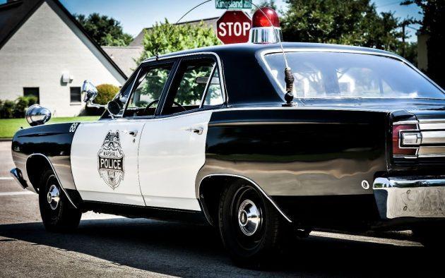

Old school 102" whip bolted to the left rear fender...
Ford Bronco CB Radio Plug and Play Options r_630x394_864cb3c7e9bd2ec0242b50d00e70ab42c6c17a68
