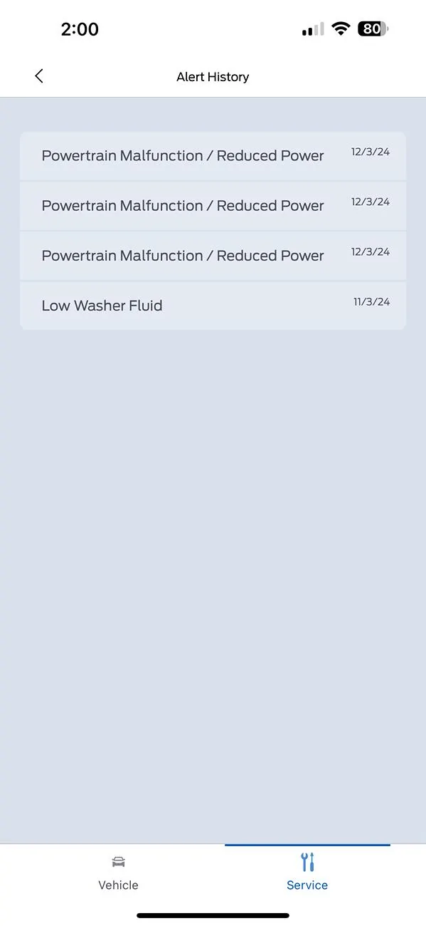

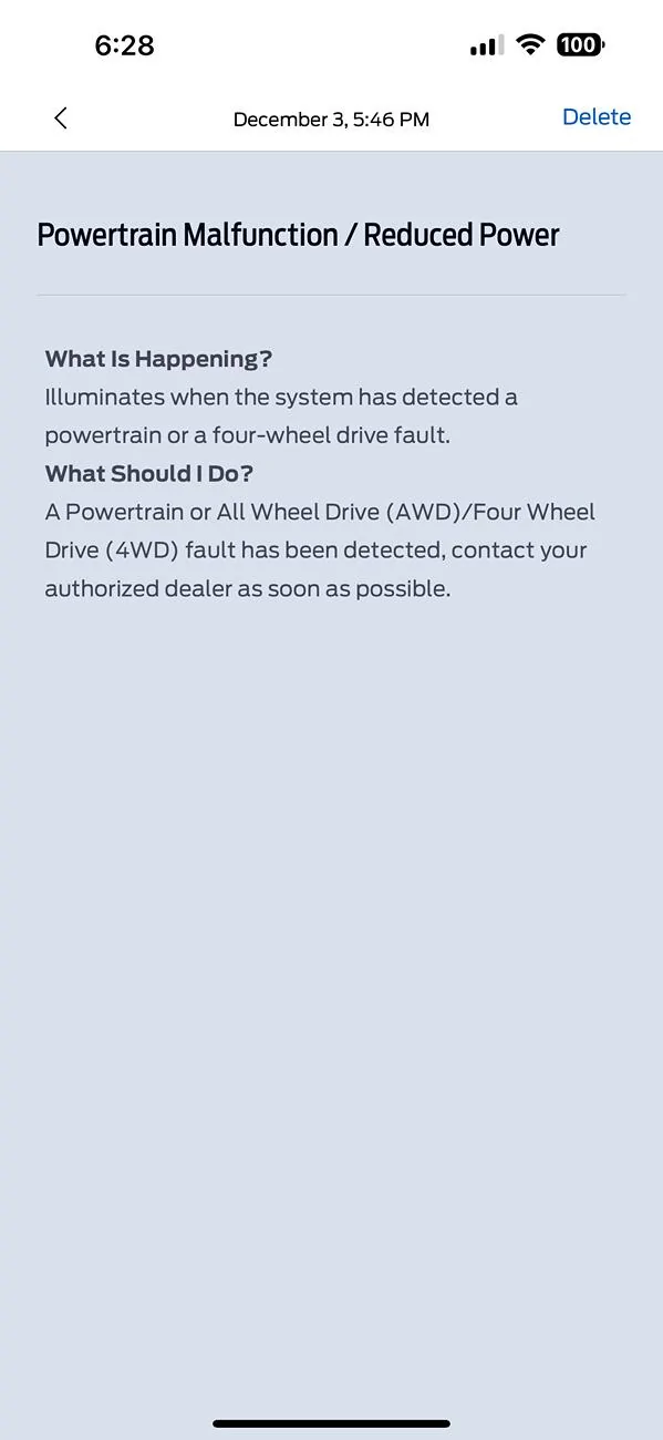

Hoping someone here may have an idea of what’s happening with my Bronco. Earlier this month when my wife was driving home from work, the screen said Powertrain Malfunction/Reduced Power. Then said shutting down to save power. The car still drove and she made it home, but I received 3 alerts of the issue through the ford pass app. It didn’t happen again for a couple weeks until this past week we were at a stop light and when it turned green, I took my foot off the break and the same errors popped up, but this time the engine completely shut off.
Around the same time the engine started a loud click when starting cold. It only lasts maybe 3 seconds, but definitely does not sound right.
I took it to the dealer this week and they were not able to reproduce it. There are no check engine lights or error codes stored either so they said they can’t do anything about it and to call when it happens again. They said they did not hear the clicking when starting even though it sat out there over night and when I picked it up it did it so - pretty annoying.
Anyways, I’m hoping someone on here might have some ideas since ford service was no help. This is my wife’s car and I don’t want her to get stranded from it.

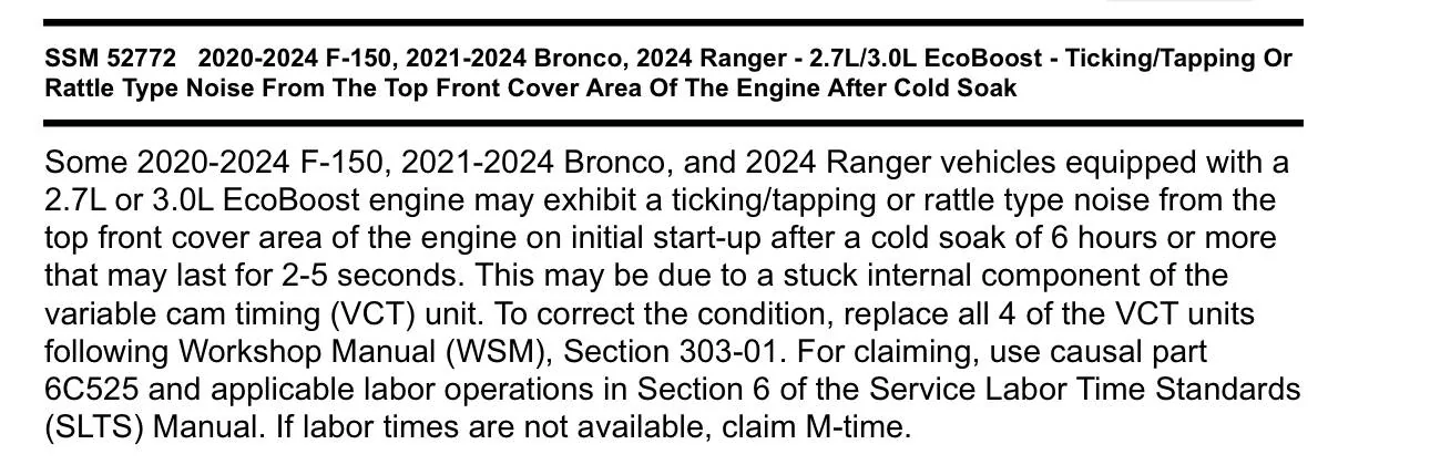

The loud rattling on cold start is cam phasers. Very common issue.

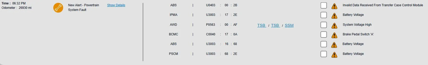

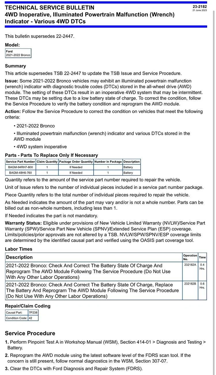

Yeah I would definitely recommend bringing it to a different dealer. There's a whole list of DTCs set on multiple days. A lot of which have to do with battery voltage and there's also a TSB related to one of the codes. So I'm guessing they just didn't feel like trying to diagnose it.

I’m interested in what Ducati finds in the VHR.
I’ve read and seen videos of the cam phaser knock but not with the with the other issues you reported.
I’m genuinely interested to see where this ends up.
Edit- well there is the report. Could this be the regulator or alternator?
Looks like they have some test to perform to find the fault.

I think it’s just 2 separate issues. Phaser rattle very very rarely causes any check engine light or driveability issue.
