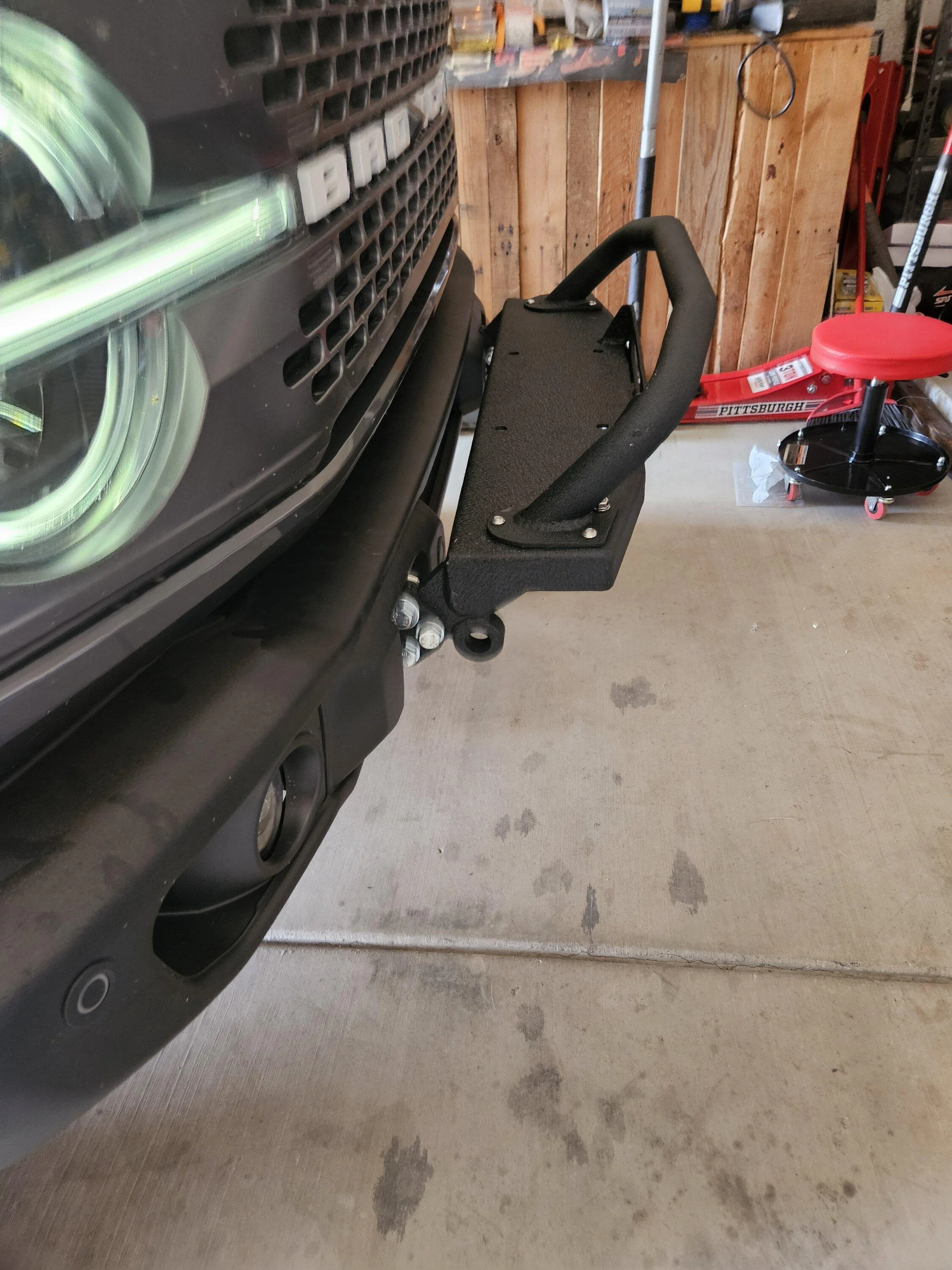

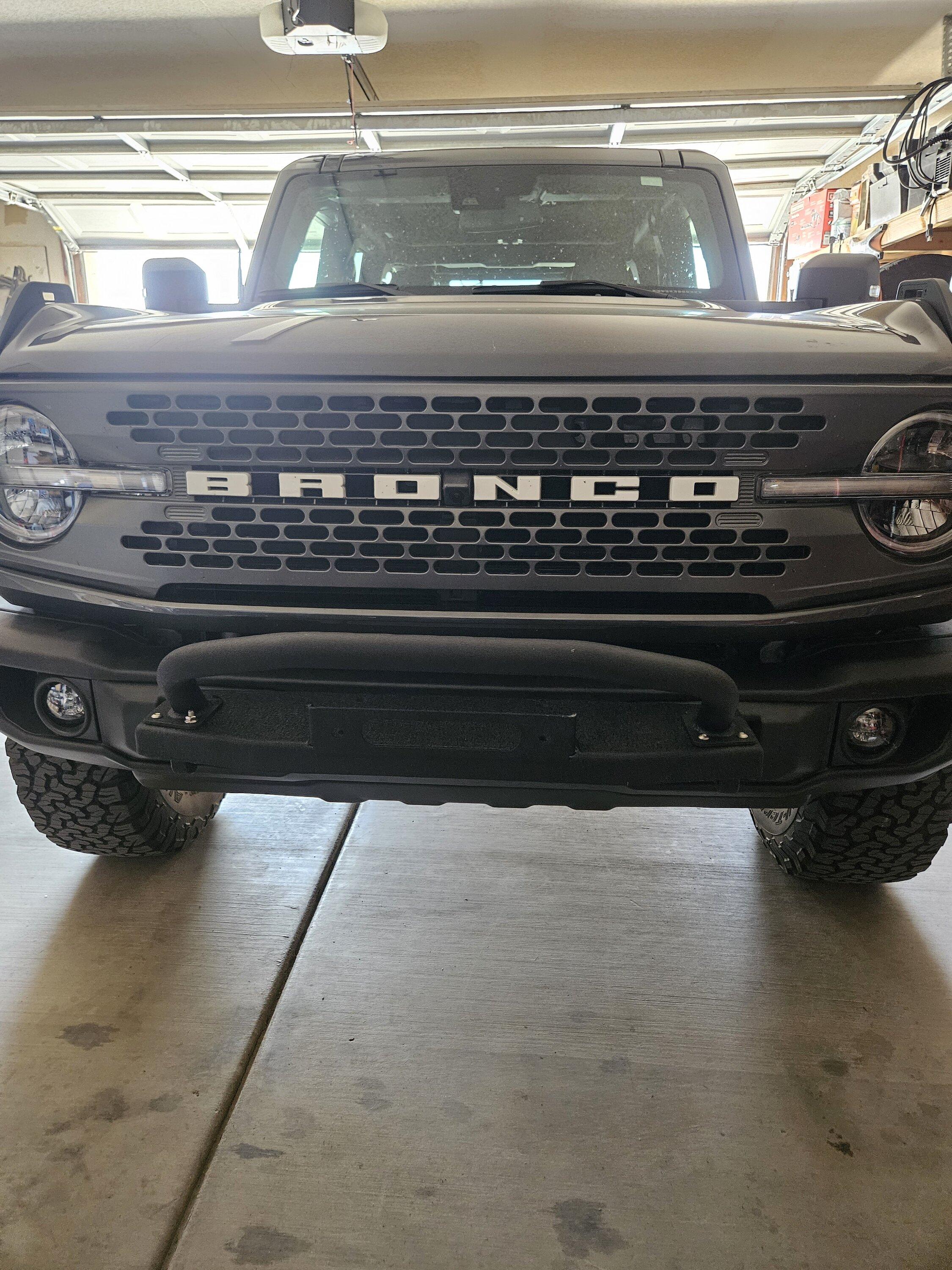

Well I went the cheap route with ebay one. Fit great, sits lower than the RC High Mount. Of course partially blocks the camera and the sensors. Will do some realtor extended wiring and fab up some relocations under the tray

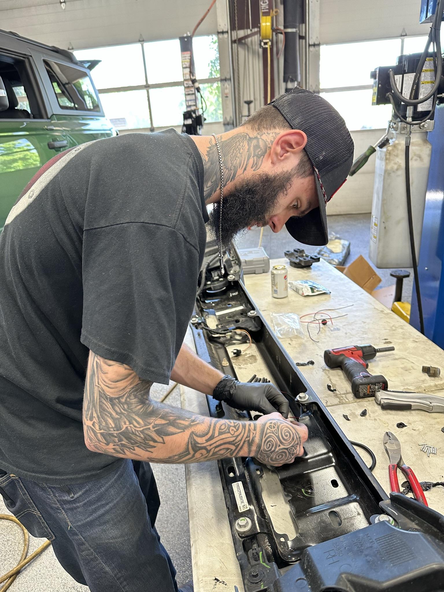

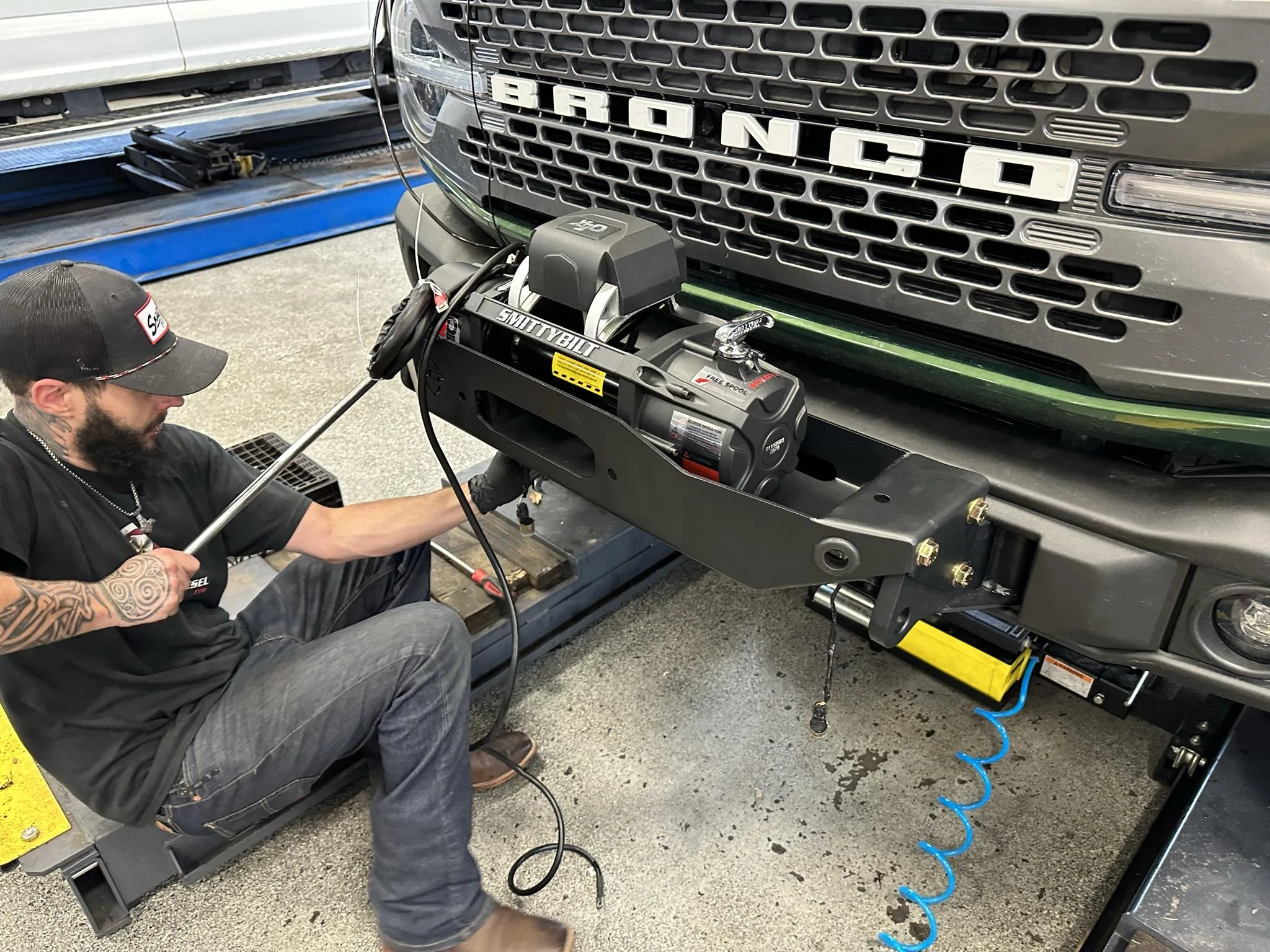

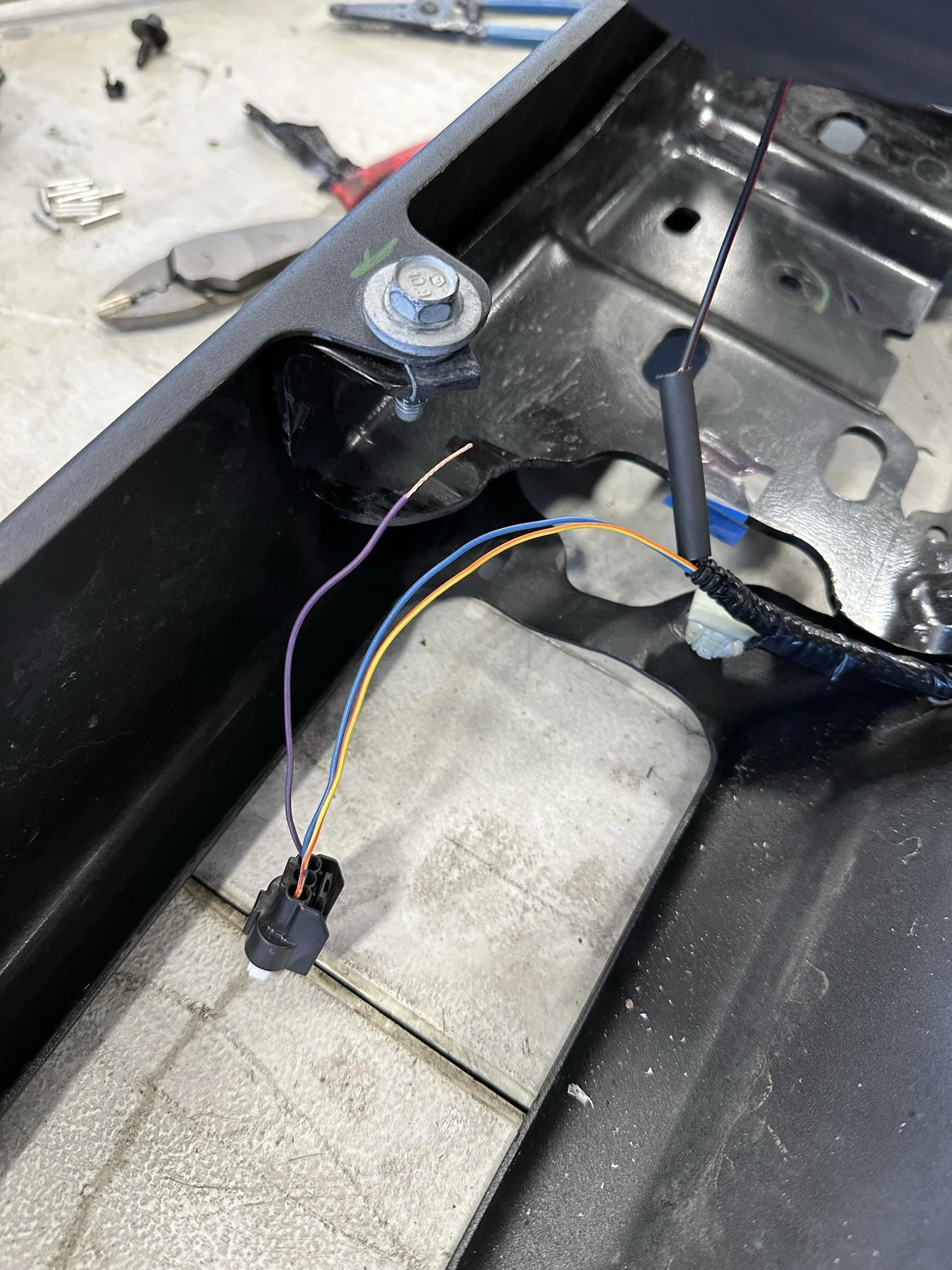

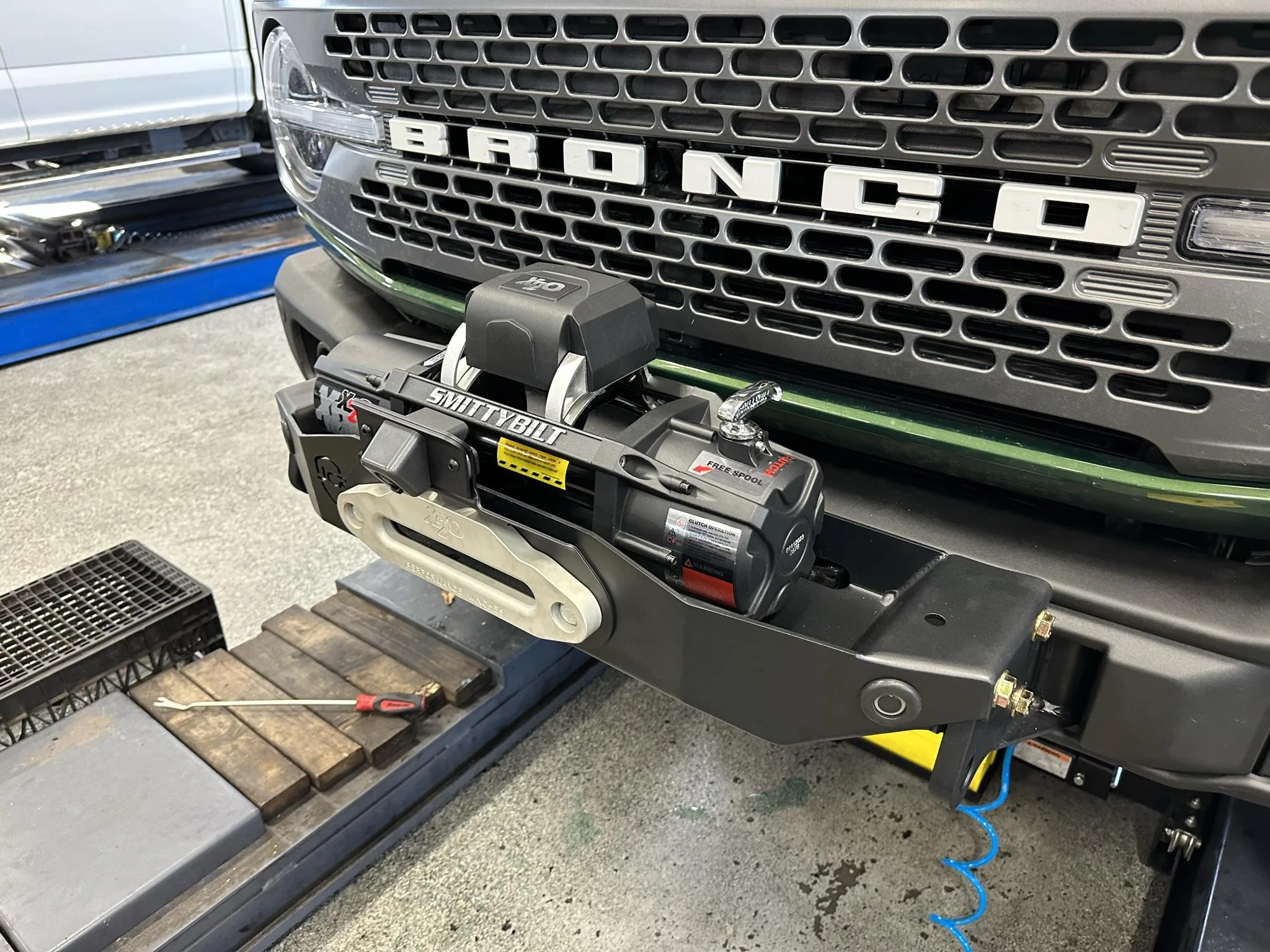

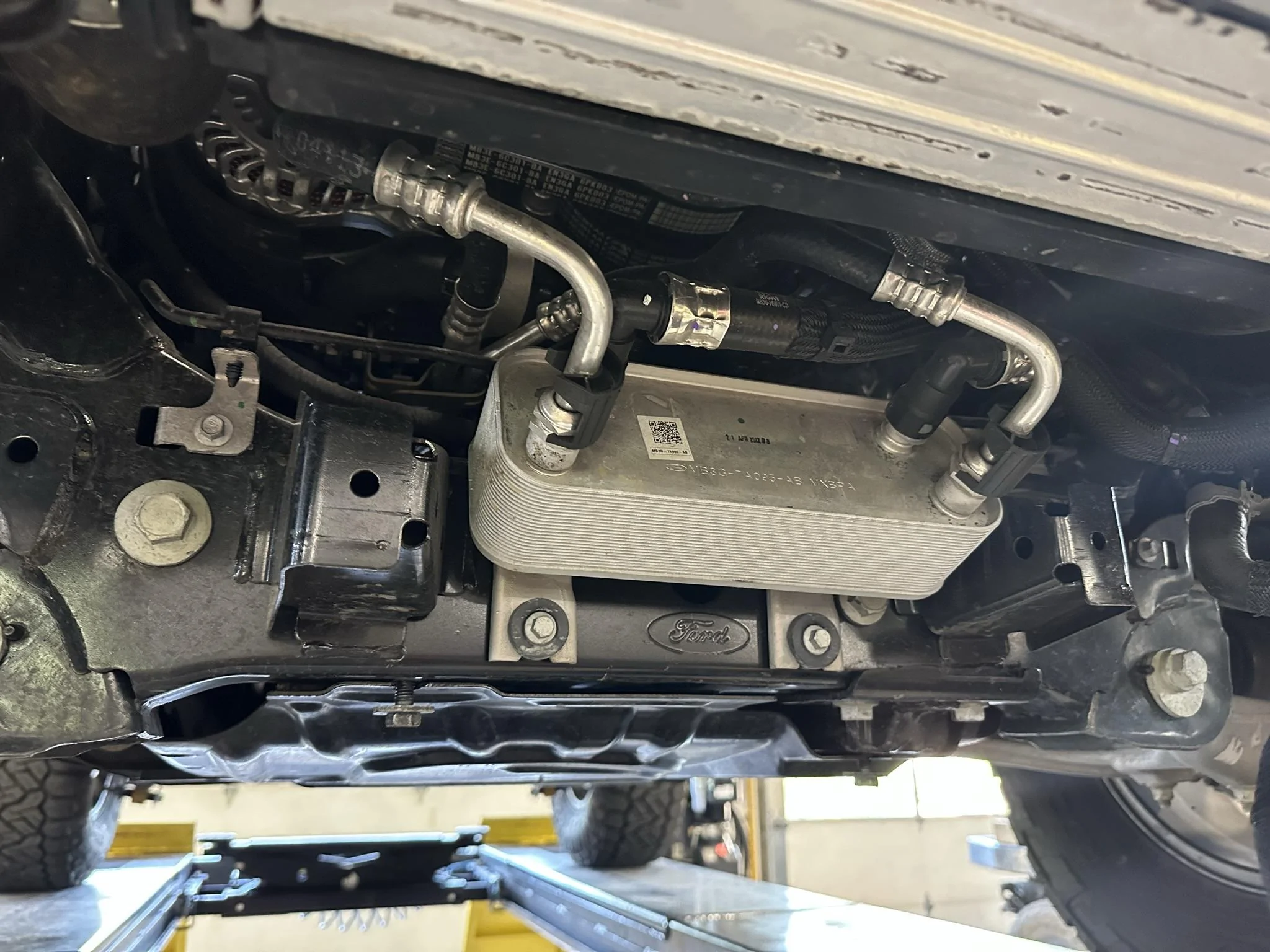

Just installed my JCR Offroad winch plate for the CAPABLE bumper. Went well and nearly similar to what JCR has in their install video. CAUTION, however. Note that if you have the CAPABLE bumper that the electrical portion is incorrect from this video where it shows you need to pull the wiring harness out and cut back the loom to get some slack out enough to extend to the new mounting locations. We had to cut and splice into the three-wire parking/proximity sensor wiring (3-wire) to extend it about 9-inches to get comfortably to the winch plate mounting locations. ALso, you can see why the 2.7 will not allow [easily] for a hidden winch option due to the cooler unit that is in the way and needs relocating.
Job took 4 hours with assistance from my son (mechanic and we used his shop).

So far it does block the camera a bit. Gotta fab some tabs for the prox sensors. But been looking at ebay full bumpers now with all those features for like $380
