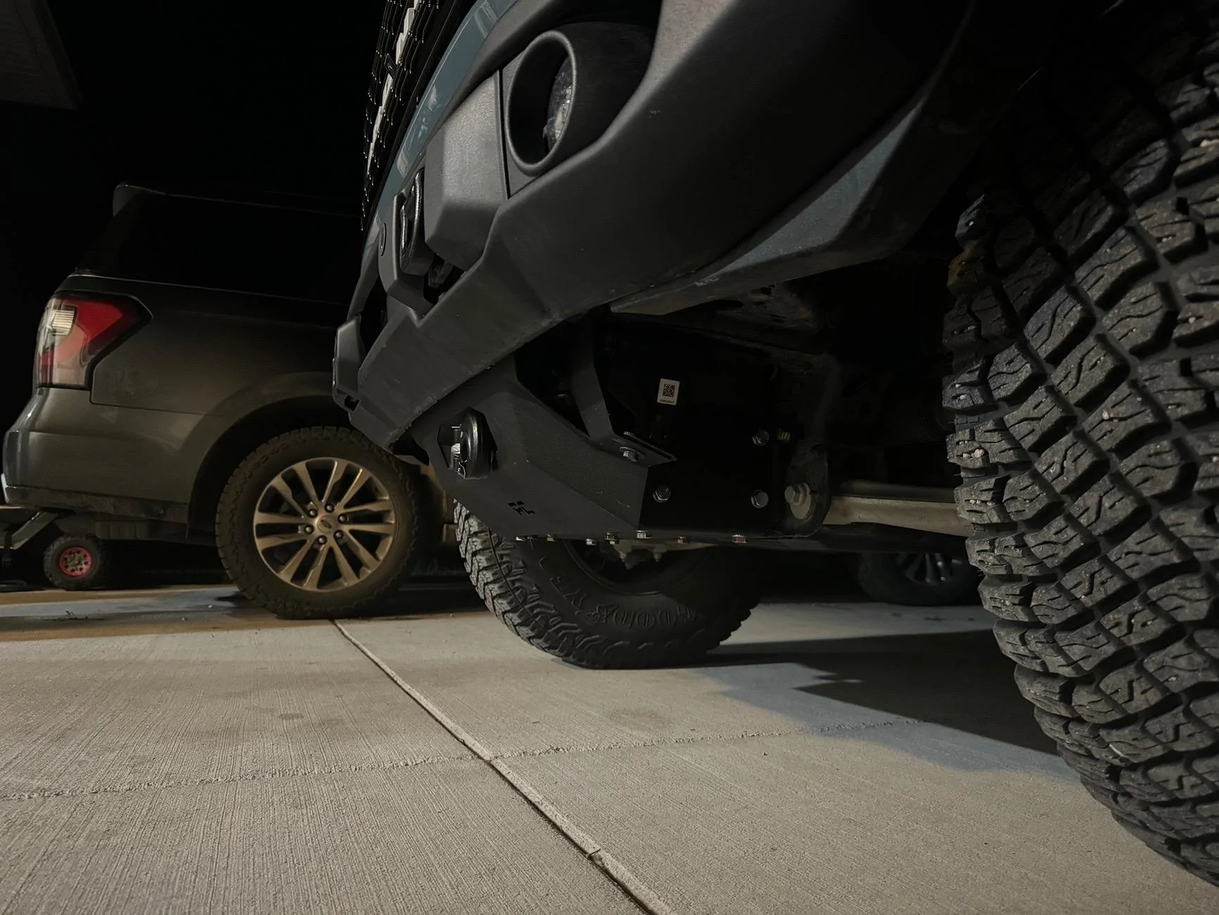

Ford Bronco Hidden winch and capable bumper IMG_0044

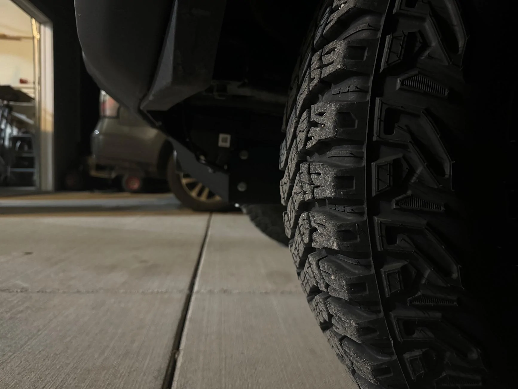

Ford Bronco Hidden winch and capable bumper IMG_1667

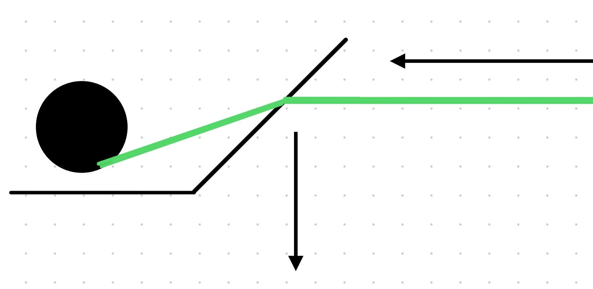

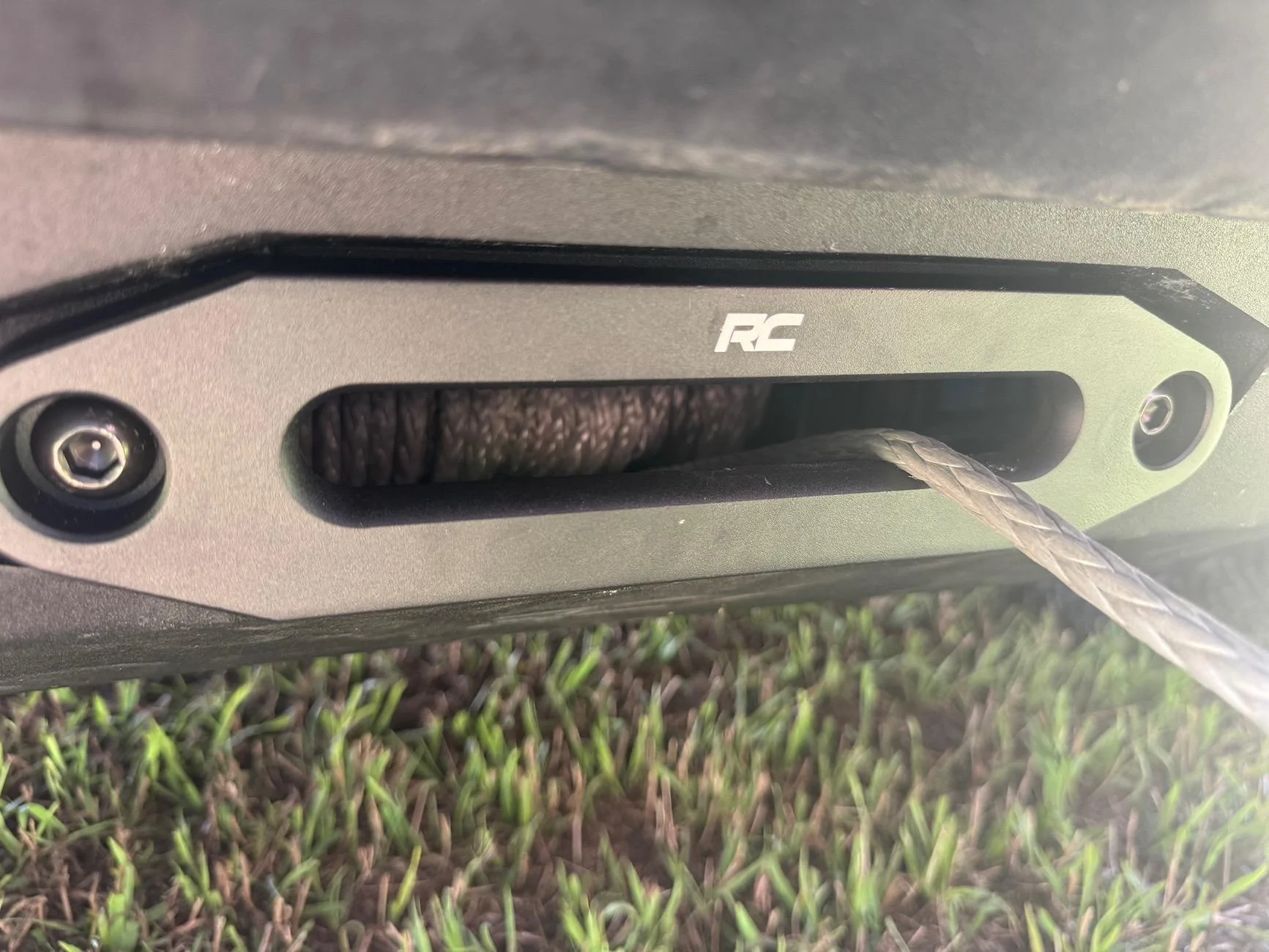

Am i overthinking things here? This does not seem ideal, it seems like there always going to be downward force on that fairlead. also seems like i cant top feed the winch. waiting to hear back from the manufacture on that
What about just reversing the feed?
Thats what i was thinking of doing, but some manufactures dont want you to do that. Waiting to hear back superwinch

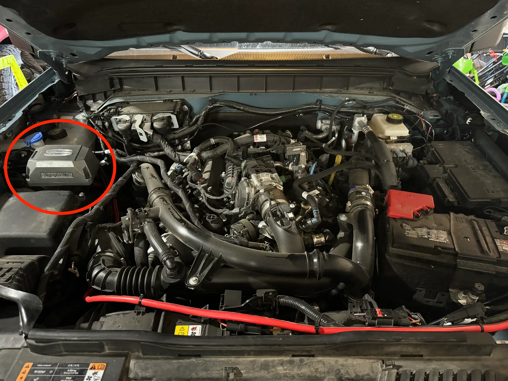

With the Superwinch I did have to relocate the Controller. Superwinch makes a mount that relocates it up in the engine bay. So far it's held up.

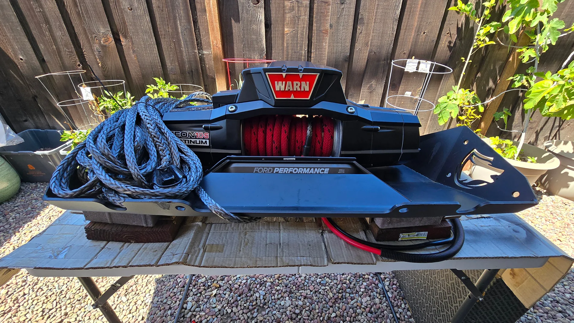

Going to install my Lobo + Warn Zeon Platinum this week!! Trying to decide if I need a cut off switch.
Ford Bronco Hidden winch and capable bumper 20260709_150227
