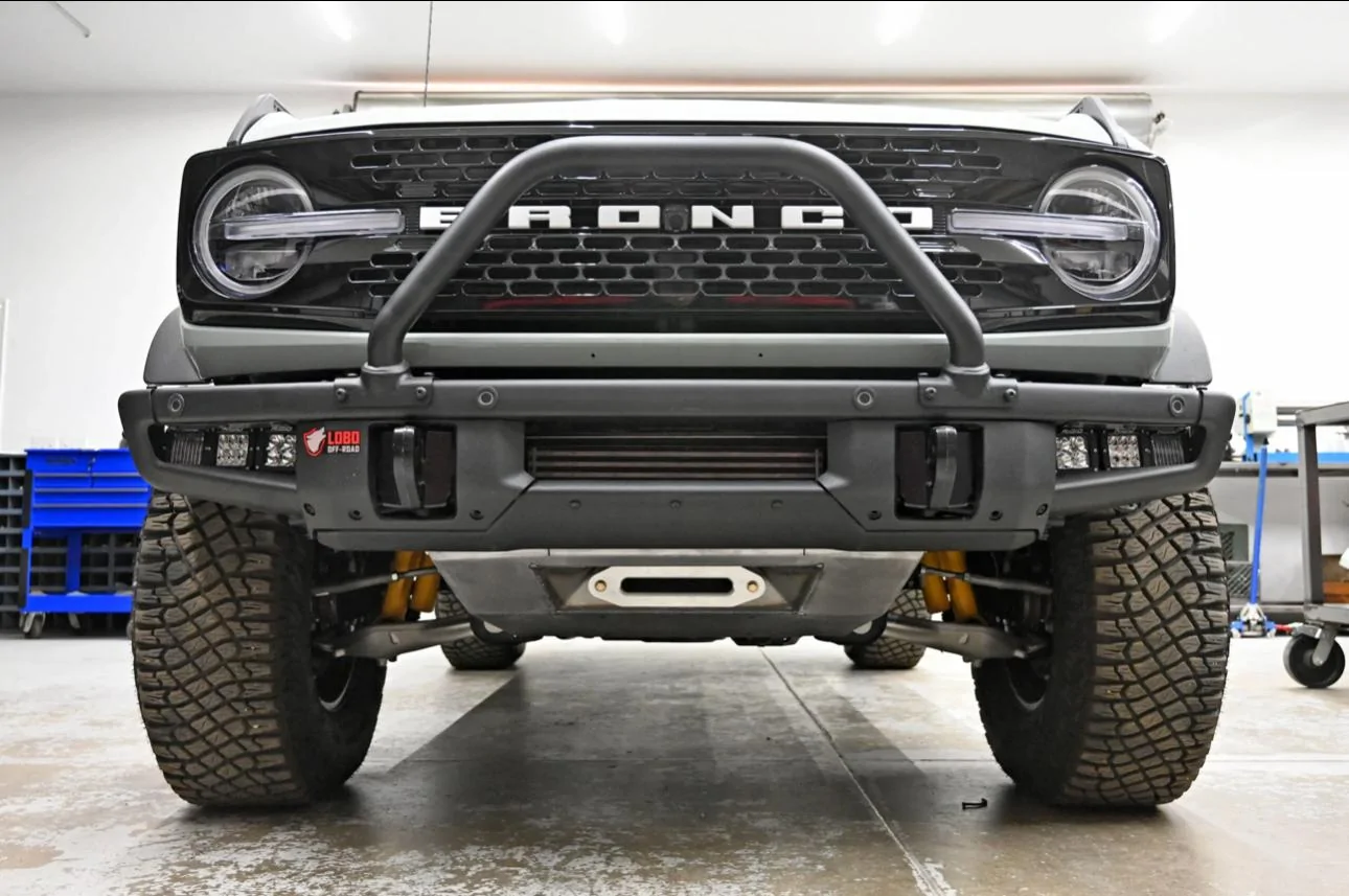

Do you have a side profile view? How much did this effect the approach angle? I'm trying to decide whether to go this route or try and buy a used modular bumper + Rough Country High Winch Mount. I'd like to keep the winch as high as possible.
Have you looked into lobo hidden winch? I was short on money with everything else I had to buy for this trip, but if I wasn’t on a deadline I would have bought that one for sure. It’s a US company that makes it all I house. Solid design and has a better approach angle than
Ford Bronco Hidden winch and capable bumper IMG_1594
the factory skid plate.

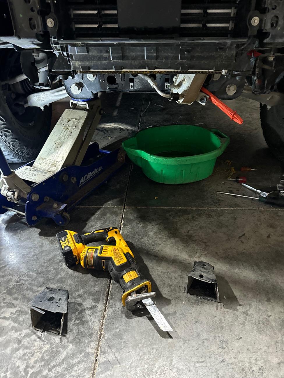

You didn't have to cut the so called "frame extension" boxes off? Every video I have seen says those boxes have to be cut off and the welds ground down...!?
I should have said cut off anything extra lol
I followed the instructions and didn’t have any issues. It’s odd that RC says it won’t fit and just wanted to make sure i wasn’t missing something
oh. gotcha... I was hoping something had changed and those boxes didnt have to be cut off..
I was worried about it at first, but the hidden winch looks so clean and I don’t have to move the camera, parking sensors, or crash avoidance system.
totally worth it
