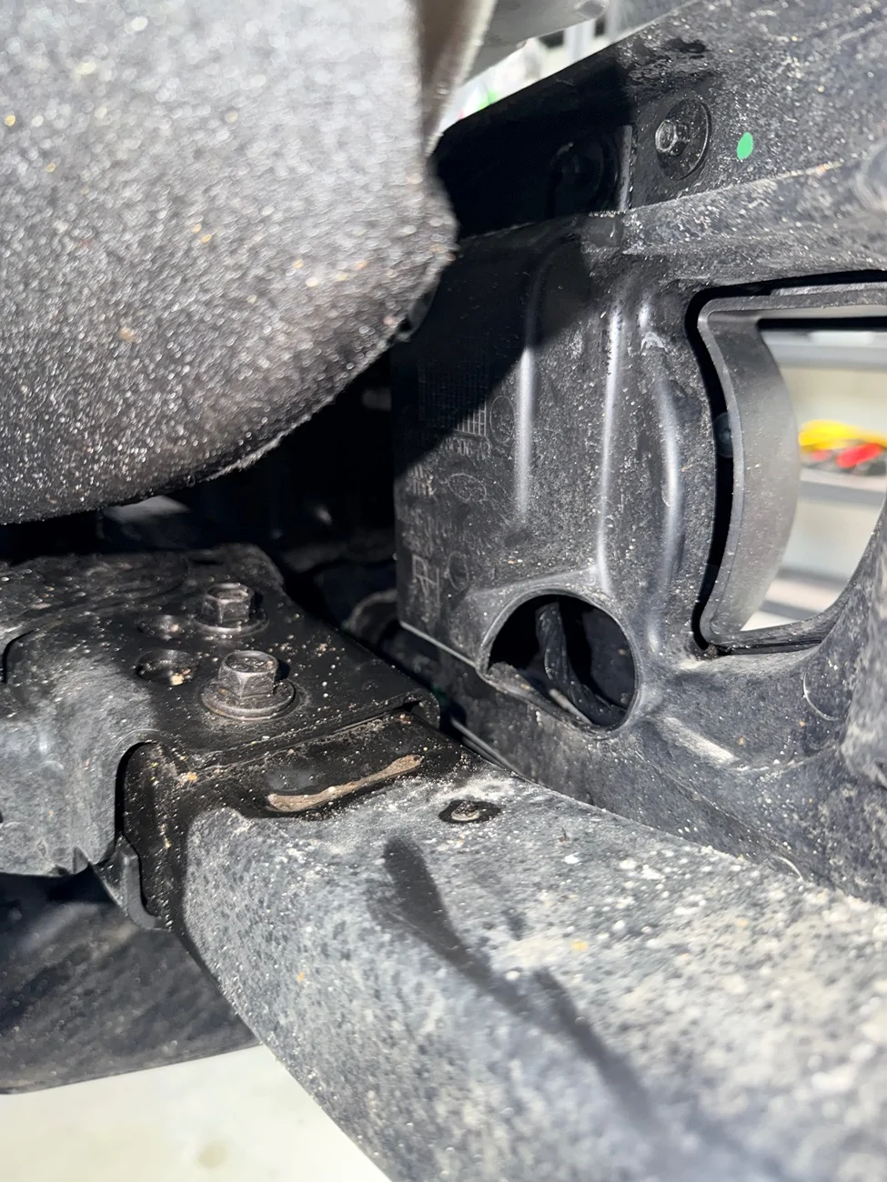

can’t believe i forgot to clarify! fog lights
Ford Bronco capable bumper - fog light question IMG_0565
this is the view from behind

Yep, like Dan-o said, you have to remove entire bumper to access fog lights from behind. It’s a pain, but not overly difficult. Hardest part for me was unclipping the electrical harness on the driver side wheel well

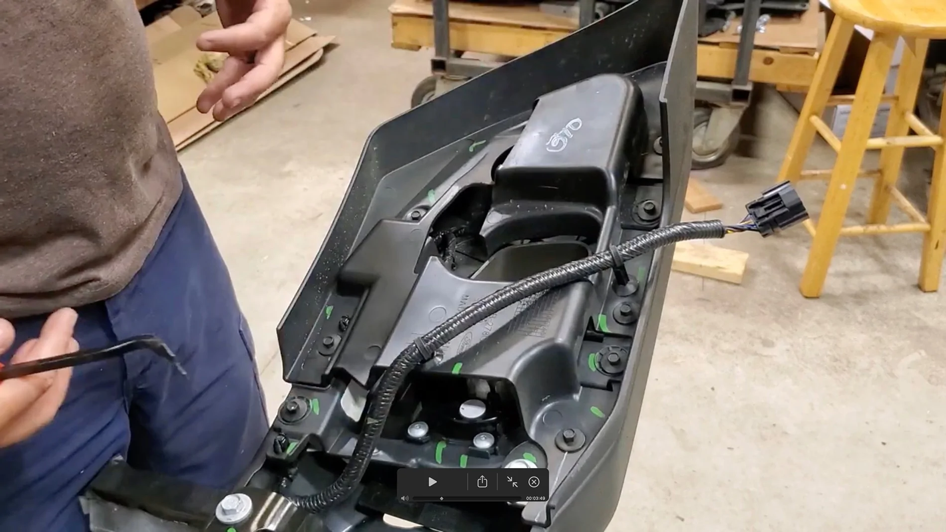

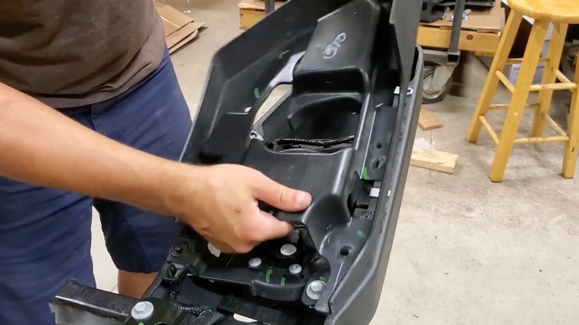

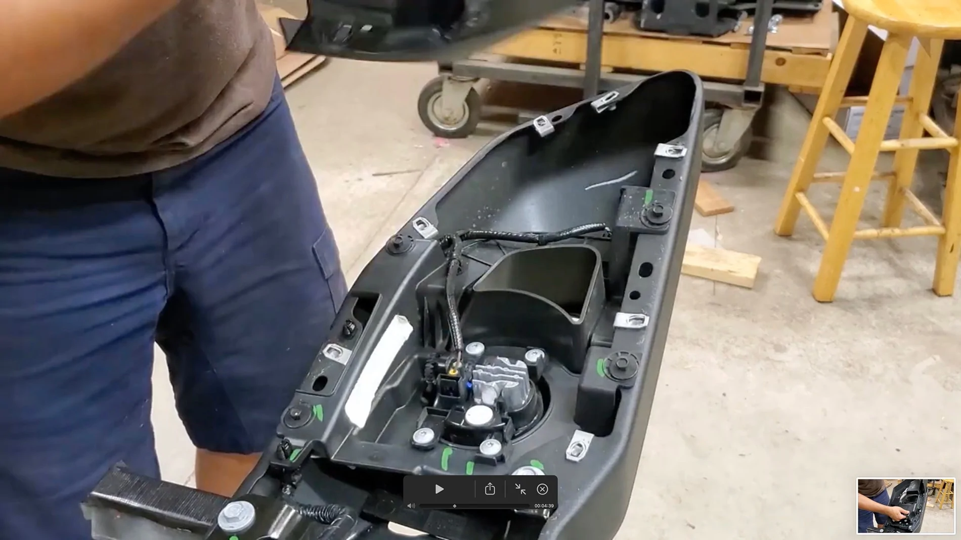

Someone posted a video a while back. I'm changing my foglights, so I did some screen shots.
It's possible to remove the foglights without removing the bumper, just not easy. The cover is also the trim on the bumper. One large piece of plastic.
👍🏼Great pics of the process👍🏼
that was my fear, super helpful! thank you everyone!
