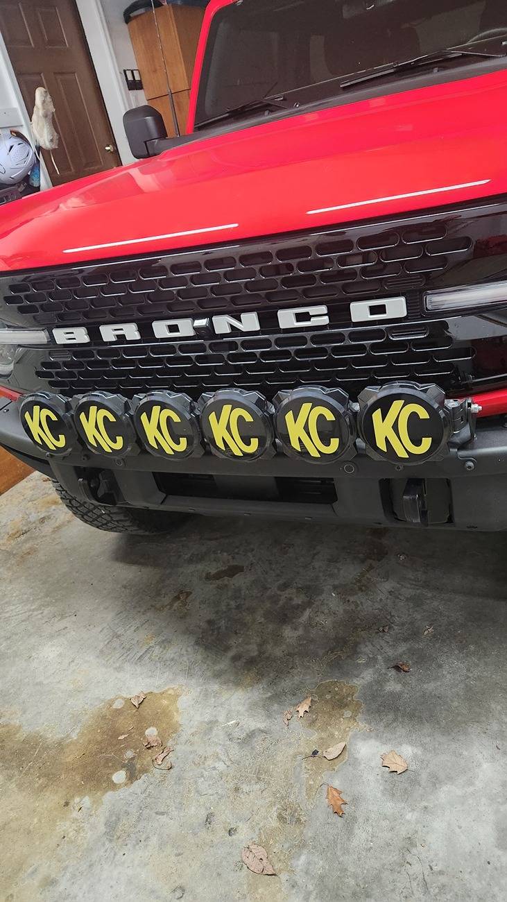

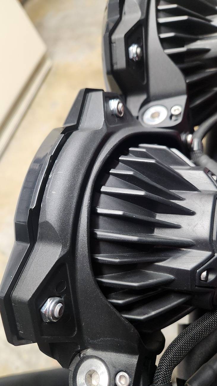

Ok guys just got a used wildtrak 2 door and want to change the color of the K.C. on the aftermarket lights . I can not get these damm covers off and I dont want to break them . I've tried prying and they yeild some on the sides but the top seems like it is screwed to the light or something.... anyone have any ideas???

Just like with any cover, pull it off. Original owner likely never removed the covers (only for show). You can try adding water as a lubricant. When owners never remove the covers to clean, than the slightest bit of grit and soap residue acts like a bonding agent. The set bolt on the backside in your pictures is for the lens ring and to open/service the lights.

Hair dryer or heat gun on low. Carefully

They pry off from the top & bottom - 12 & 6 o’clock. Just use your thumbs at 12&6 and push forward from the rear. It takes some force but you will get it!

Pull from the very top. There is a locking tab there that seems to be the easiest one to detach, and pull out-n-down.
You can also apply slight pressure to the center to help as you pull that top tab out.
