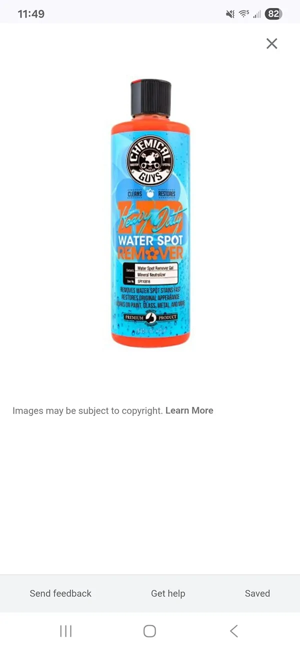

Ford Bronco Cannot get this off. Any suggestions welcomed 1000006315
This is what I use. With an applicator.put it on amd buff it off. You can pick it up at Walmart.
    I'm going to look for that great tip!!!
