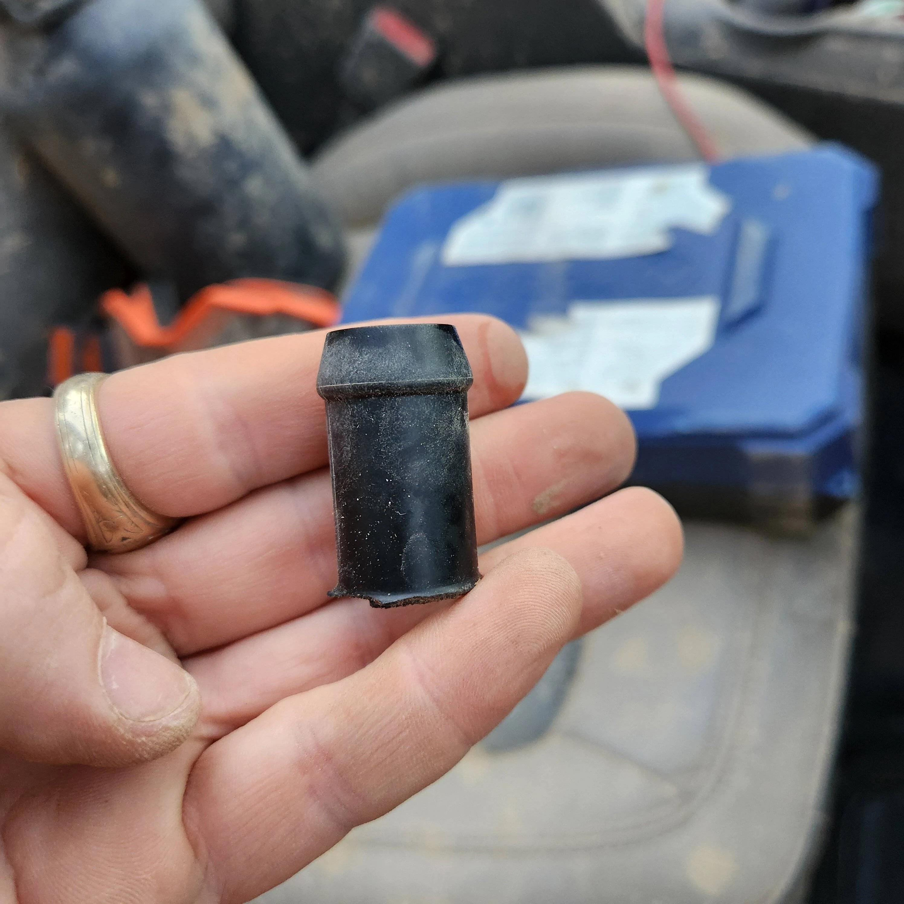

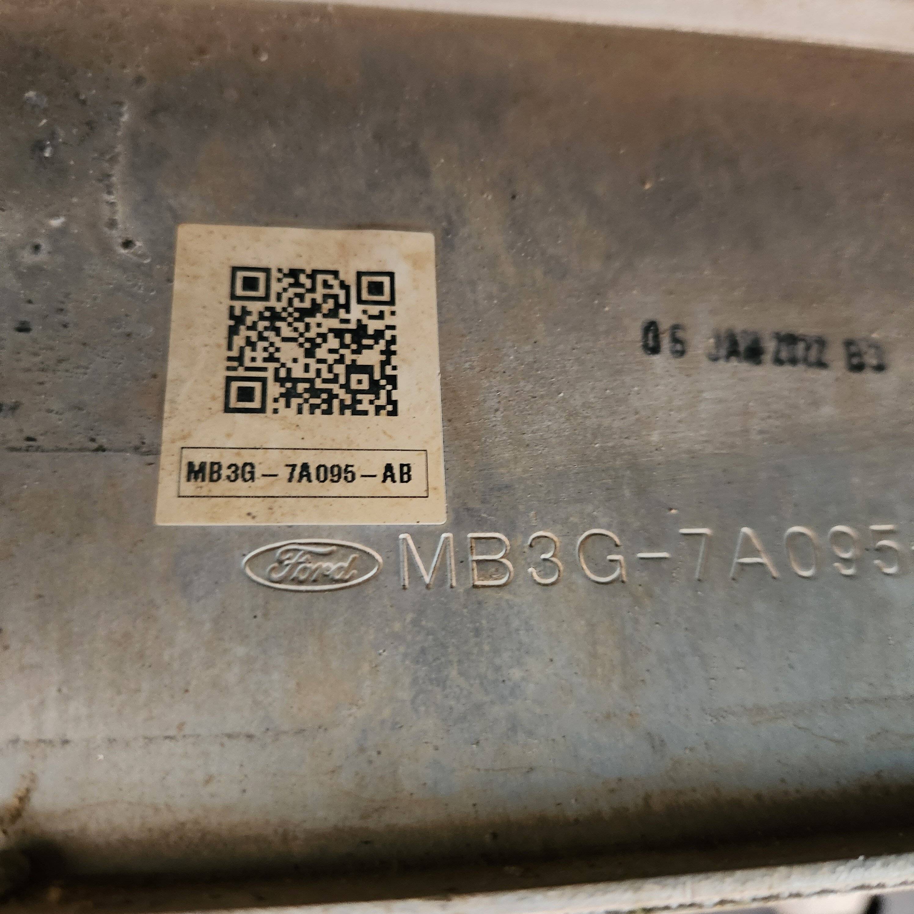

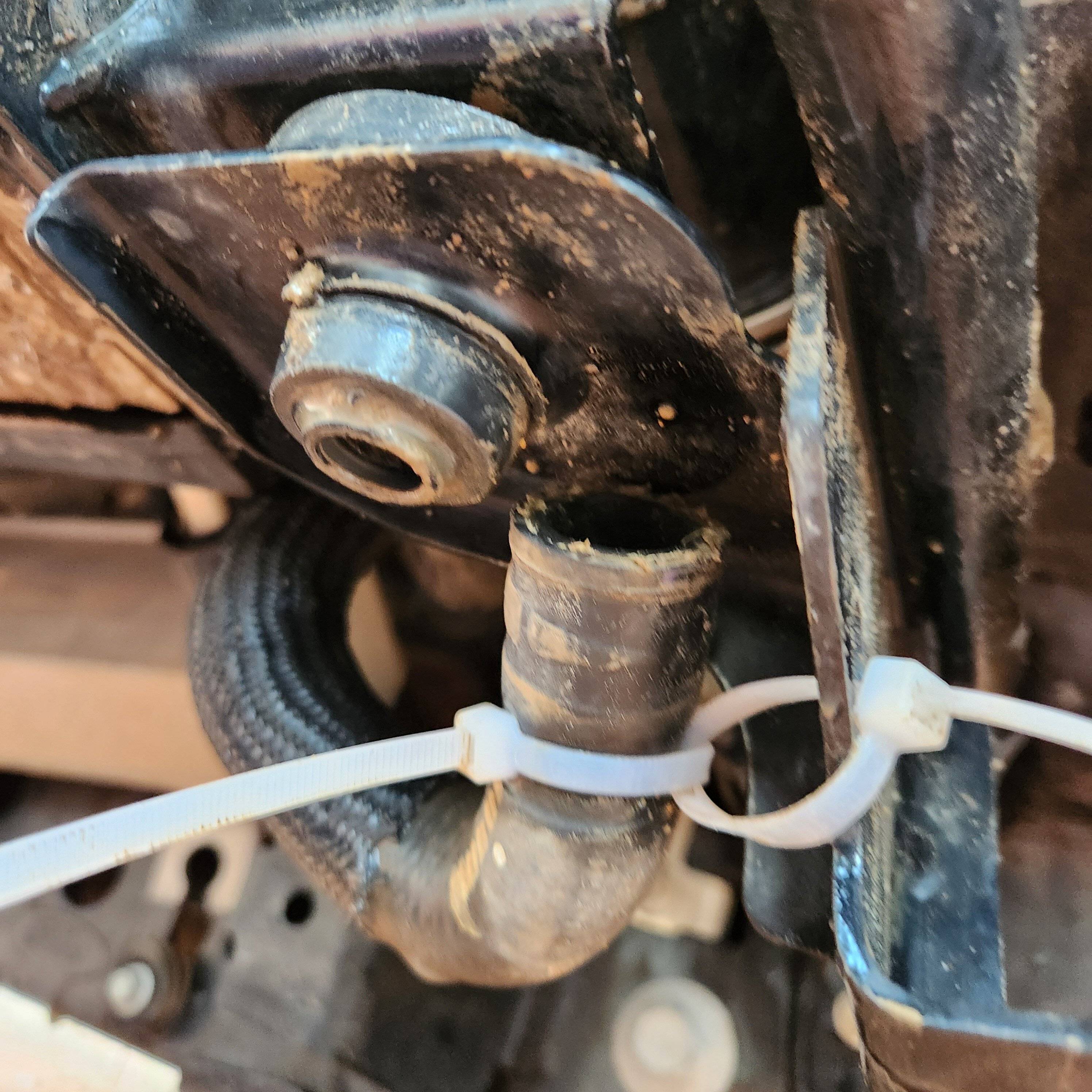

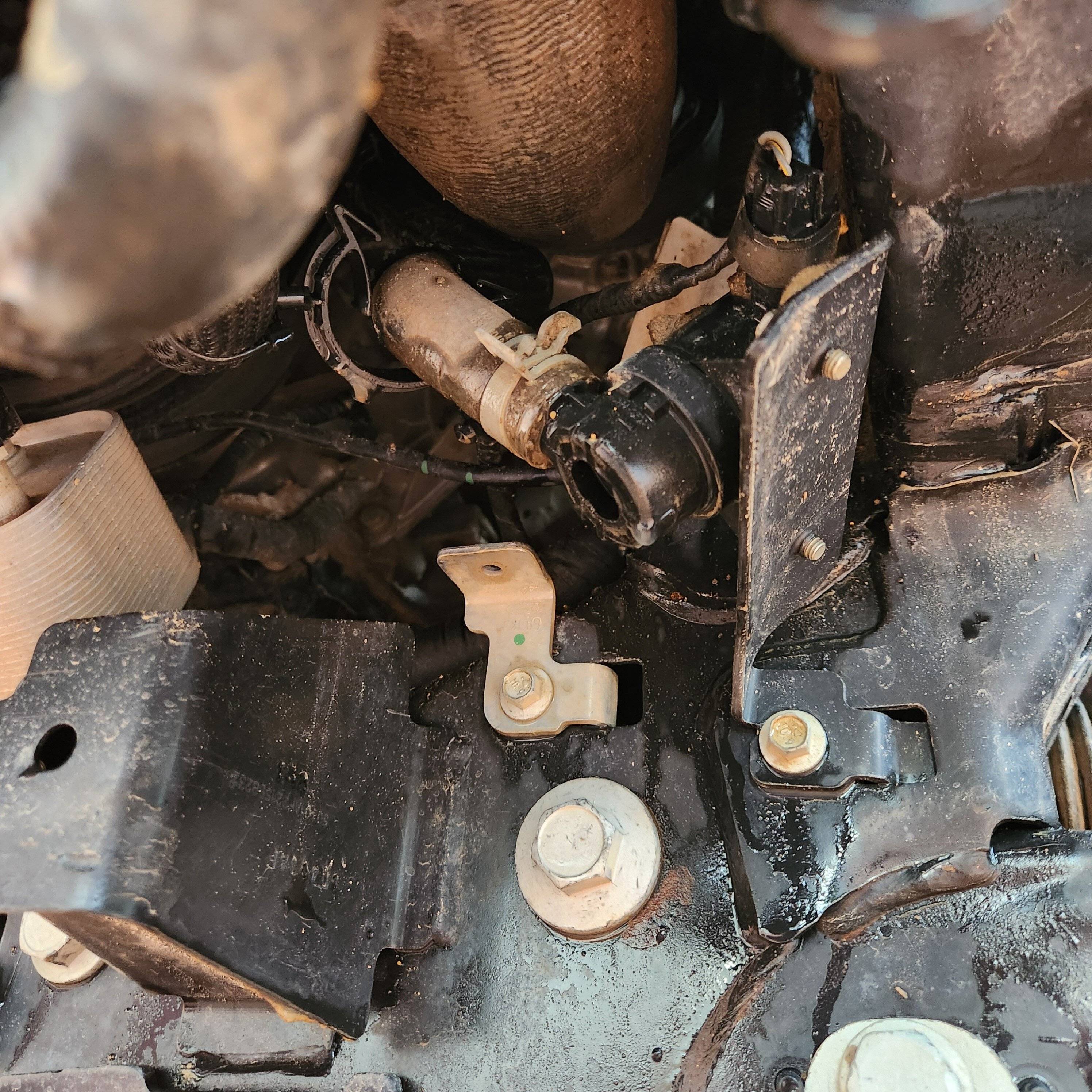

Figured I'd jump on here while waiting for the tow truck. I was bashing about today at an off road park. Got too excited and knocked my oil cooler loose, broken a hose at the barb. Hopefully part availability isn't atrocious. This is the oil cooler right?

I'm looking for that valve but don't see any markings on it. Anyone have a link to an IPB?
Transmission fluid heater coolant control valve.
I show 23 available at one PDC. May take a few days to get, but shouldn’t be an issue.
MB3Z-18495-B

@Ducati1098 Does this " Transmission fluid heater coolant control valve", just turn on and off coolant flow? Could you just bypass the valve as a trail fix?
