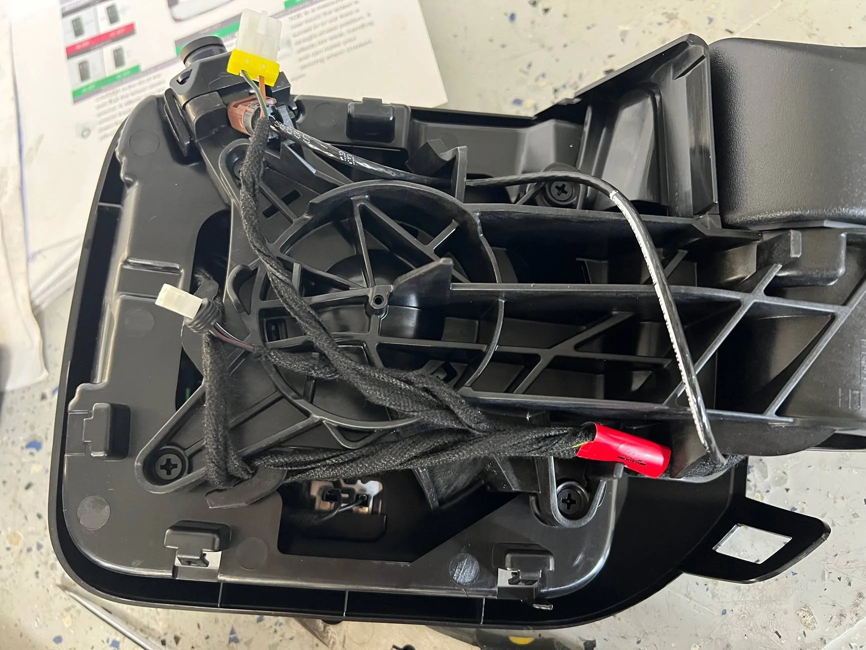

Hi everyone.
I met a Uhaul truck on a tight road and we bonked mirrors and the truck won. The driver side mirror was lost and the mirror housing was dangling from my Bronco. I was able to put the housing back together and the spotlight actually works but I'm getting error messages that the Blind Spot Detection with Cross Traffic is not working. Obviously it's not working because there is no mirror and the cord to the mirror was cut. The turn signal assembly on the side was also cracked on impact. I attached a few photos. Do I need a whole new mirror assembly? Or are there other options? I didn't think this was a big deal until I went online and saw the entire mirror assembly with all these options is over $1,000. This is for a 2023 Wildtrak so the mirror was heated, had the downward spotlight, the signal light, and had the detection signals. Are there cheaper options out there?
Thank you advance for any insight you can share.

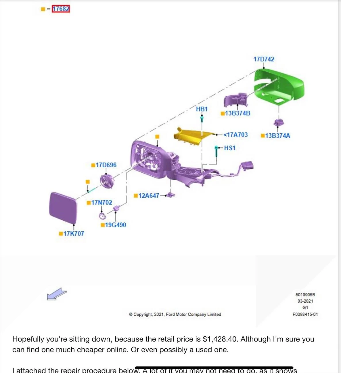

Been there done that. Broke mine at the joint where the main mirror body pivots inward when I lowered it down on a jack handle. Taped it together. After a while, I sucked it up and replaced the entire assembly for about $900. Here is some info a very helpful forum member sent me for my 22 bdsquiatch Lux. I don’t think individual parts are available.
Good luck.
M2DZ-17683-D is the part number.
It comes with everything with a yellow square next to it in the diagram below:

As previously posted- Most of the parts are available separately, here's the list for the M2DZ-17683-D Part Number contended provided.
Don't use this list to order the actual parts for yours, see my previous post about using your vin number- even then fitment isn't guaranteed. I've ordered several part using my vin that haven't been correct, best advice I can offer is to use the free pick up at your dealer, then make sure it is correct prior to leaving the dealership.

Ignore all the pieces ! You need an assembly--only way to get the housing that bolts to the vehicle. If you don`t want to spend the money for new,go to the wrecking yard and get used. Also Ebay / FB Marketplace / Craigslist etc.

for reference, the first item on the list is $25.61 and the whole assembly is $1,053.00
