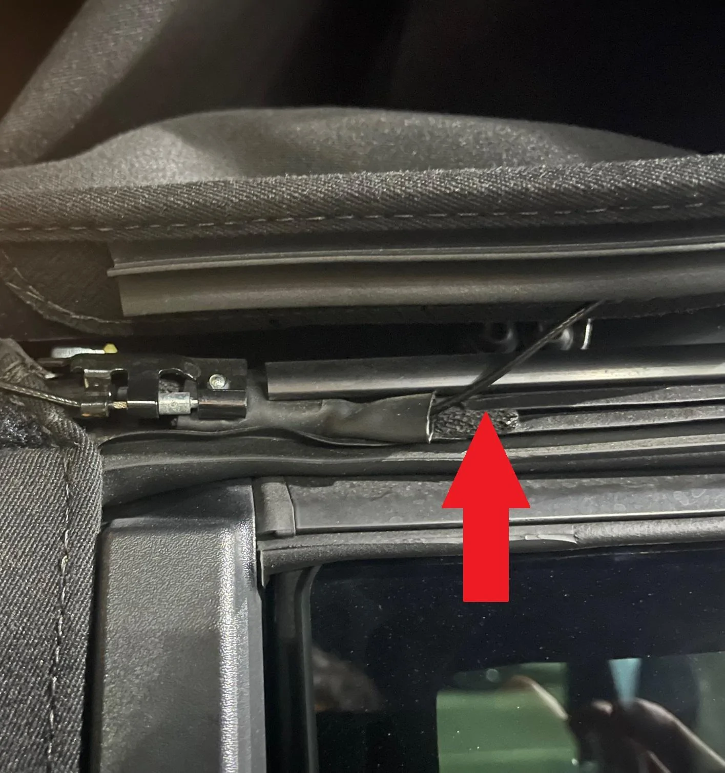

Have a quick look at the tension cable on your soft top... I noticed this issue on mine a while back. If you notice, the tension cable has come out of it's holder on one side. I put it back into place and haven't had an issue again:

When I put the top back to position 1, I noticed it for the first time. It was definitely looser. I was able to feed it back into place when the top was in position 1, and it has stayed put ever since. I did notice that they bracket holding it was slightly bent as well, from the factory, compared to the other side.
Definitely worth looking to see if it's part of the issue.

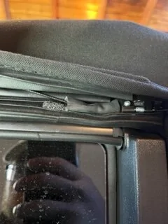

Just went out to look. It doesnt seem to be a similar issue with that holding - but it definitely seems like a tension issue. I just took the below picture showing how much upward play the tension cable gets as it is running forward. My sense is that the loose cable is not holding it down, so when the car gets going at speed, the whipping/whistling I hear is that air/wind getting underneath. Doesnt seem to be anywhere near the same play on the passenger side.
I've only take the top fully back beyond position 1, once (downsides of living in the Northeast). I did find latching it back fully in position 2 was very difficult to catch and latching it back into position 1 was difficult as well. Took more force and a few attempts than I thought it should, but those issues may not be related.
