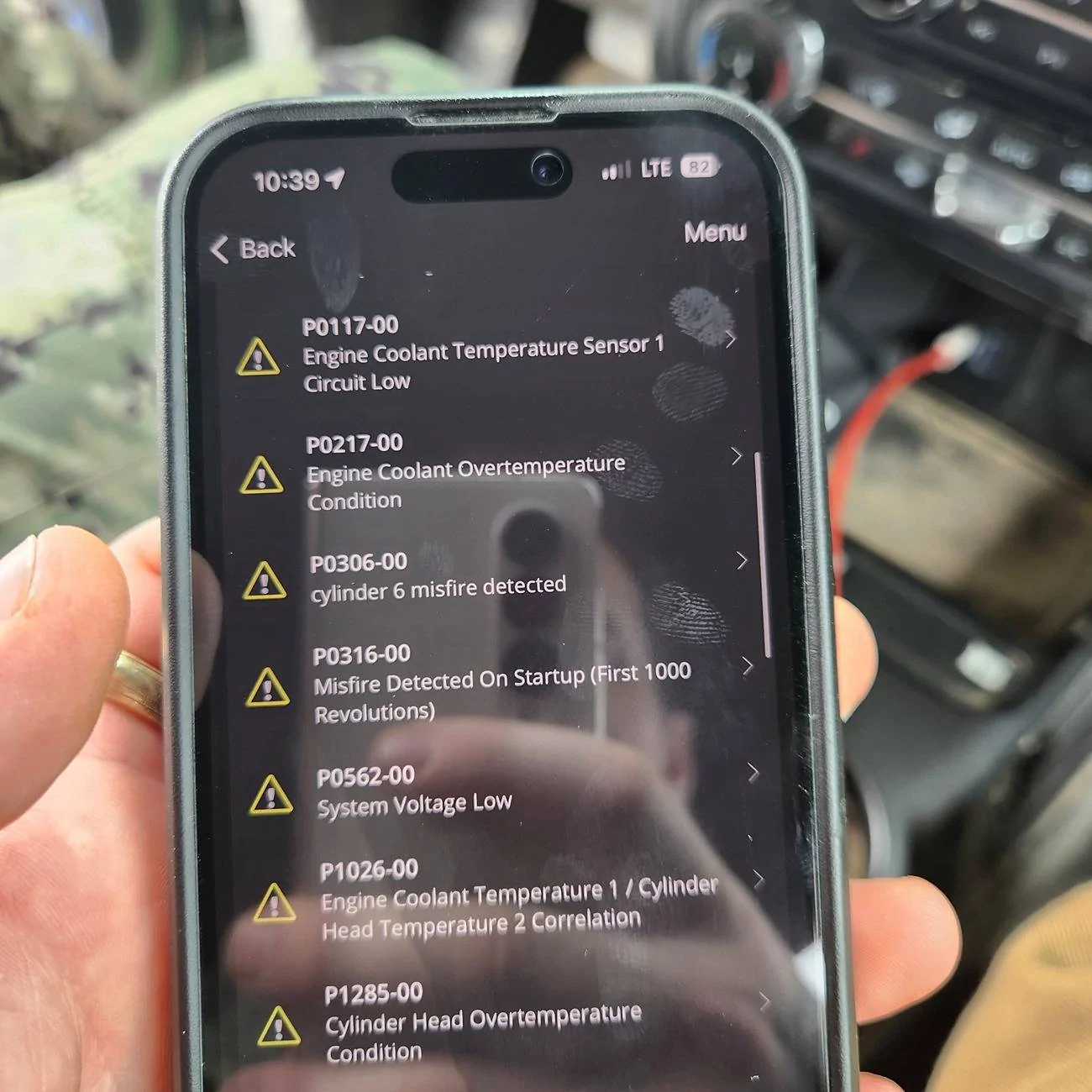

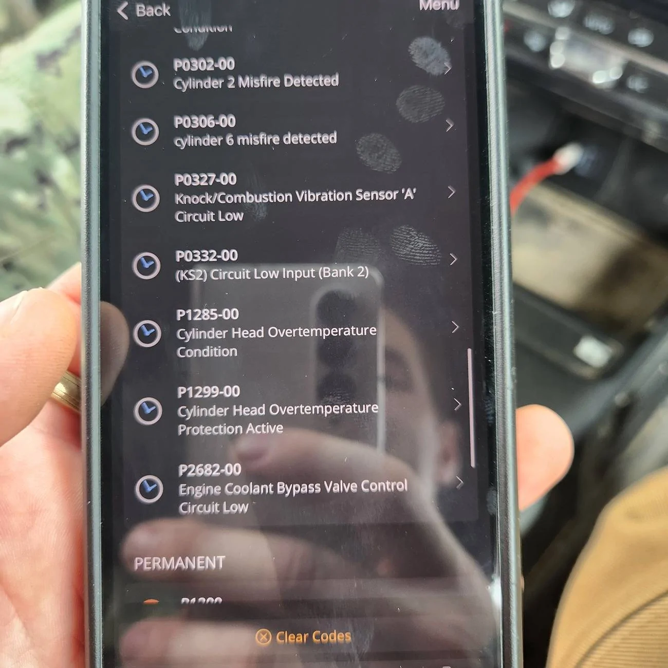

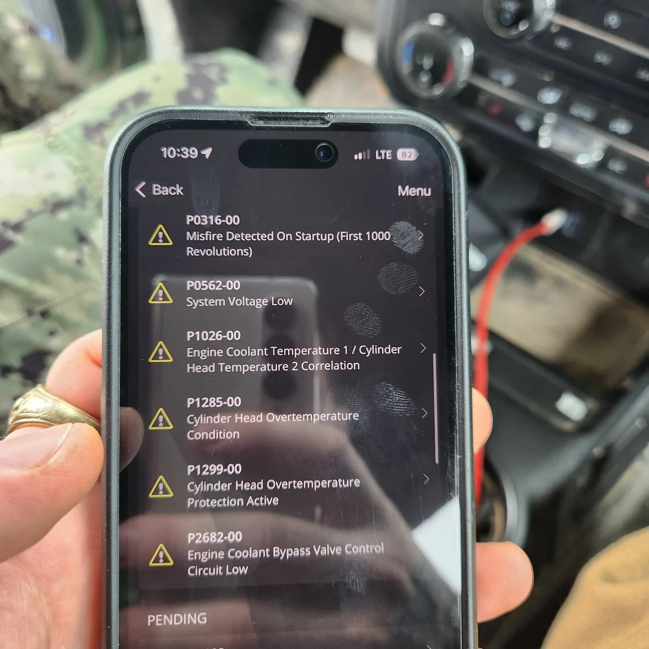

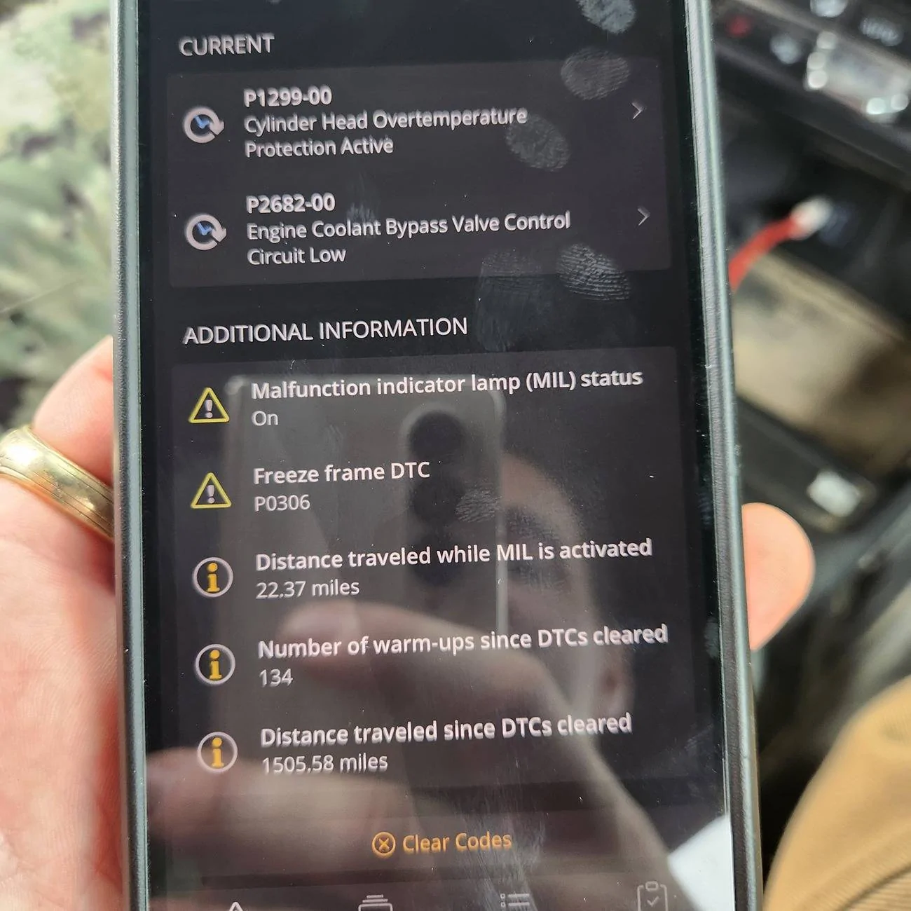

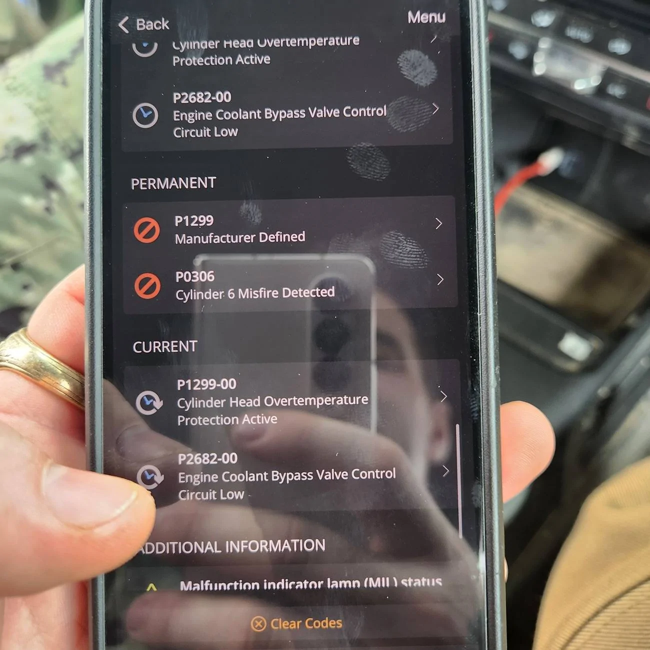

My buddy is bringing his code reader to where my car is parked tomorrow so I'll know a bit more. Currently in the ford app I am seeing and Engin Misfire detected and a Fault with engine coolant temperature sensor and associated wiring. I thought maybe the misfires were associated with limp mode but going to just not drive it.
I'll read codes tomorrow, replace the part Wednesday and read codes again. Worst case ill have to drop it off at the dealer and pick up a rental.
