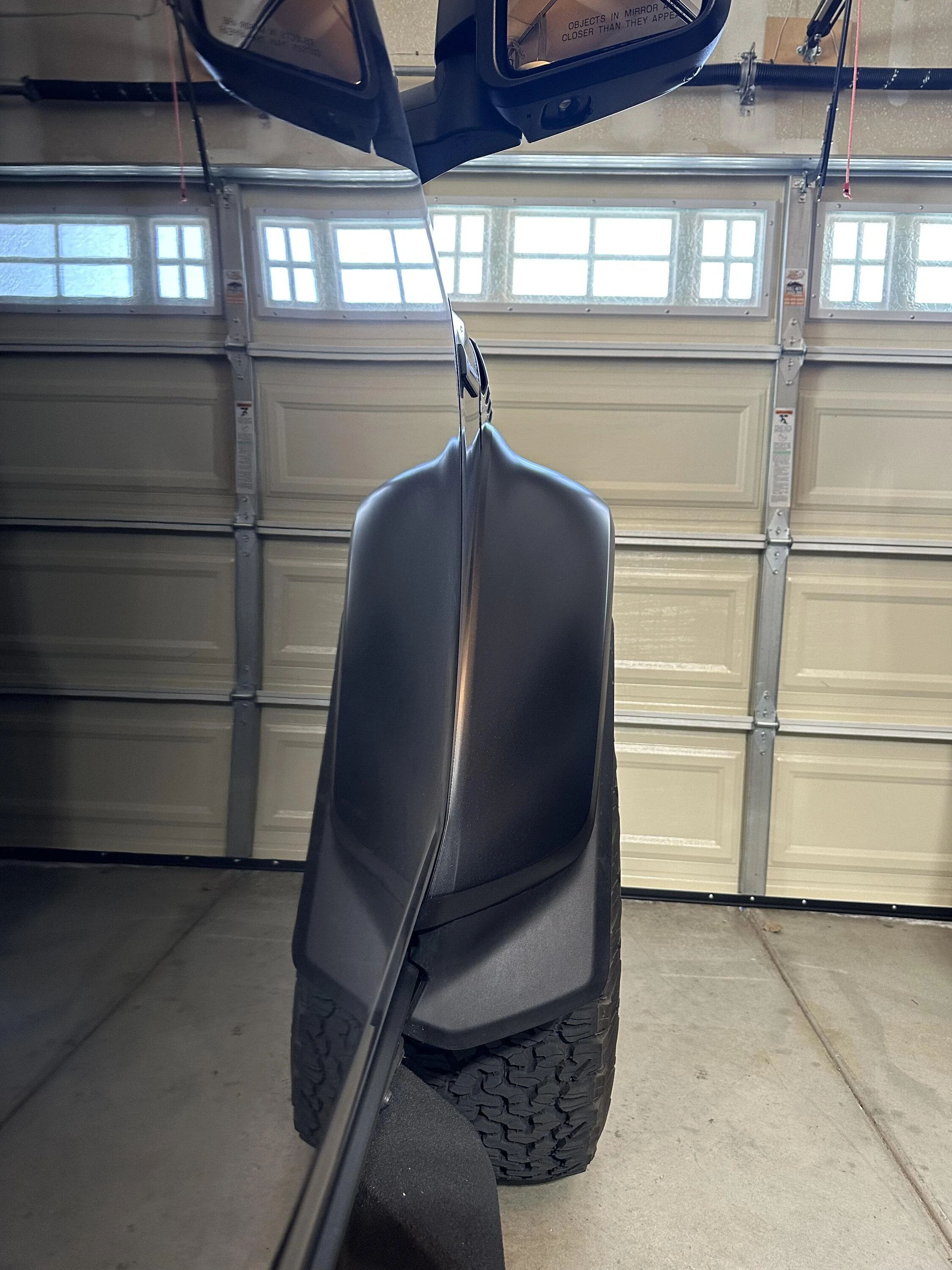

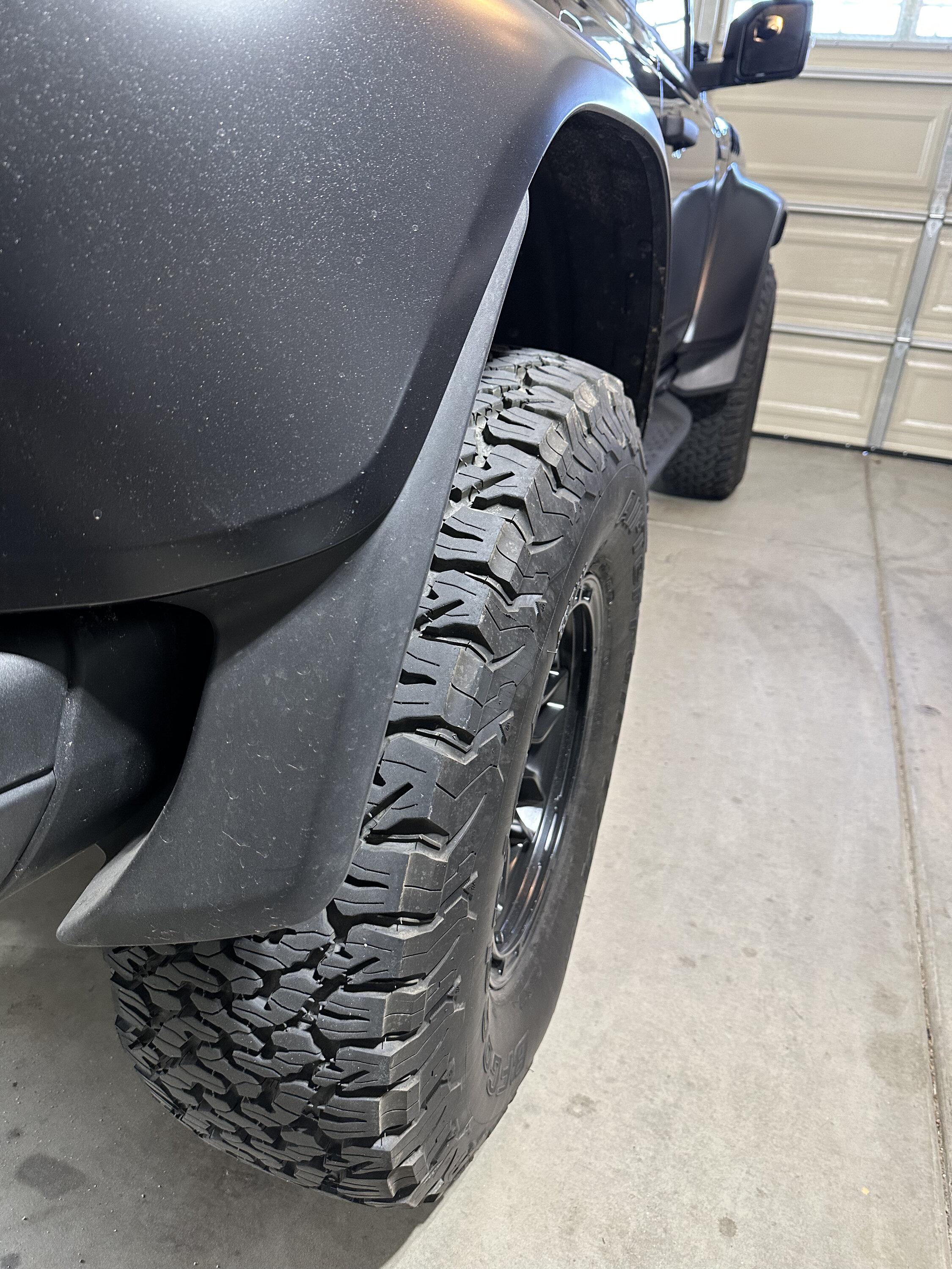

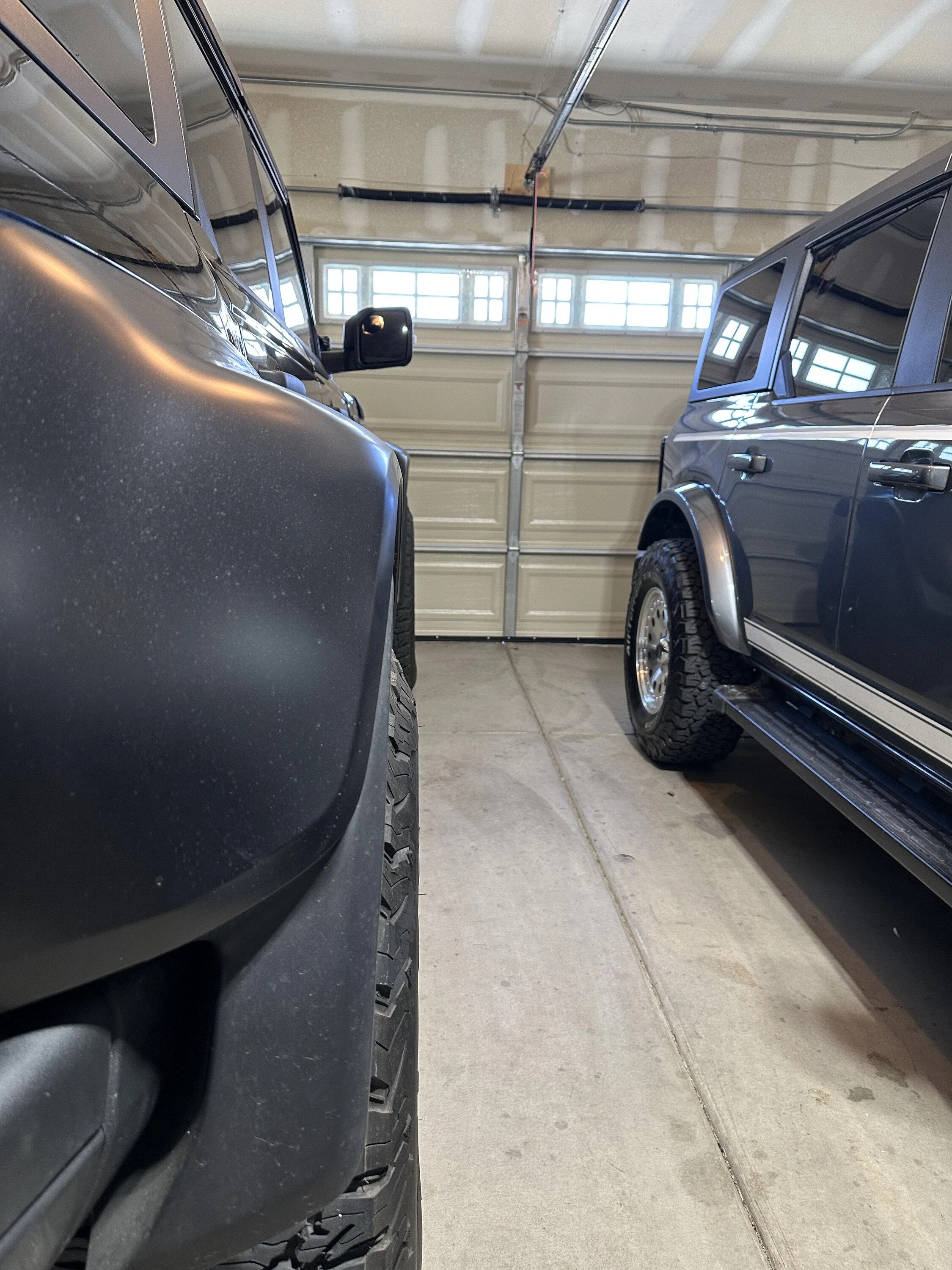

Here are some side profile pics of the RTR EVO6 17x9 +18. It almost flush, not really any poke but it does stick out 22.4mm (0.882 inches) further than stock so the tire tread is right at the edge of the fender flare.
Perfect, that should put me at 3/4” past the flare.

Thank you for the pics. I have the same wheels and they are going to get powdered coated once my Warthog gets built.
