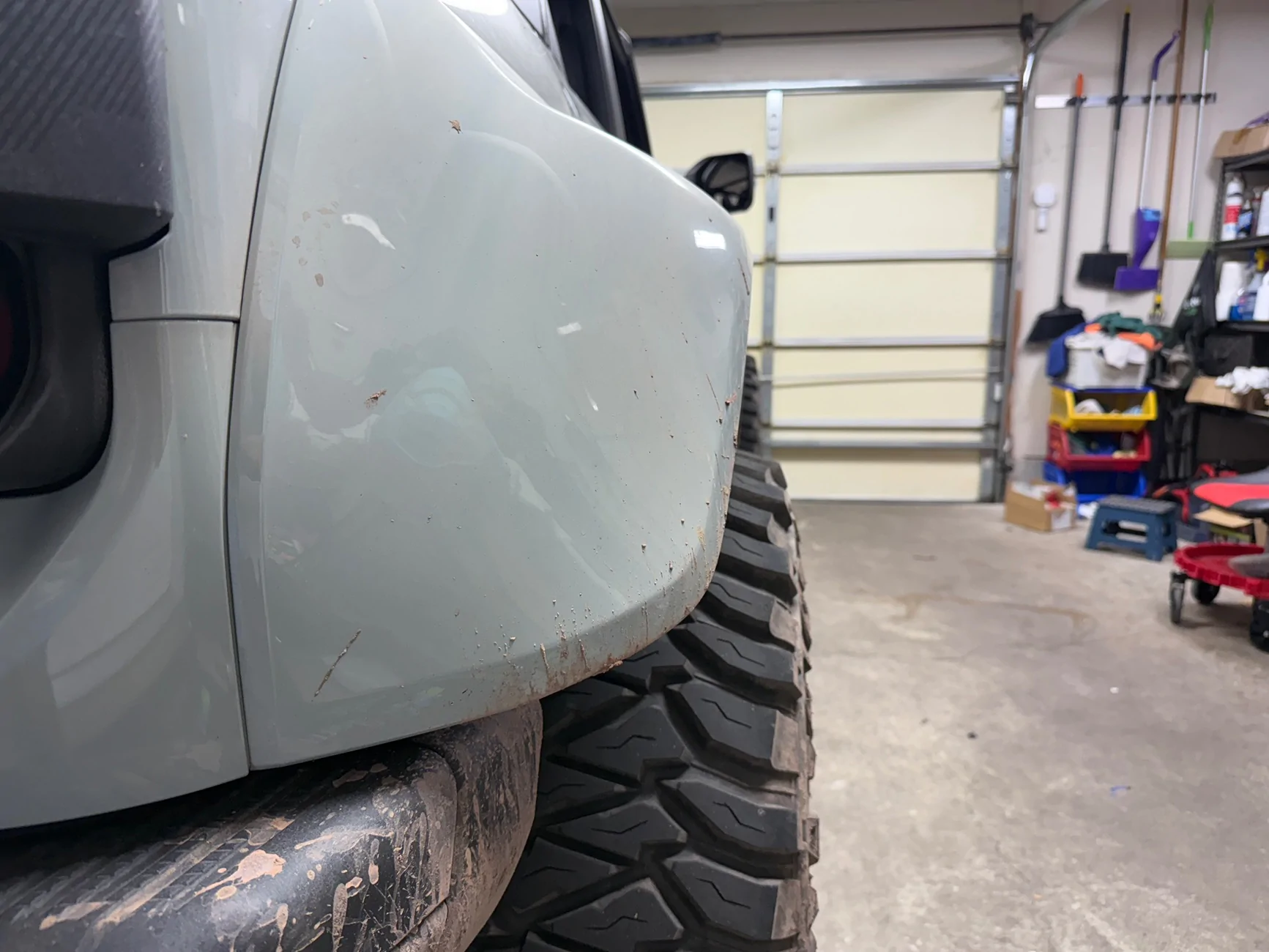

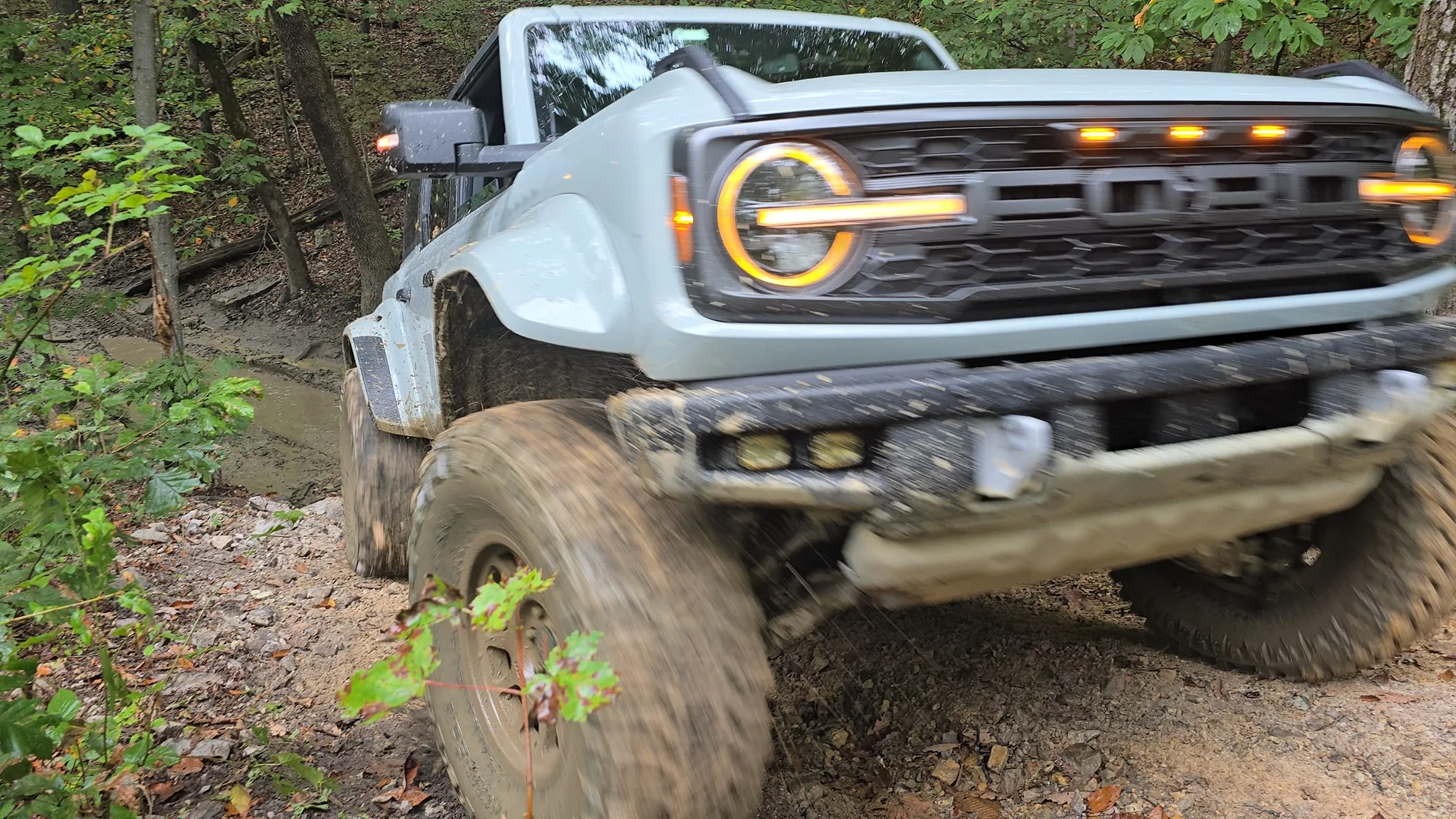

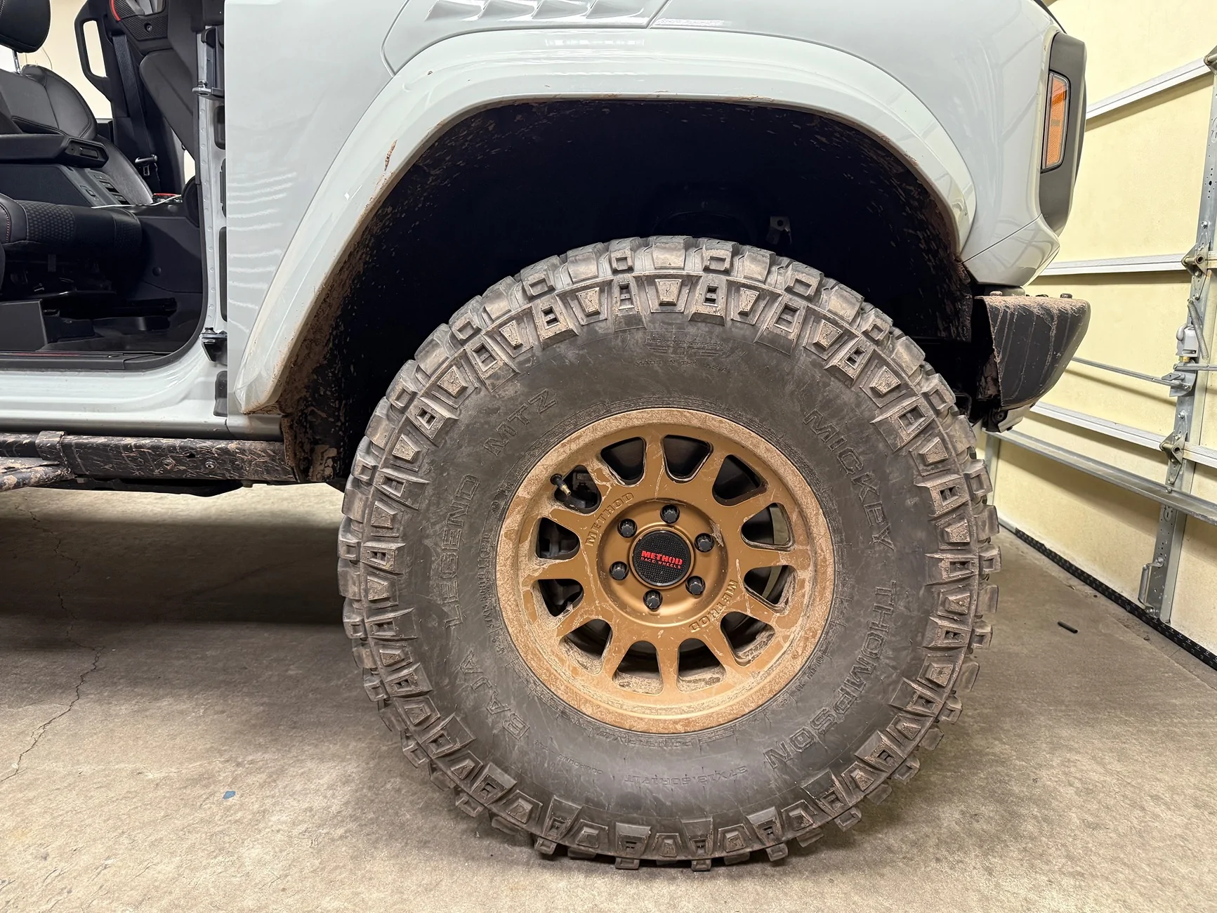

Toyo Open Country M/T 37x13.5x17 on Method MR304 17x8.5 Offset: (mm)0 / Backspacing (in) 4.75

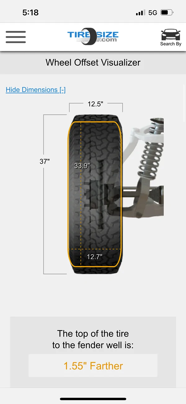

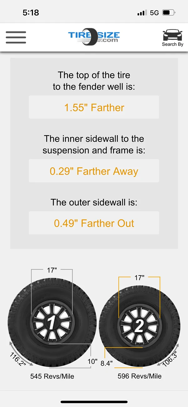

Did you decide on wheel offset yet?
I just purchased a full set including spare for my winter setup as lots of driving in the winter over our passes so always run full snows. Everyone always thinks I’m nuts, but haven’t found an AT tire that out performs a dedicated snow tire, but I digress…
I went with Method 703’s in Matt black +25 offset. The following is based on the calculator, and Nokian 315/70/17 Hakkapeliitta LT3’s. I’d play around as a 0 or negative offset is going to poke a lot as factor is +34.

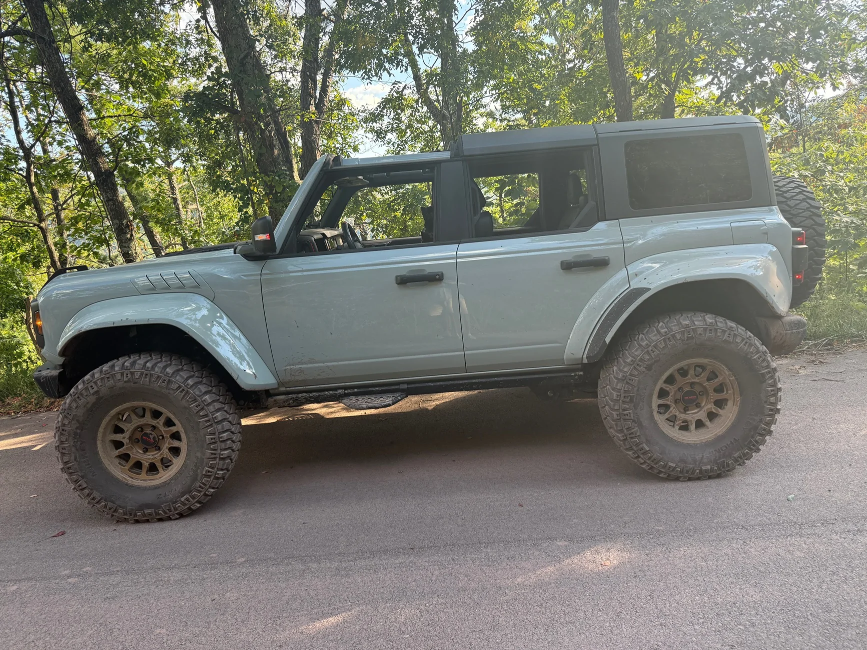

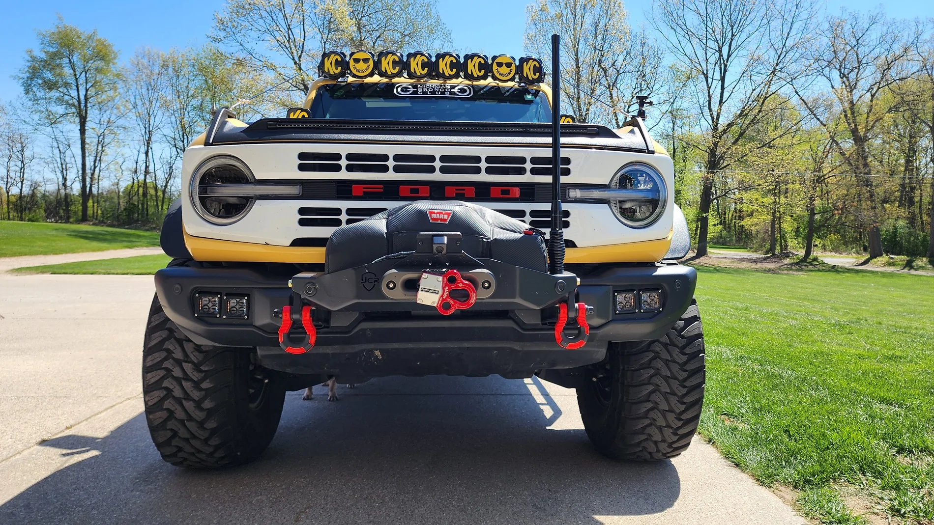

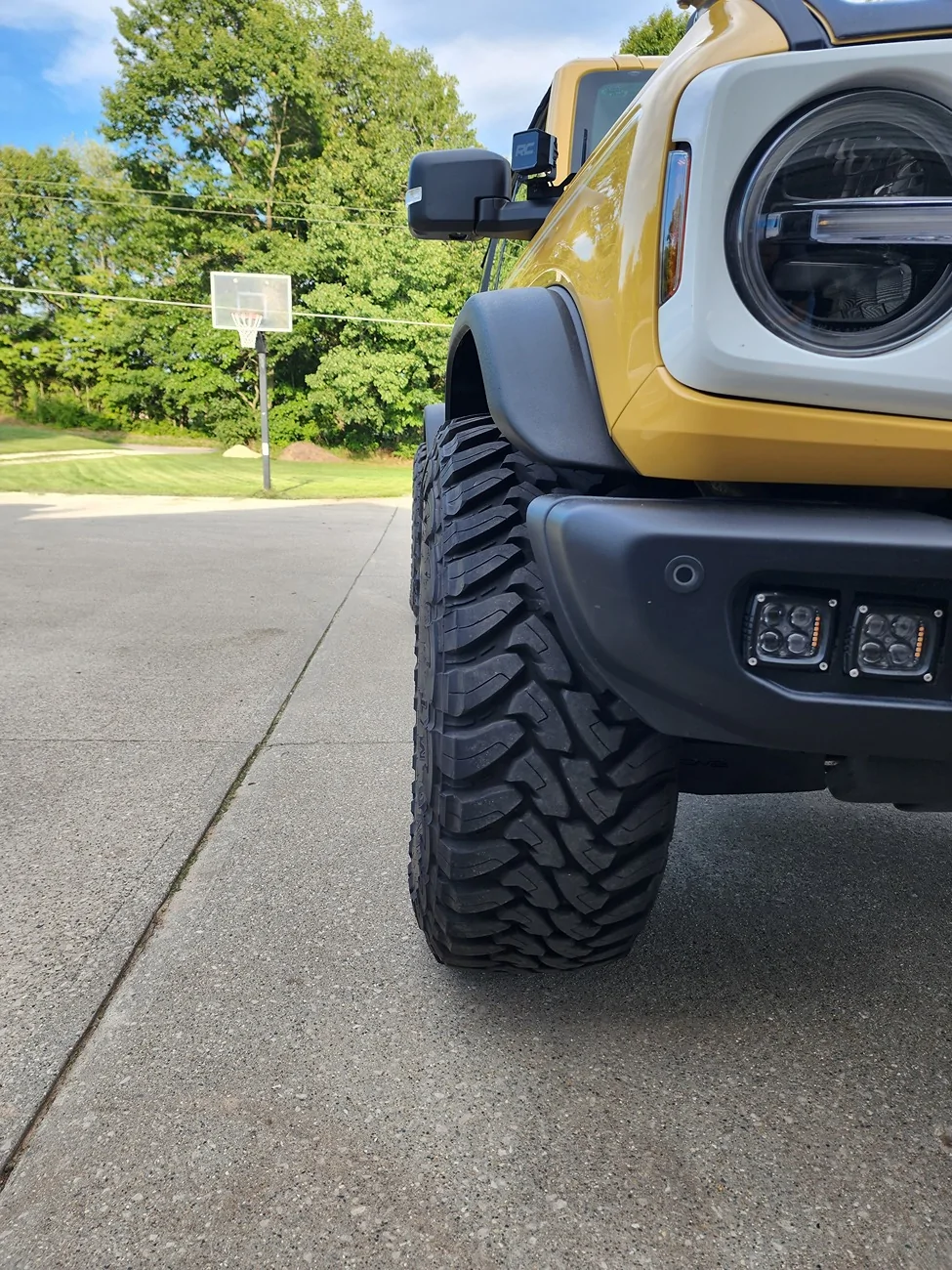

17x8.5 - 0 offset
37 x 13.5MT

Great looking Bronco. Do you have any lift or suspension modifications? Experiencing any rubbing at full lock? I have 17x9 +18 RTR wheels and would like to run 37x13.50 tires as well. Thanks.

Thank you. Suspension is all stock. No rub at full lock. I have yet to have any rubbing at all.
