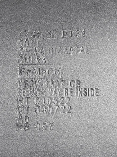

So there has never been any evidence that the Bronco Raptor wheel is +34 BUT finally, I found proof. I saw a Facebook ad for a set of wheels and one of the pics shows "ET 34" ... upper right in the image below
Ford Bronco Bronco Raptor Wheel Offset confirmation? 1674617316088

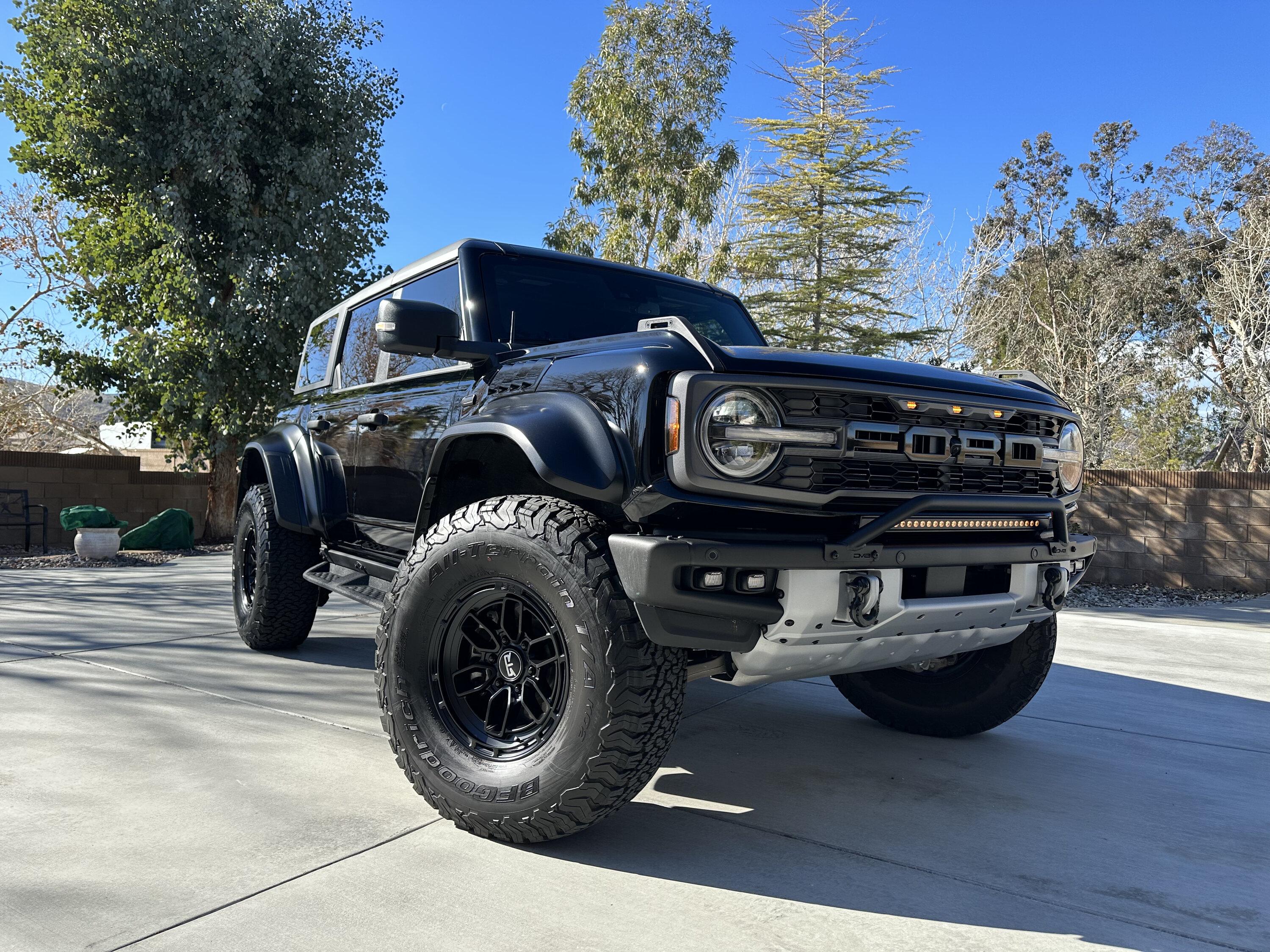

Went with RTR Evo6 17x9 +18. Wheels are 22-23lbs a piece. Stock rubber for now. Happy with my choice!
Ford Bronco Bronco Raptor Wheel Offset confirmation? IMG_0626

How perceptible is 1.3 inches compared to stock? I ask because I’m installing wheel adapters in order to fit my Fifteen52 Analog HD wheels to my raptor when it arrives so I’ll be out close to 2in from stock 🤣. Seems that will put me even with the flares.
My RTRs I’m the post above are about even with the flares and that’s a 17x9 +18, compared to stock 17x8.5 +34, the RTR has about a little less than inch more poke. (22.4mm = 0.882 inches). 2 inches would probably put you past the flares.
