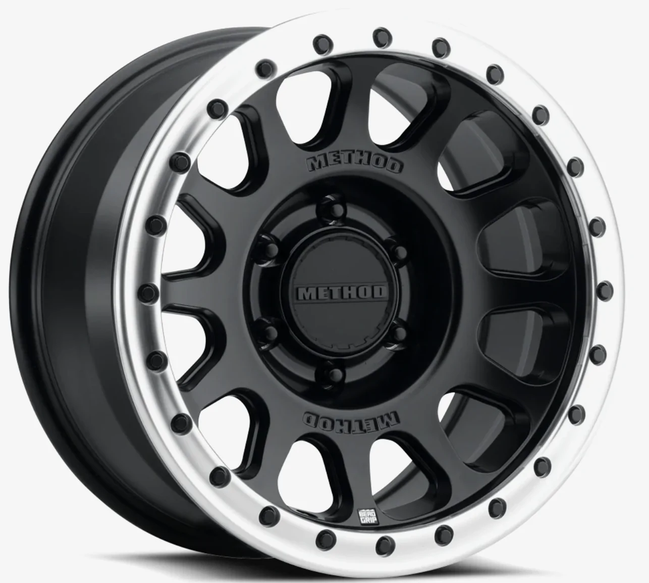

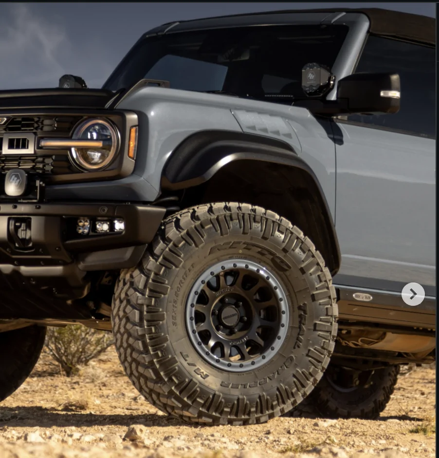

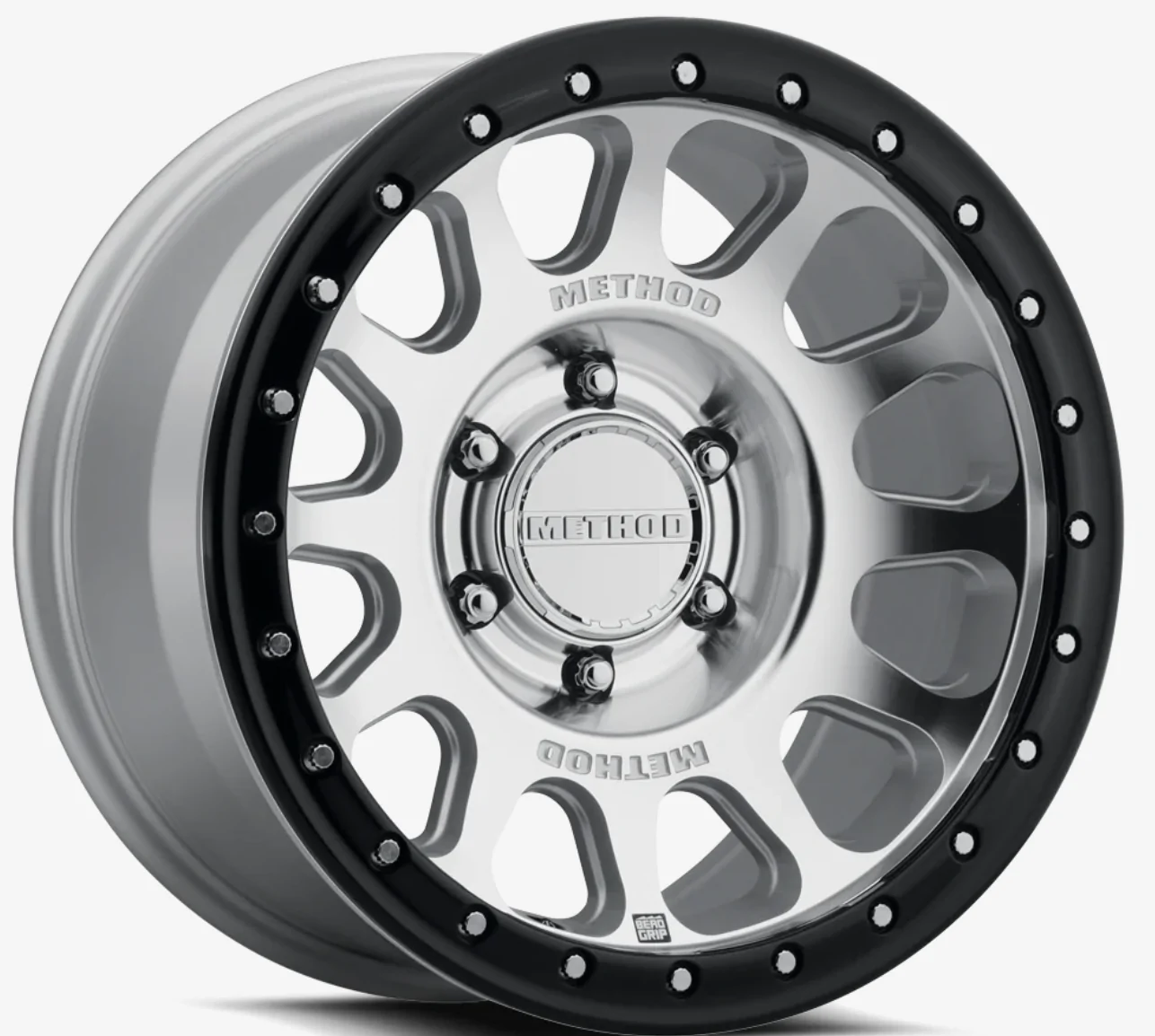

I want new wheels for my 2026 Bronco Raptor. I have an oem stock gloss black cast wheel. Decided on Method and probably 709HD with the removable rash ring.
The Method 709 17x8.5 can be ordered as et0 offset or et25 offset. The 709HD also has the correct hub size so the wheel is hub centric. I see some here doing 0 offset but that is a big deviation over stock suspension geometry. I do not want to rub and knock off a fender and I do not want to change the stock Bronco Raptor suspension. Pushing wheels out as far as 0 offset I worry about causing damage.

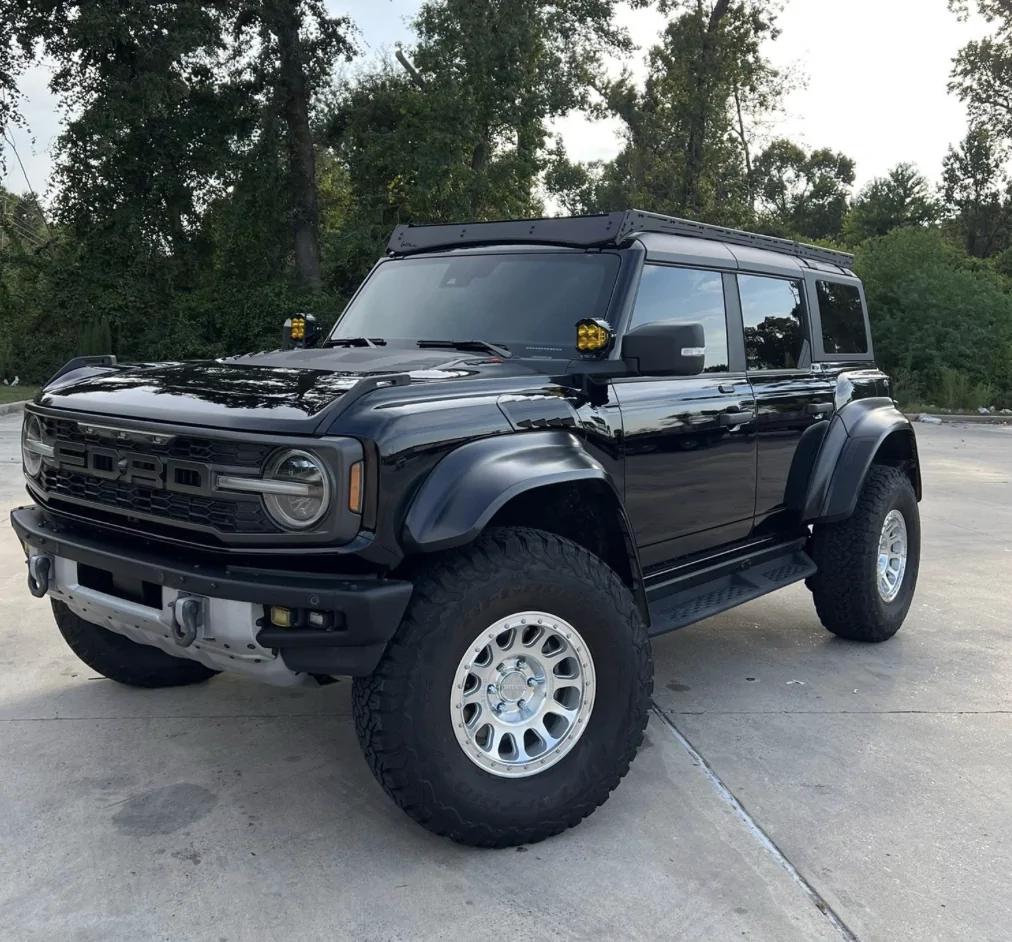

Zero offset is often used here by forum folks with no damage and no rub. I run it too.

You'll be fine with 0. I have spacers on the stock wheels which is pushes the wheel out close to what 0 offset would be. I wheel mine hard. No issues.

I run +0 offset wheels with true 37” Falken AT4Ws. Zero problems.
