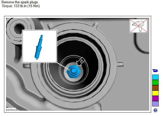

131 inch pounds is correct torque spec? Seems kinda light but there's no gasket to crush so...
Ducati1098
10,067
23,467
Midwest
Yes, that is correct
Edit: Actually its 133. I always just snug them 🤷‍♂️

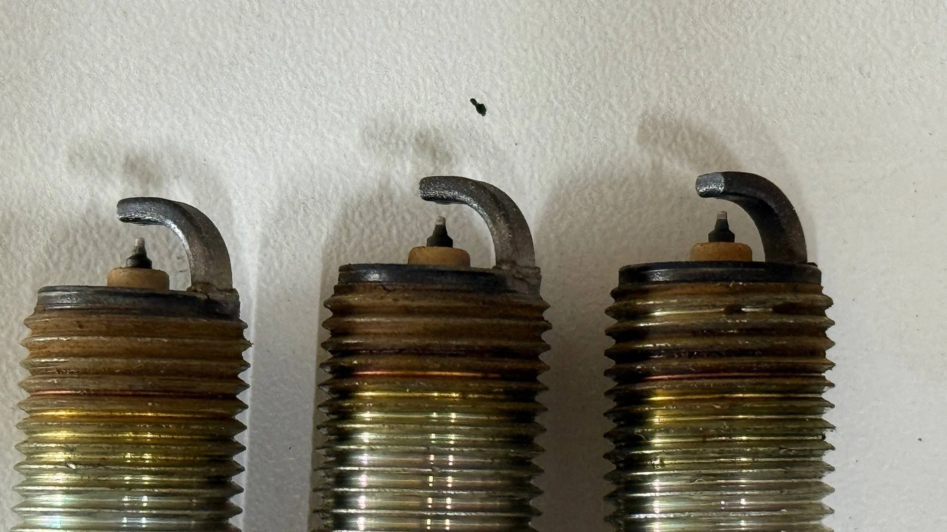

Whew. Just got done. I kid. But seriously, found the plug swap rather annoying. I removed the upper intake tube and the foam cover as it was easy enough.
I have to say it again, love the Ruthenium plugs. It idled so much smoother right from the first spark. No cold misfires either.
Plugs almost looked a little lean but you can't tell squat from plugs with 16K miles on them.

133 in lbs for a spark plug!? That seems way too much! ? Can someone confirm please?
