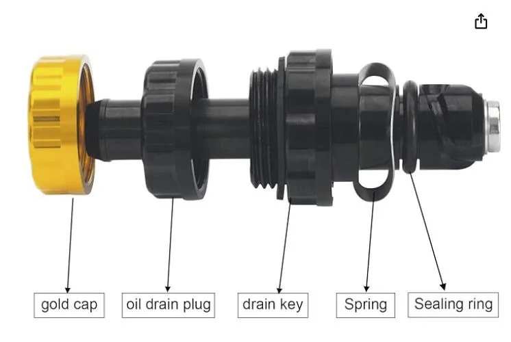

I used this one from Amazon, which have also used on previous vehicles and it works for me.
Ford Bronco New oil drain plug (3.0)? 1743686676396-2q
