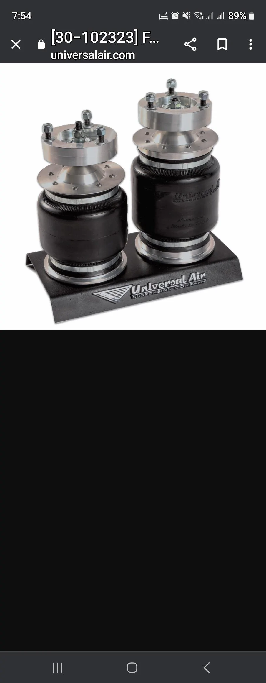

When I saw this i thought it was Broncbuster showing off his smooth crawling skills. (hoping he was switching to the benz) Then I realized the engineers at Mercedes have been watching way too many BB videos,....and now they actually see his style and lack of skills as noteworthy enough to pre-program the stupidity into a new vehicle.
humor aside, I do kinda like this setup....I'd run a huge 1/2" crossover tube connector between both fronts, (with a switched valve)...then with staybar disconnected, the forced articulation and even weight distribution on the 2 fronts would make a huge difference in attainable traction.
https://www.universalair.com/shop/f...ilstien-sasquatch-3962?category=213#attr=2212

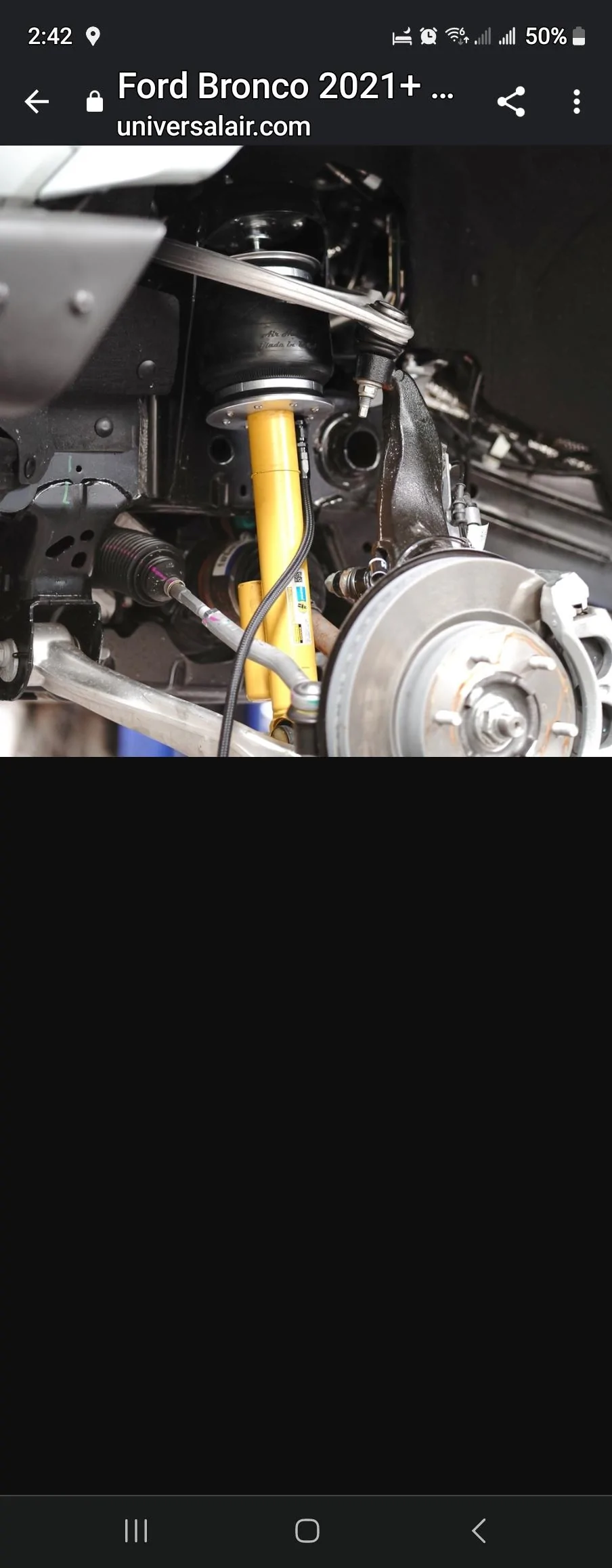

This scenario is EXACTLY where these air bags with a crossover tube would work wonders...I've driven this obstacle, and if I could have lowered the front (lowering air pressure) along with the pressure equalizer crosstube between the two fronts, This would have allowed nearly EQUAL preasure and traction on the front tires, and would make the climb far easier!!!
I think I'm gonna try a set out.
additionally when towing, could add preasure to keep from sagging the ass end.
