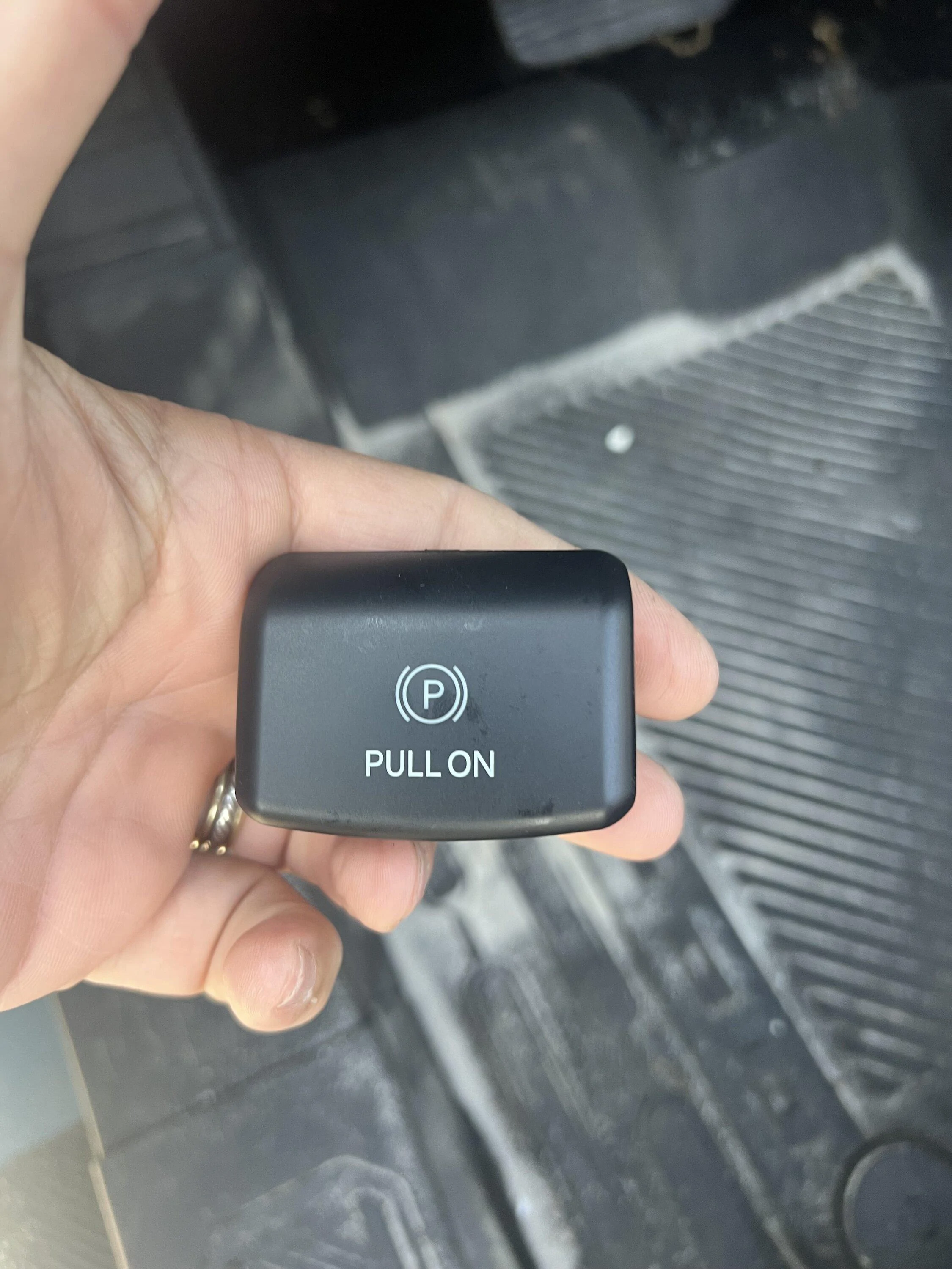

You could always try the updated switch. I'm just not sure what exactly was changed.
However it may work, because the trim panel that it goes into was never updated from what I can see.
The part number for that switch is N2DZ-2B623-AA
maybe the new one doesn't break so easily?

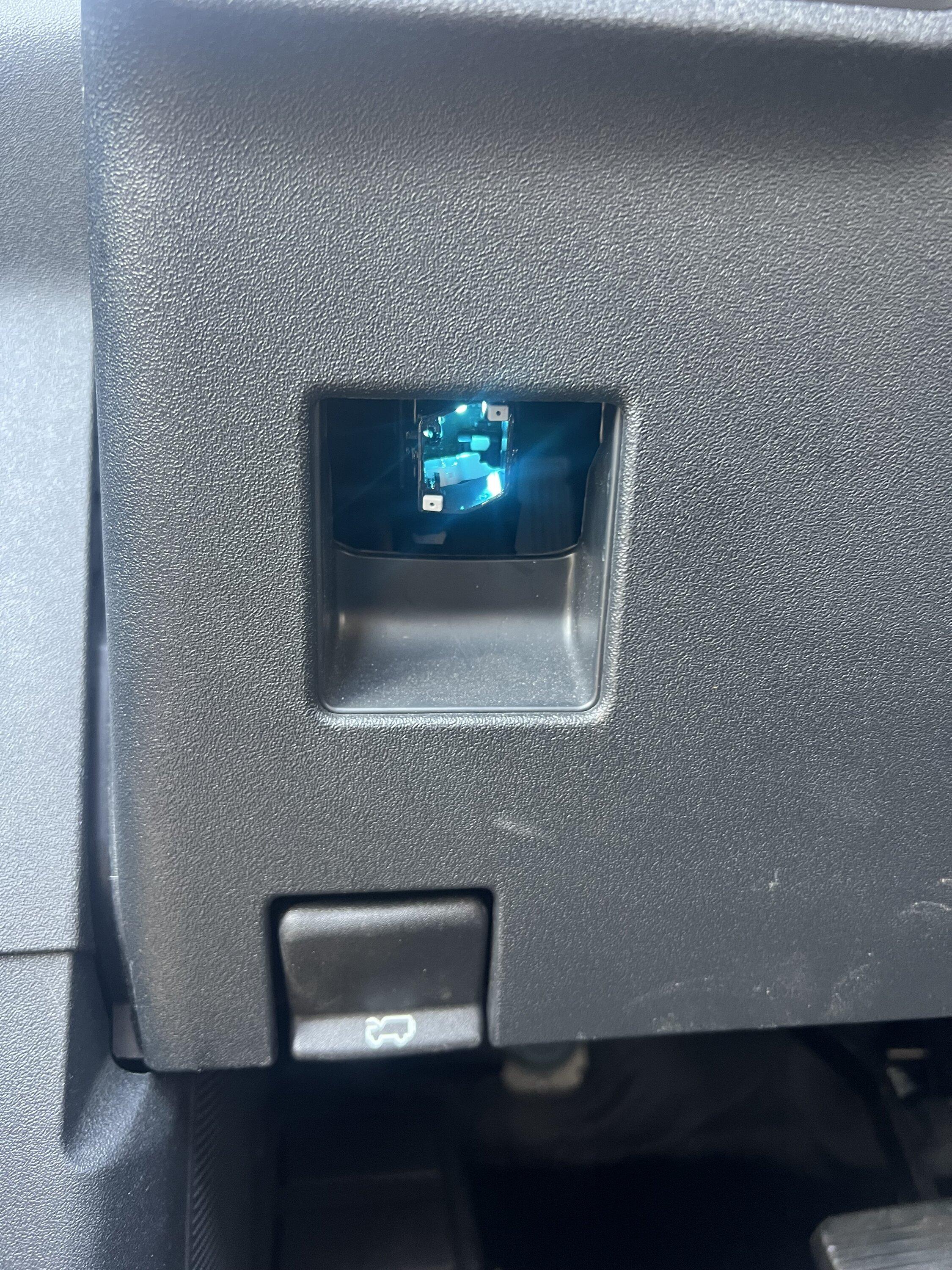

So if the pull level snaps off is it possible to engage/disengage the parking brake at all? Can you poke or pull any actuator inside that hole? I wonder if a completely different mechanism could be wired in, like a center return rocker switch.

someone's still going to go full gorilla and tear out the switch. (it's happened several times at Off-Roadeo NH on the standard switch)
Went to Off-Roadeo in NH last month and they had a whole tutorial on using the parking brake specifically because so many people tear out the switch.
Honestly, Ford could have done a better job engineering this. Since it's electronic and not a manual brake, it should have just been a regular button or switch. Instead, they attached a flimsy piece of plastic and labeled it "pull" which, to most people, implies force.
$60 for a 5 cent piece of plastic?
Yeah, I'd be 3D-printing that.

Does anyone know if there is an easy fix or part number for a new one?
It's your lucky day!
Ford just released a brand new TSB today for 2021-2022 Broncos built on or before 9/18/22
for a broken parking brake switch.
TSB 23-2162
It looks like they will replace the whole trim panel if needed and use the newer switch. So this should be covered under warranty, and it looks like these parts are available.

Okay. Not going to argue with you. Feel free to google the part number and pull up the 20-30 places that lists it for $10-15.
Retail price from Ford is $16.87.
The newer switch for vehicles built after 9/16/22 is much more at $71.45
damm that is quite the price jump
Yeah, the price difference is probably because the part is in the process of being superseded/replaced by the new one. Which also explains why the older switch is on backorder with no availability.
Are there 2 different versions too? Some pull up where other pull down. Mine goes down. Figured because the Bronco was a manual it might be different? Seen both posted on here over the years.
I think this was the reason they changed it. People were ripping the switch off accidentally thinking it was the hood release lever lol so the new switch pulls down instead of up.

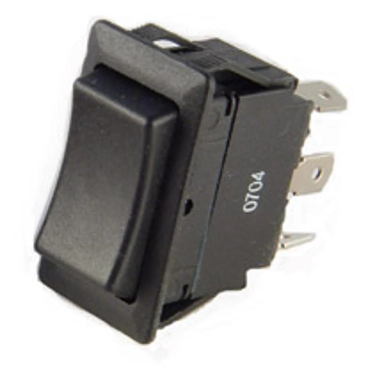

I still don't get why it's not a button on the center console like every other electric parking brake I've used. I'll pay good money if someone developes a piggyback switch and harness.
