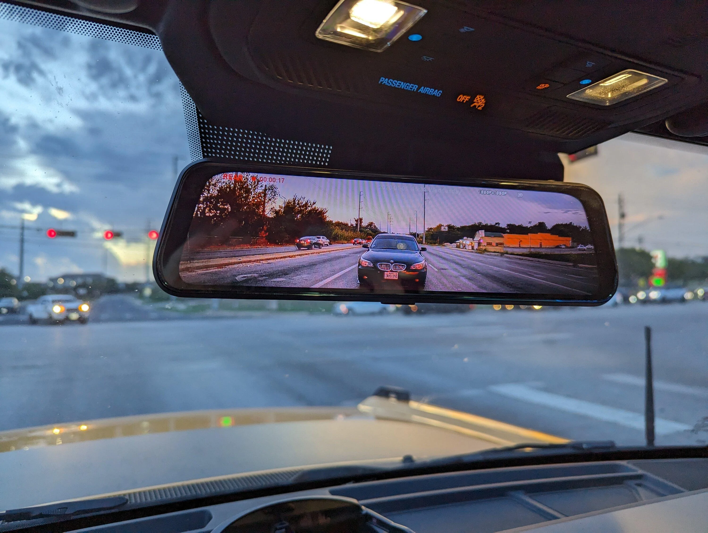

But the picture quality is marred by the mirror image being combined with the camera.
Have the gm factory one in another car and it’s spectacular!
Alas.. not really I have top and doors off till the cold and snow come!
Is the factory GM one also a mirror or is it just a display? If both, I wonder what they did differently to prevent this issue?
Not sure if it's possible but maybe there is a film you can put on the glass to negate the reflection in the mirror?

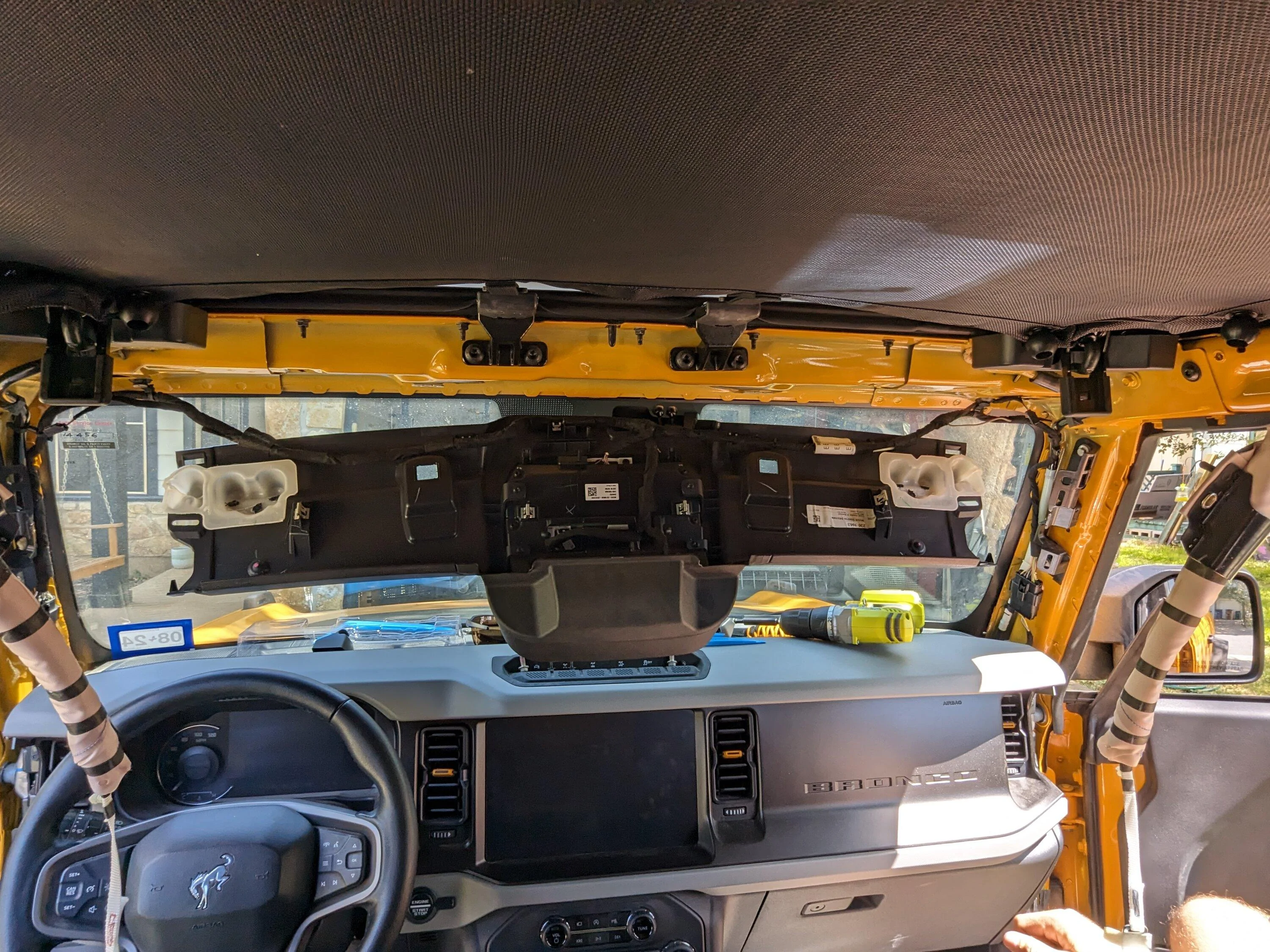

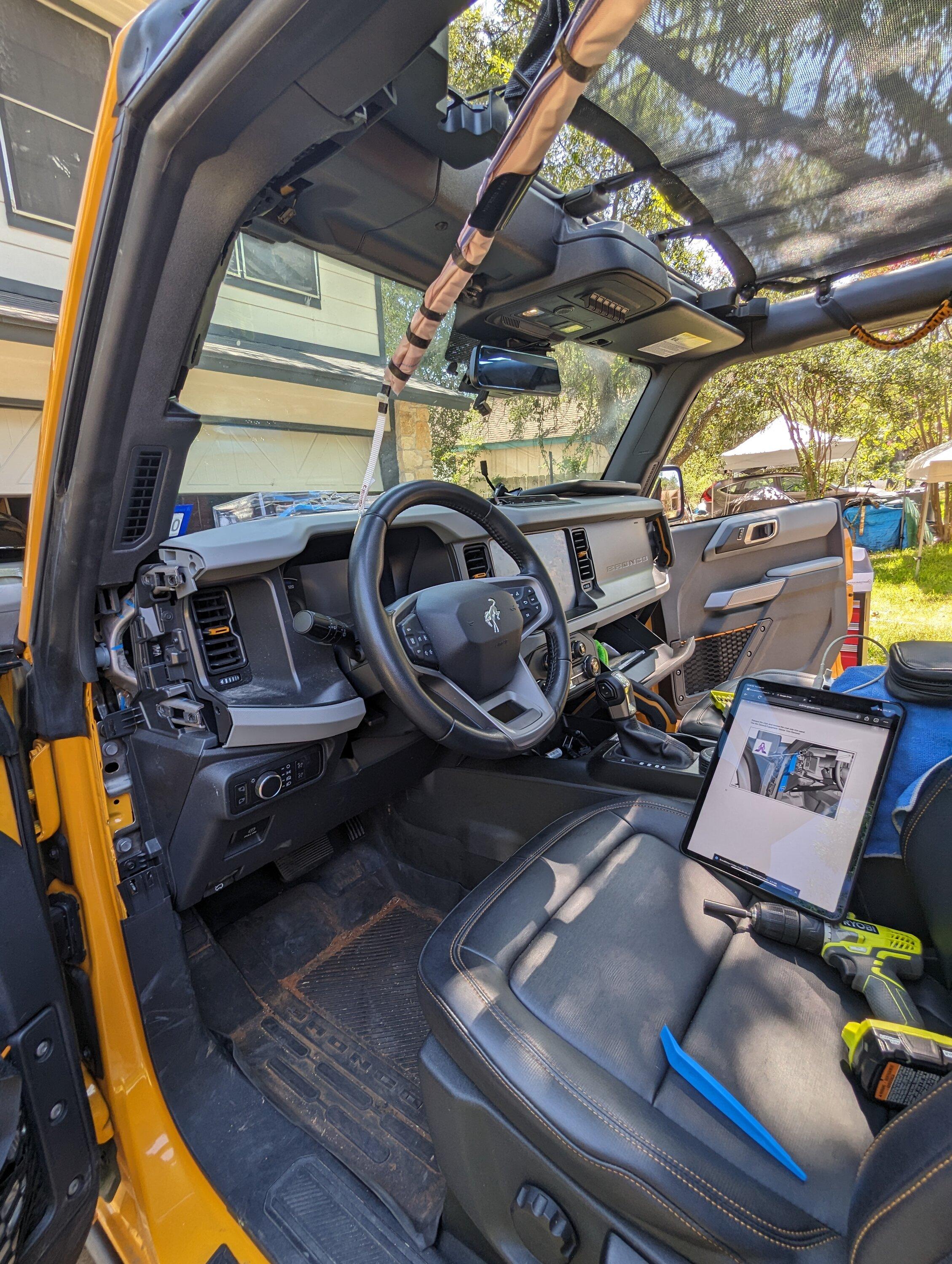

Finished the install.
Overall, I too about 4 hours so as to cross-reference different sources of instructions. I found removing the top most roll bar trim covering the side curtain airbags to be totally unnecessary. Not sure why it's even a step in the instructions, because you wouldn't route the camera wiring that way.
The mirror and camera work perfectly (so far), and I'm hoping I don't experience any of the issues others on this forum have related, such as unresponsive screen or boot looping.
The most difficult bit was actually removing the sun visor. There is a a small torx bolt at an odd angle within a clip housing that took me about half an hour to get out, and half as long to get back in.
It's totally doable yourself if you're comfortable popping off trim panels; they're mostly held on with pressure clips.
