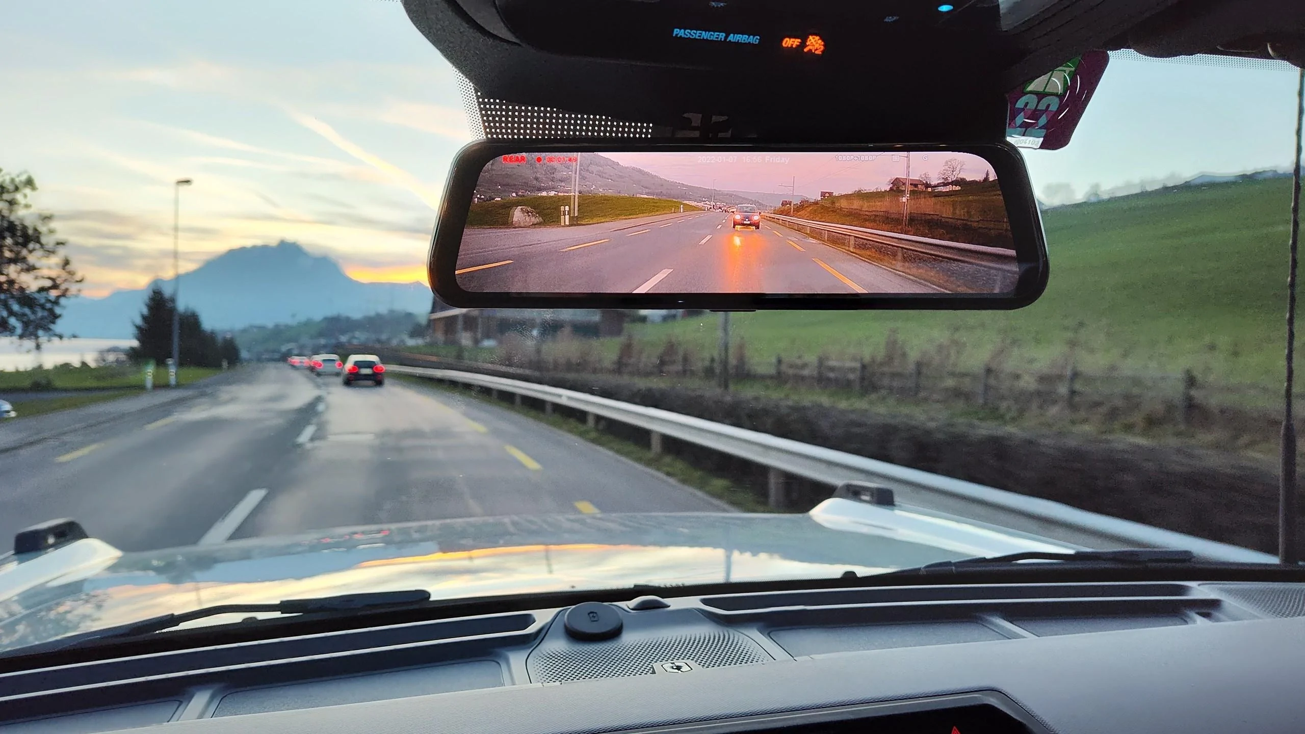

Had it on the shelf for a close to a year 😶
Finally installed, for me it's a blast. Love it.
Installing time was 3h, could be done in less if you know what you are doing.

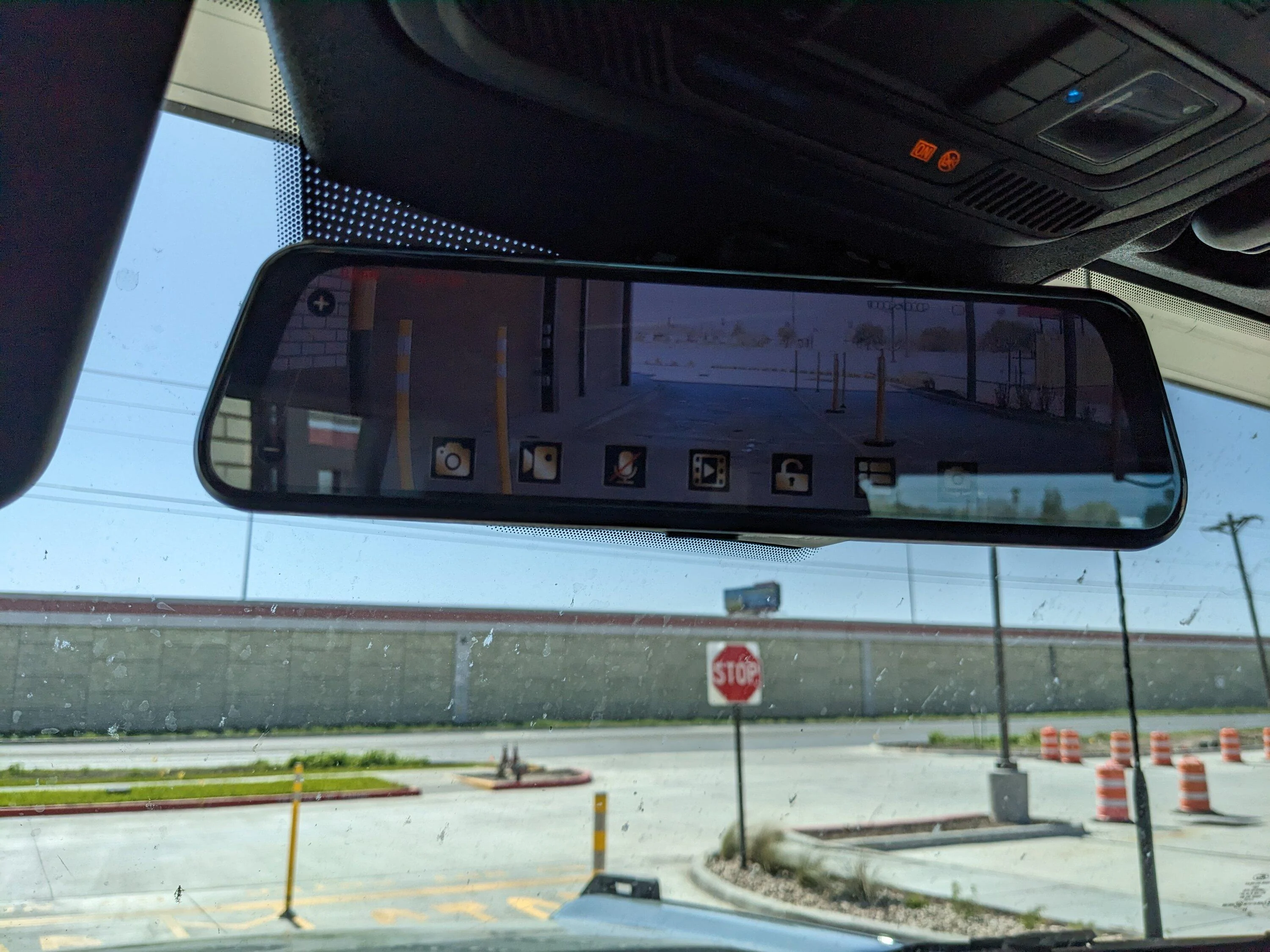

Thanks to everyone in this thread. This thread made it much easier to install than it would have been with just the factory instructions.
To those who use this mirror daily, do any of you feel the mirror is too dim during the day? This is how mine is oe a sunny day on full brightness. It seems too dim and makes it difficult to use.
