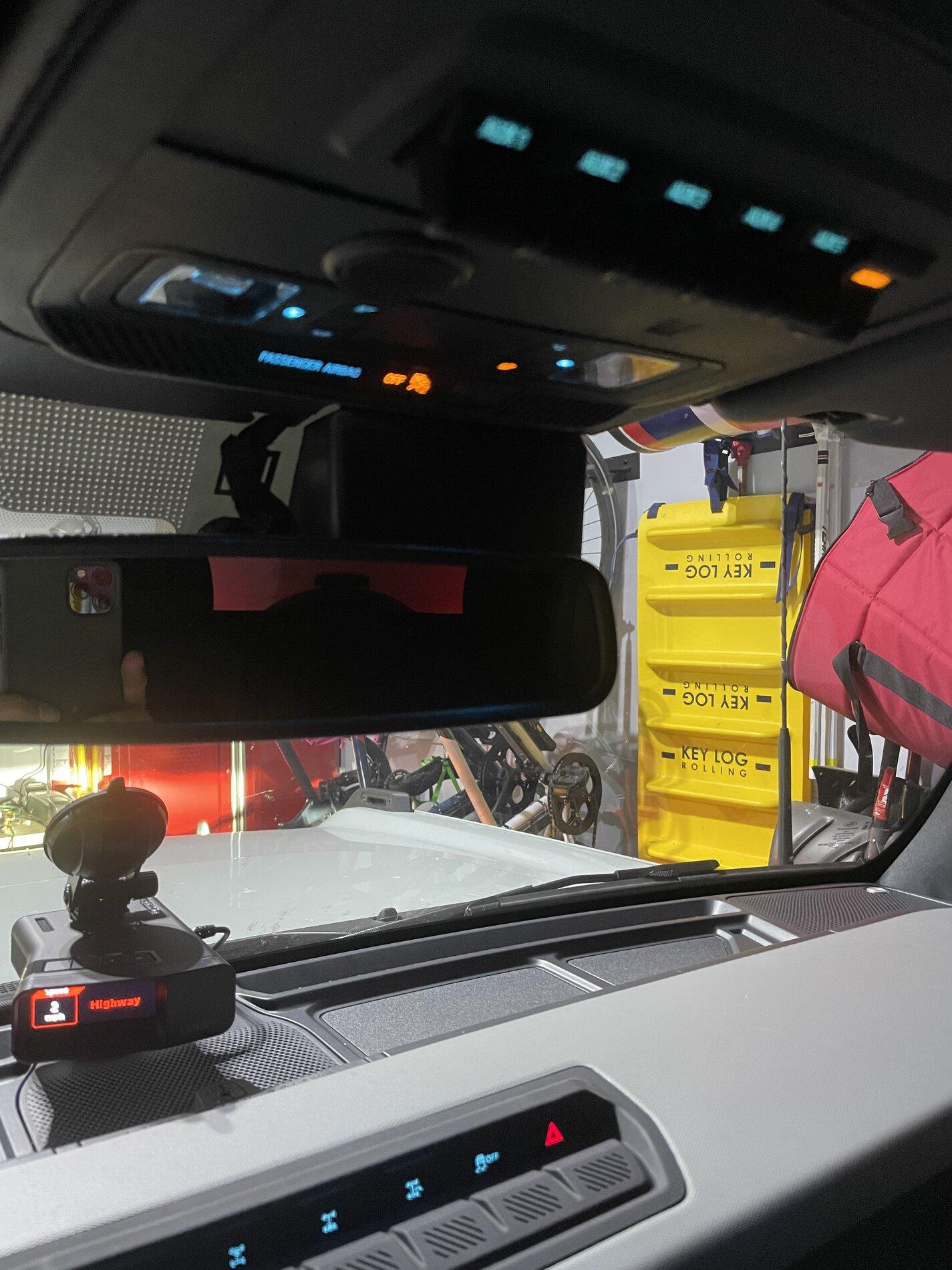

I ran mine to the glovebox prewire and switch 6. Cable tucks behind the window seal and there is room to fish it to the glovebox. Zero trim removal.
That is cool. How does that work? I don't have my bronco yet. Can I leave switch 6 on and it will come on and off with the key? Are the wires easy to get to? I was going to do the mirror tap but maybe this is a good call.
I saw the plugs for the USB, etc. With the V1 would work with that connection.
Thanks,
D.
Yes, The switches are ignition controlled.
The wires are easy, just took a little finger gymnastics to unwrap the tape.
For the Uniden the USB would not put out enough power (only 5v) which I think is the same for the V1.
I find it really nice to just be able to flip it on and off for time where you are stuck in town with a lot of K band or an officer is following you, etc. (plus my wife doesn't use it and kept unplugging it...)
