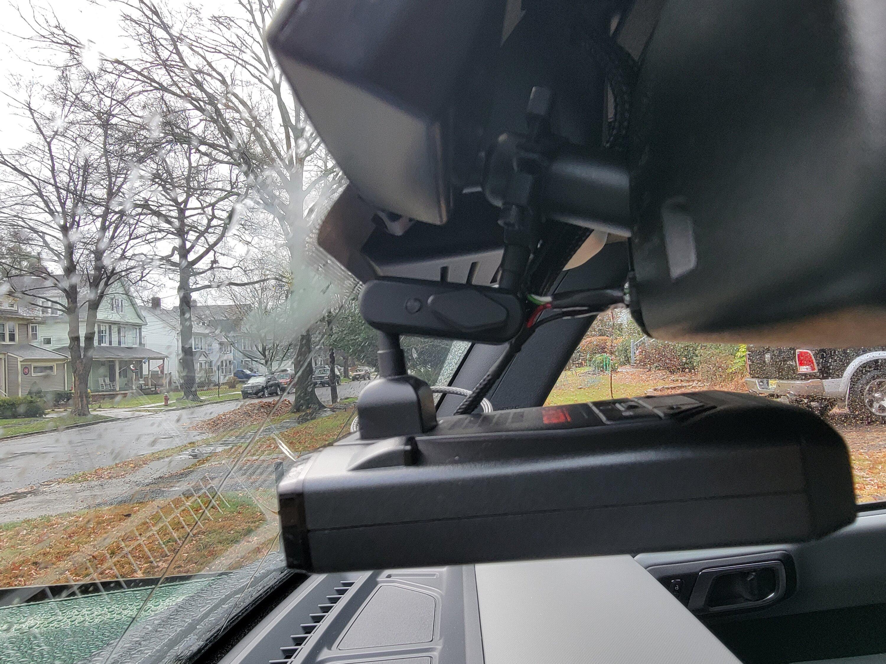

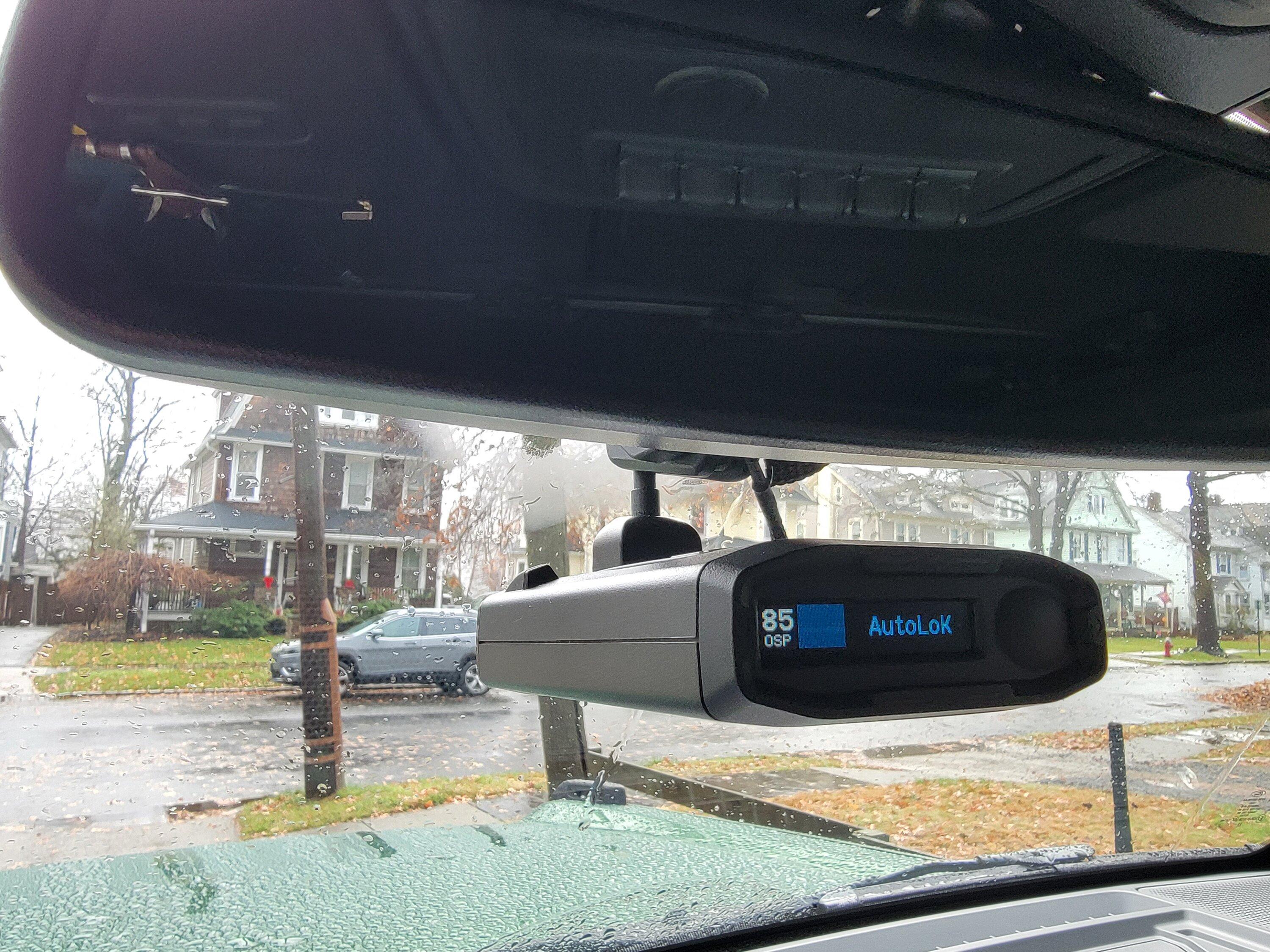

Ford Bronco Radar Detector Mirror mount and mirror tap Mirror Mount 2
Ford Bronco Radar Detector Mirror mount and mirror tap Mirror mount 1
Before settling on this solution, here are the other things I tried that didn't work:
1) 5V to RJ 11 from Stickerfab connected to the dash USB port - I was willing to just use a suction cup or rig a mount on the tripod thread, but I didn't like that the the USB port stays powered for a long time after the car is shut off (eventually it times out).
2) Dongar USB Power Mirror Tap from StickerFab combined with #1) - two issues. First it is very bulky and was interfering with the mirror mount. Second, the radar detector would not stay on - it power cycled every few minutes. It is too bad no-one makes something like this for Ford - I see a market opportunity there.

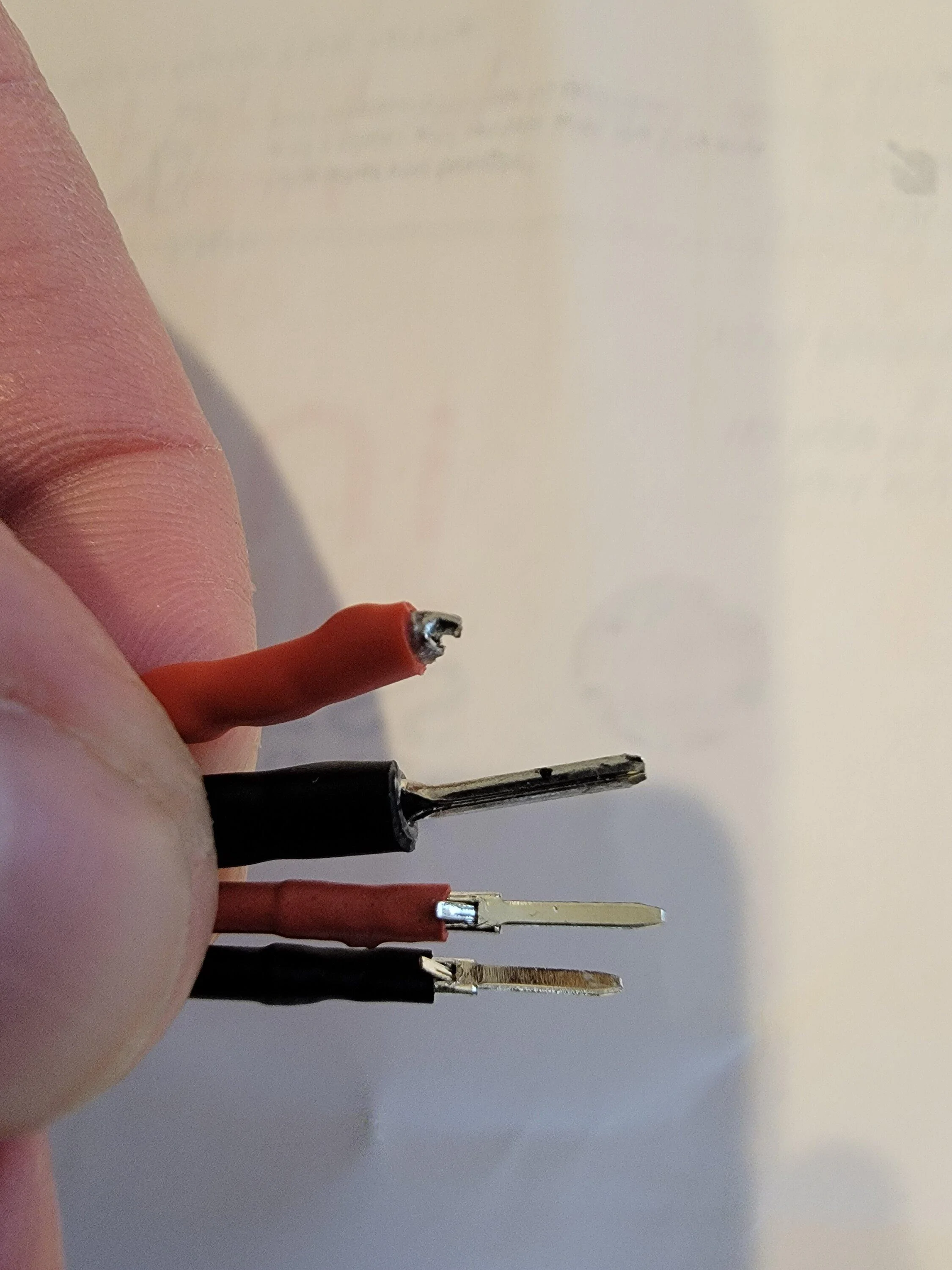

3) Direct Wire from StickerFab: very high quality wire with an on/off switch, but the pins are thick and somewhat fragile, I broke it trying to get the positive to the white wire. Pictures shows difference in size between the Dongar wire and the Amazon one.
Ford Bronco Radar Detector Mirror mount and mirror tap Prongs
4) BlendMount: It is expensive, but high quality and I have been using it on all my cars in recent years. The issue with the Bronco is the mirror wire harness is exactly where the mirror stem is and the Blendmount design interferes with the mirror tap. Maybe it could be done, but I just got this much cheaper solution from Etsy which is similar to many others out there, and the design gives more space behind the mirror harness.

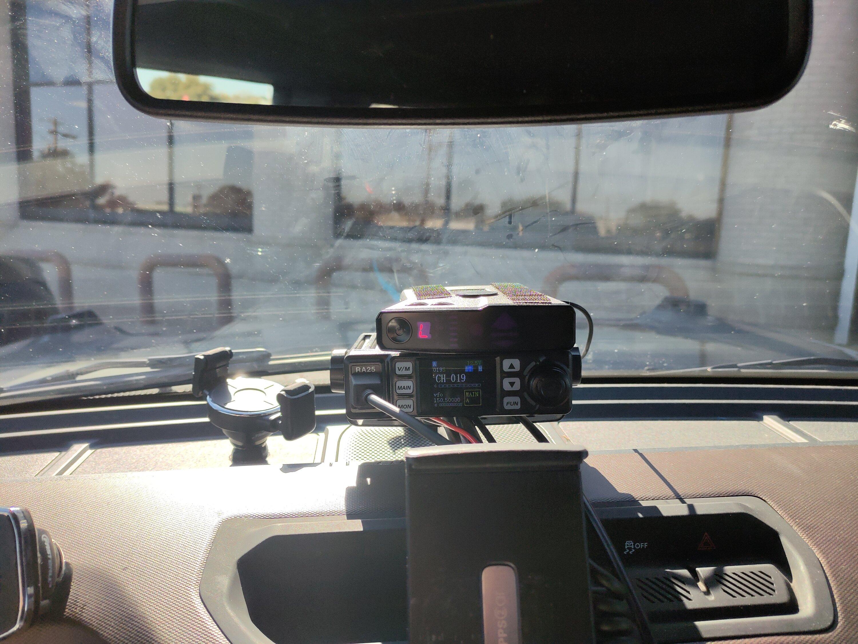

I went with the stickerfab solution, working great.
Ford Bronco Radar Detector Mirror mount and mirror tap 16712125571335737213421029437220
velcro keeps the V1 on top of the radio.
