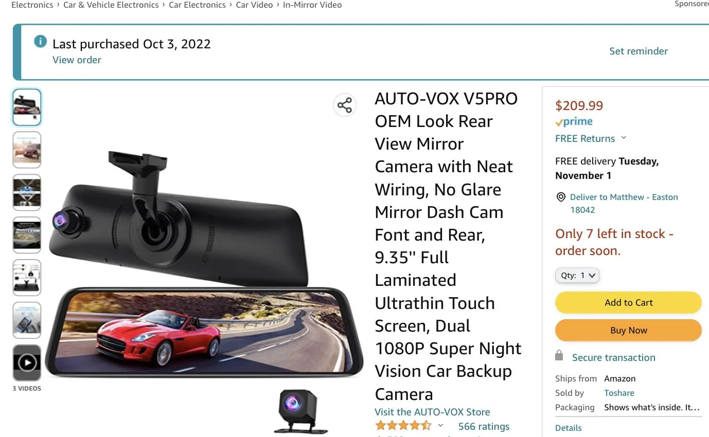

I have these in my street car as a factory option. I like them so much I have used two different brands in my jeep. I just installed another one in my bronco. Amazon many versions - although it’s fairly hard to get one that has the windshield mount already included.
In my experience I have found the 170° angle lens is a bit wide, and 140 is a bit more natural for a rear mirror style view angle.
I put a photo of the one I’m using currently and it’s less than half the price of the brand motion, although you’ll notice that the specs are similar. The resolution is actually better on this as I have used at the brandmotion as well (they make a Jeep version too).
I do have to angle the mirror up towards the ceiling so that I don’t get additional reflections on the image of the mirror when I’m using the camera. For a while I tried using just a monitor that didn’t have a reflective surface but thought I might have trouble with inspections so went with this ‘mirror’ style.
Another thing to watch is the width, some of these things are 12 inches wide which is very large. The factory was closer to 10 inches so that’s what I went with. Unfortunately these monitors are a little taller than factory so they don’t look exactly like a stock mirror but that’s OK.
They’re simple enough to wire just run the wire through the windshield header down a pillar and to the rear. One thing I did notice is the connector that takes USB power from the factory dimming near adds a lot of interference. Using it made little lines constantly go down the screen. I decided to do direct wire instead. I actually topped off the 12 V lighter socket inside the consul so that the mirror goes on every time I turn on the ignition.
The only thing that’s a little annoying is the turn on tone that you can’t turn off. So every time you start the car there’s a slight delay and a series of chimes plays.
Ford Bronco Brandmotion fullvue mirror AB22C14B-963D-449F-A142-D6BC02D7DF2F
