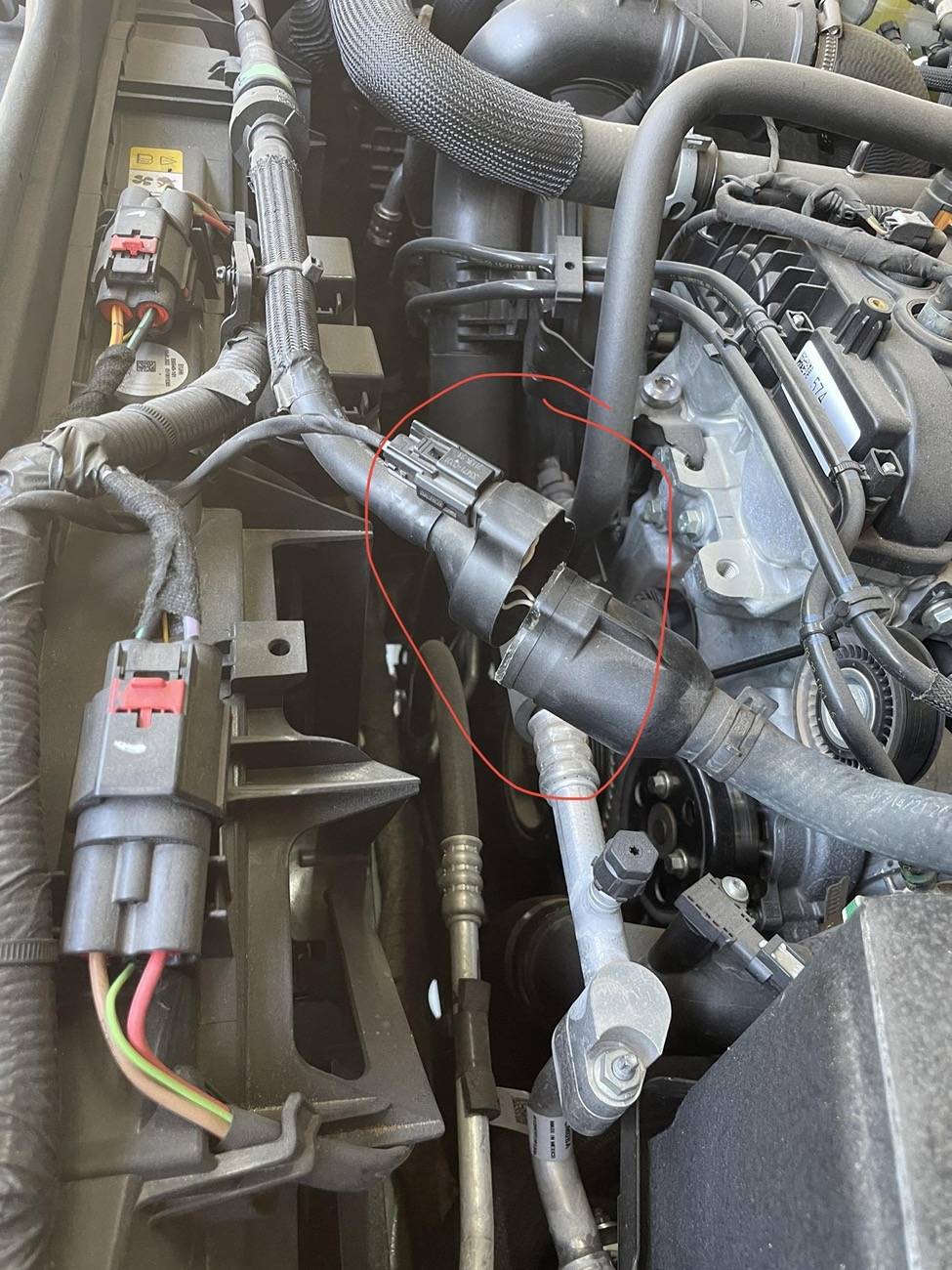

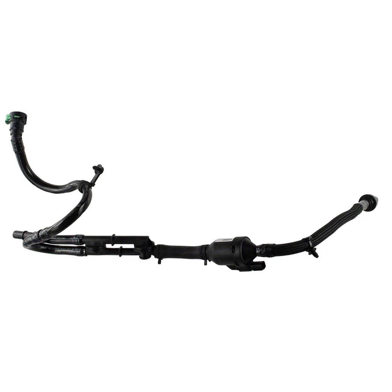

Assuming it is not just worn brake pads, I recently had the brake light come on and took it to the dealership and it was the vacuum line. “trouble code (DTC) P050F…This may be due to contamination in a brake booster vacuum line. To correct this condition, replace the vehicle's vacuum hose (MB3Z-2420-A).”
Ford Bronco Brake light on IMG_7763
Ford Bronco Brake light on IMG_7764
see this thread for more insight. https://www.bronco6g.com/forum/threads/what-is-this-part.77877/
