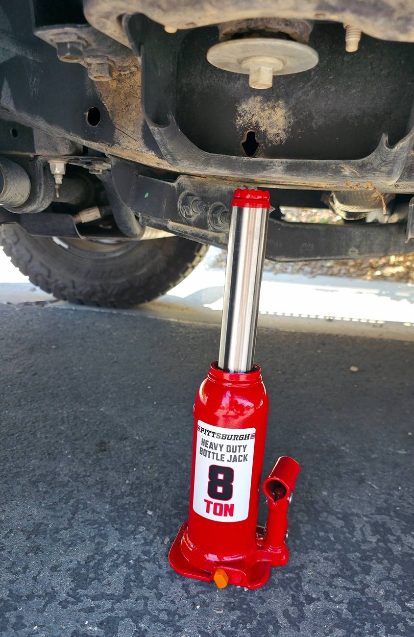

Which is a better option?
Simple 3-inch extension adapter kit from Amazon VS
$117 safe jack kit.
More specifically, should I spend the extra $120-$130 (after taxes) for the more expensive safe Jack kit
To give me the extra little height to be able to slide my jack stands under while changing a flat?

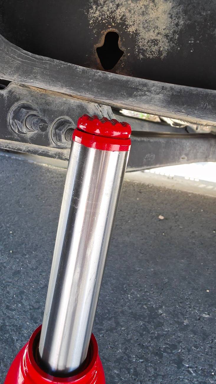

I'm about half an inch from touching frame (Front)
*Bottle jack is fully extended

Think you should just save some money and head to the nearest Home Depot and get them to cut you a thick block of wood. Sand it, then call it a day. Wider than the base of the jack should make it a bit safer.
Think the block method has worked for, I don't know, maybe 50+ years.

100% wood blocks under the jack. 2x6 or 2x8s stacked, for a nice and wide platform.
Unless it screws into the top of the jack and is weight tested and secure I wouldn’t put anything on the top there, but no issues stacking stuff underneath as long as it’s wider than the base of the jack itself

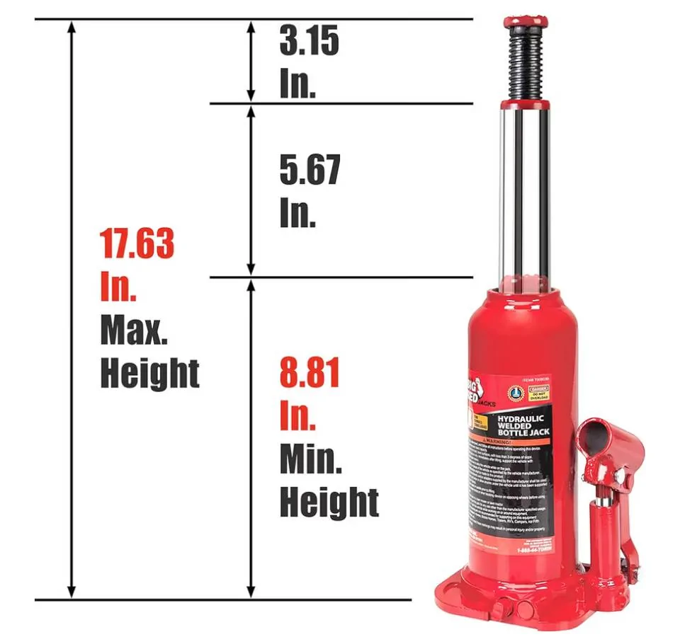

Does the top of this bottle jack not screw out for extra height like on every bottle jack I’ve ever seen?
And yes keep a block of wood with it. If you need a roadside tire change that bottle jack needs a wider base for safe use off the pavement.
That is what I could not understand. The BJ on that 8T extends another 3”. Still may need wood though.
I agree he will still need blocks since he has suspension droop to overcome also.

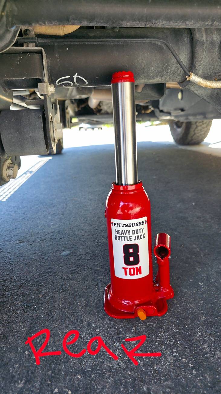

I use the 12 ton version of this jack in my trail kit and it just BARELY lifts the front enough to get the tire off (base suspension, 33" KO2s). I throw a piece of wood and it helps a lot.
As far as the rear, I highly recommend the Bottle Jack Buddy (https://bottlejackbuddy.net). Cradles the rear axle really well, I use it routinely as part of my tire rotation setup.
