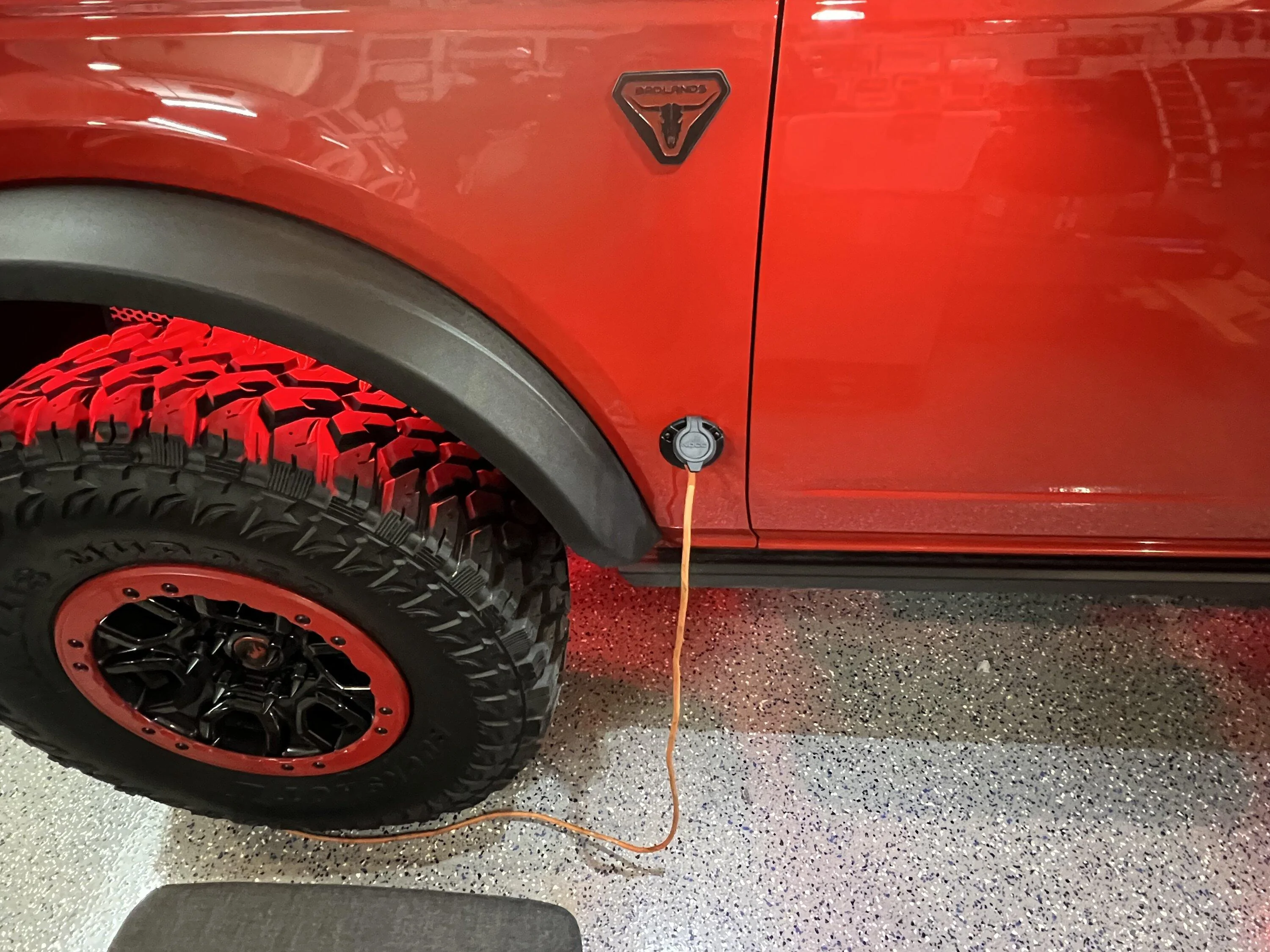

That is my 120v in for the truck. It then runs a battery maintainer under the hood and runs to the back of the truck where I have a power strip. Allows me to run everything in the truck with it off without fear of the battery going dead if plugged in. That spot was dead space.
Your wheel well lights are they wired to your aux switches, if so can you share install. Doing the same
I didn’t do a install for it. Was pretty straight forward. Started from the rear pass over to the driver pass, up the frame rail to drivers front. Then brought the pass front over. I put it on a aux switch. My lights have the separate remote, so aux will send power to the controller and I need the remote to turn the lights on.
One of the tricks I did use was a roll of thick solder for fish tape in the wheel wells. Works good for working around tight spots. It can flex but still stays rigid. I just put 3/4” holes where ford had the pod locations. Just screwed right to the liners with self tappers. They lock up in that felt stuff.
