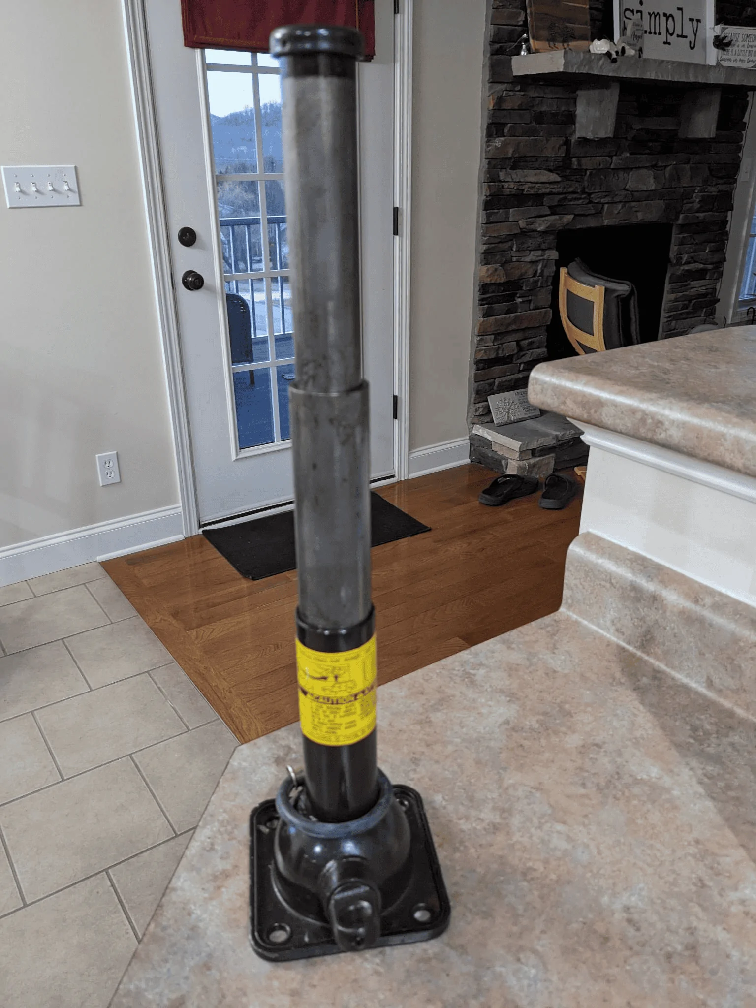

Outside the factory stuff, I bought a Toyota mechanical screw bottle jack, they are easy to find on ebay and dont cost a fortune :)

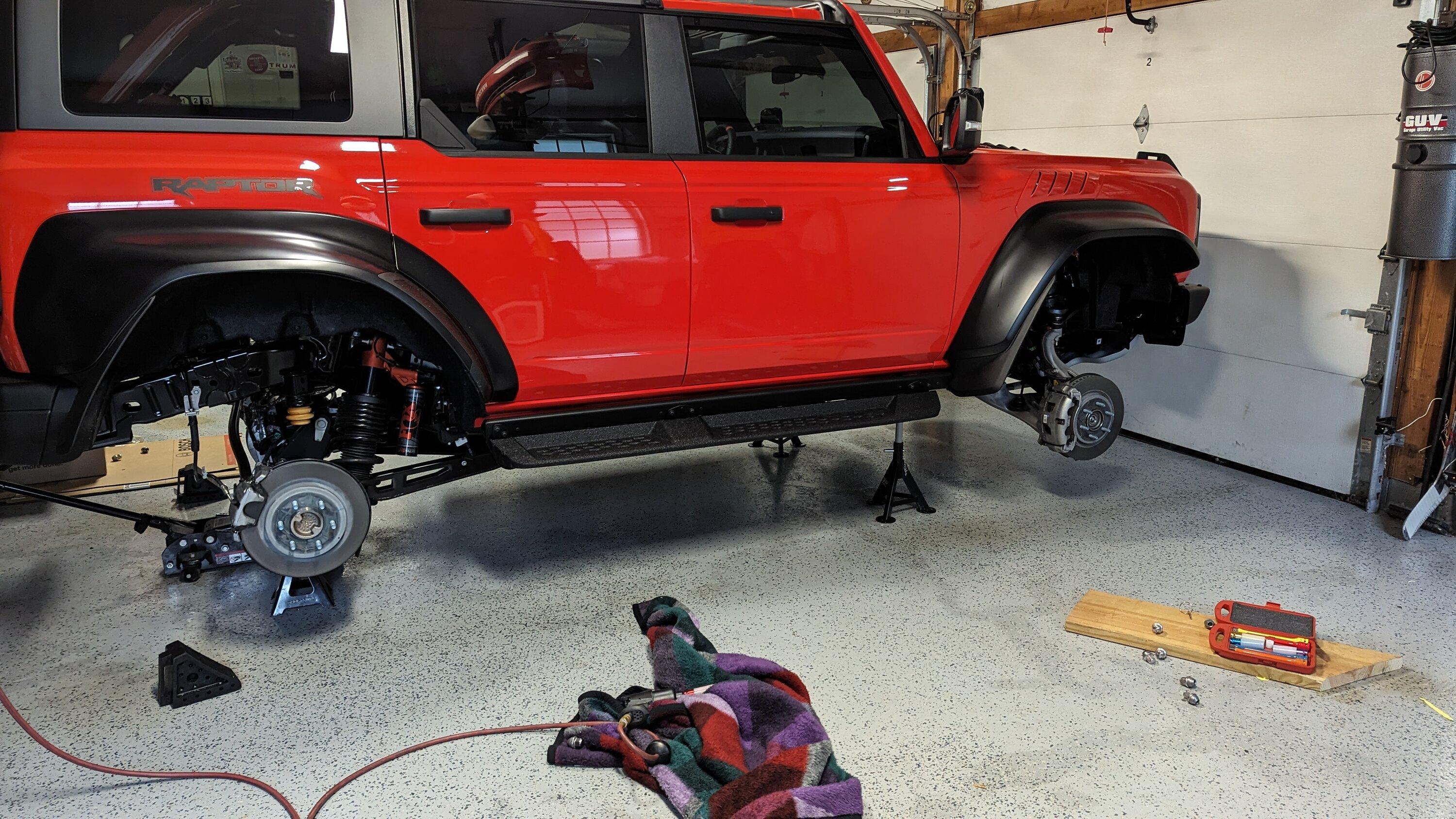

I used my factory scissor jack and the included extension to get my Raptor up on jack stands at the front jack points on the frame so I could paint my calipers. I used my 3 ton hydraulic to lift the rear from the diff and dropped another set of jack stands under the axle tubes. Scissor worked fine. I jacked it up enough to remove the tire, then lowered it onto the stands.
What are the part numbers for the raptor jack and extension?
this would be useful if I ever upsize to 37’s
I'll take a look and drop some pics - may take me a day or 2 though
When I first looked at this photo I thought it was on the floor and it looks 6 ft tall!
Do you know if there are any differences in the jacks listed from Tacoma, Tundra, Sequoia- or are they all the same height?
There might be some variances depending on year, but the one I bought was for the following: 1996 - 2002 TOYOTA 4RUNNER
