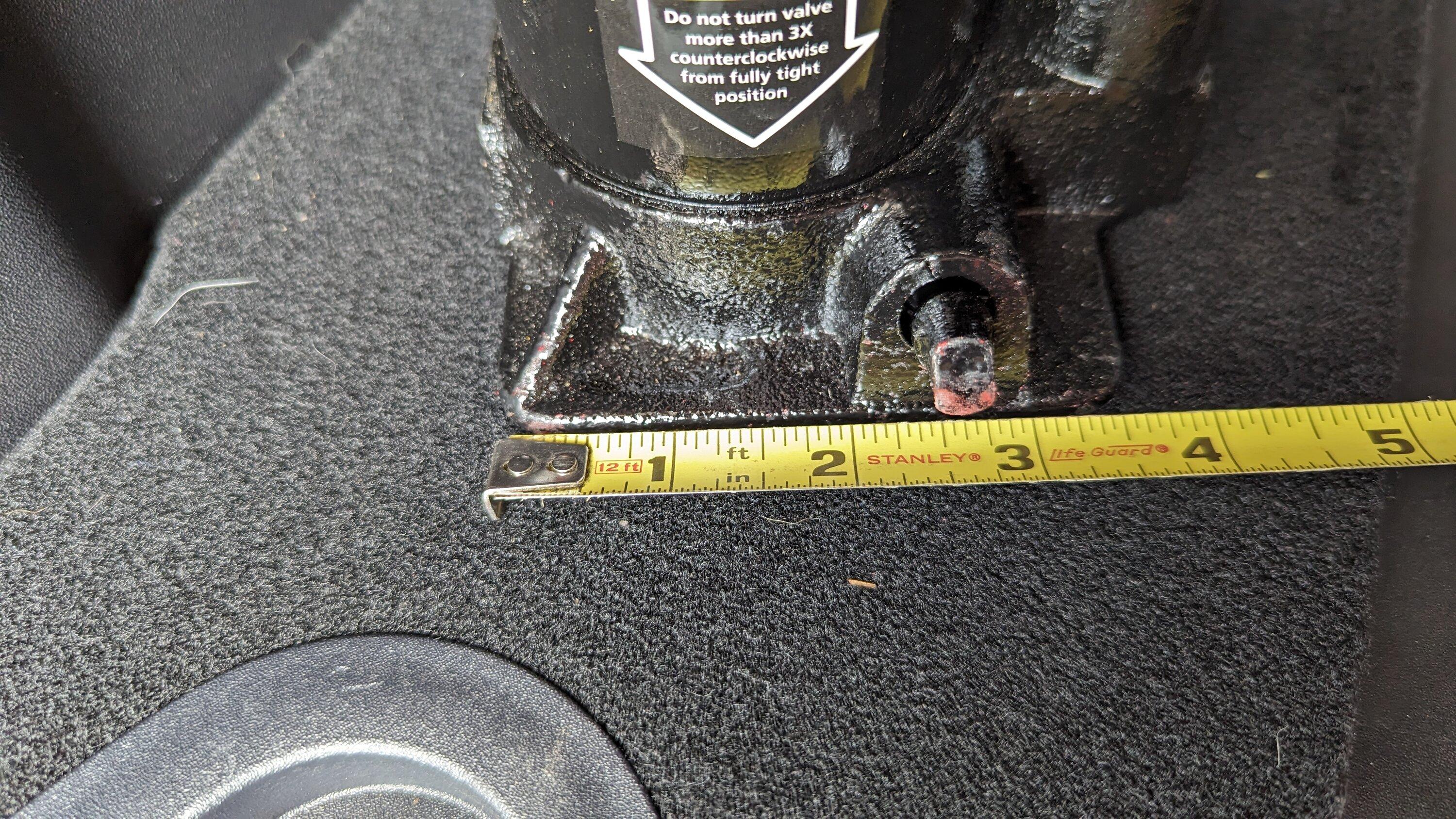

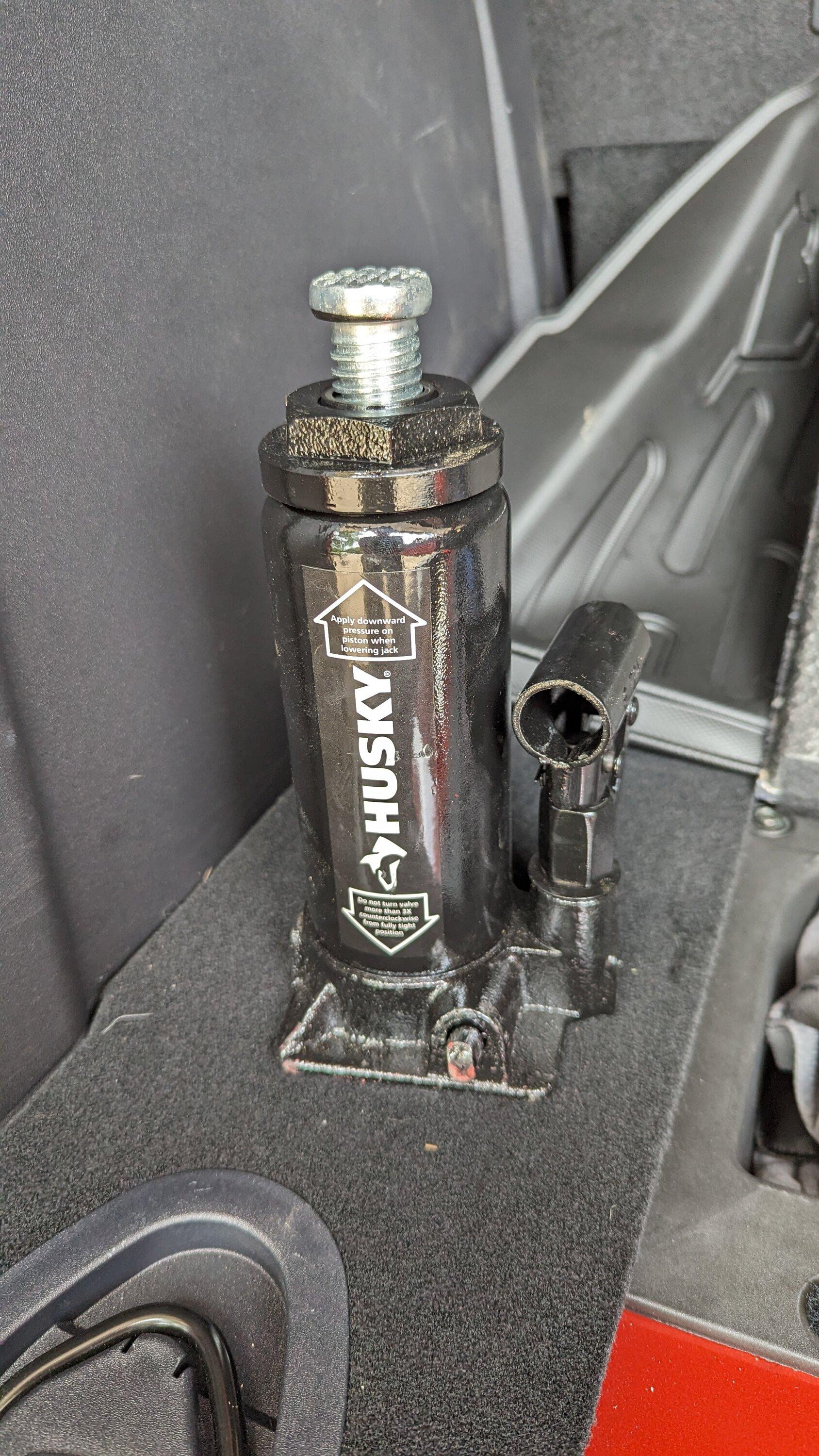

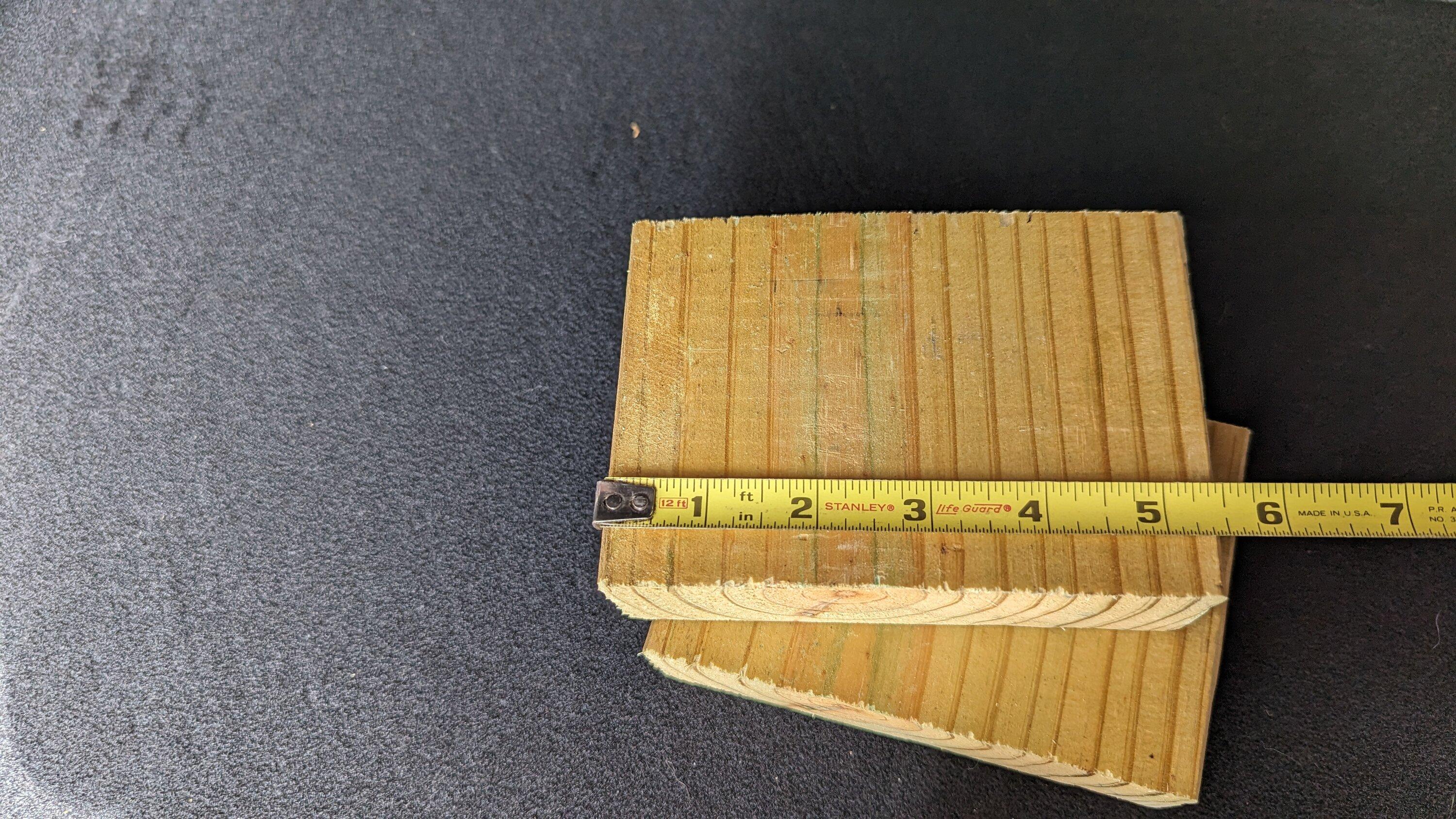

I since decided to purchase a bottle jack to replace the factory supplied scissor lift. I went with a Husky from Home Depot. Specifically, this one since it just barely squeezes in the factory location and has just enough lift to get the job done in the rear, and enough to get the job done in the front with the assistance of a couple of pieces of 2x4 to place under the jack. Yes, risky, however, better than nothing.

After ~6 months of driving I went to check on the jack and sure enough, it had leaked about 1/8 teaspoon of hydraulic fluid. Never did I suspect this would work storing it horizontally, this was just a test. It failed, and I'm back to square one.
