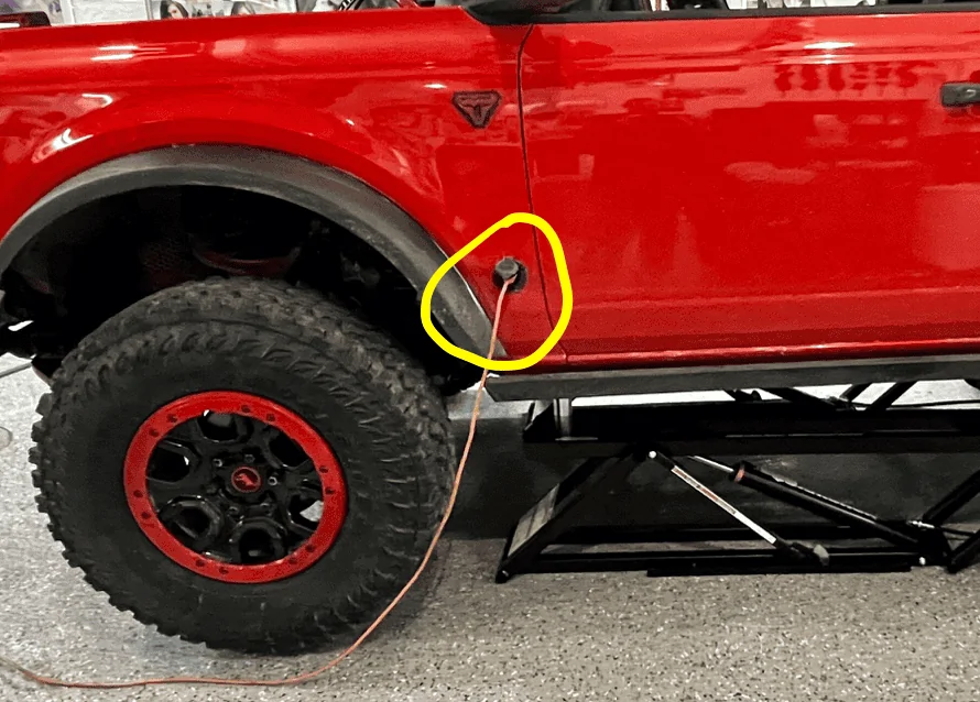

What, pray tell, is this?
Ford Bronco Does the jack lift the wheel? Screen Shot 2023-01-02 at 5.58.13 PM

Thank you.

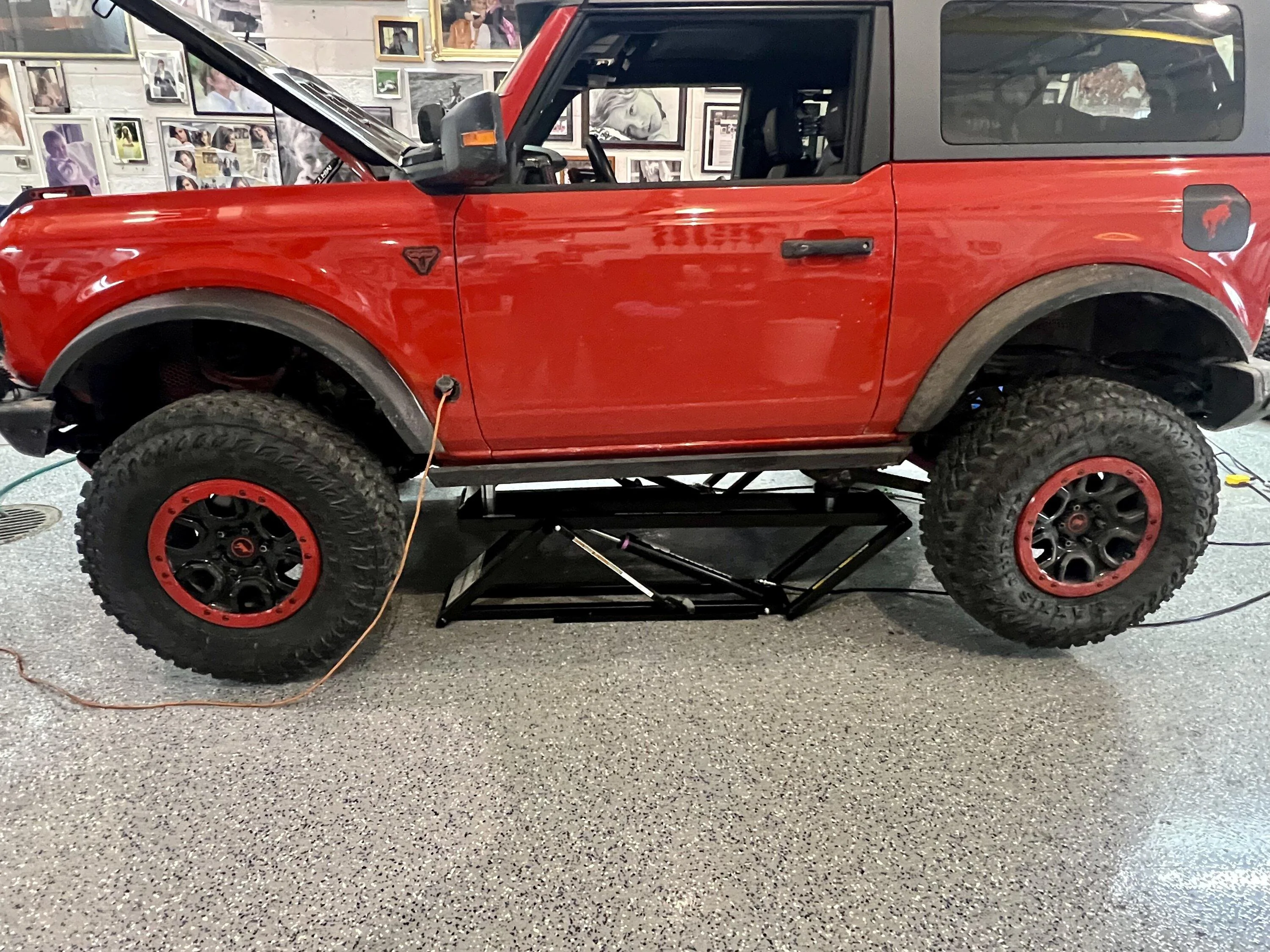

That is my 120v in for the truck. It then runs a battery maintainer under the hood and runs to the back of the truck where I have a power strip. Allows me to run everything in the truck with it off without fear of the battery going dead if plugged in. That spot was dead space.
Ford Bronco Does the jack lift the wheel? 4556BC3D-CA0A-4937-ABA6-4EF31E0AB0ED

Thank you.
Very cool. Did you do a write up for this install?

Thank you.
Do the lights turn green when fully charged?
