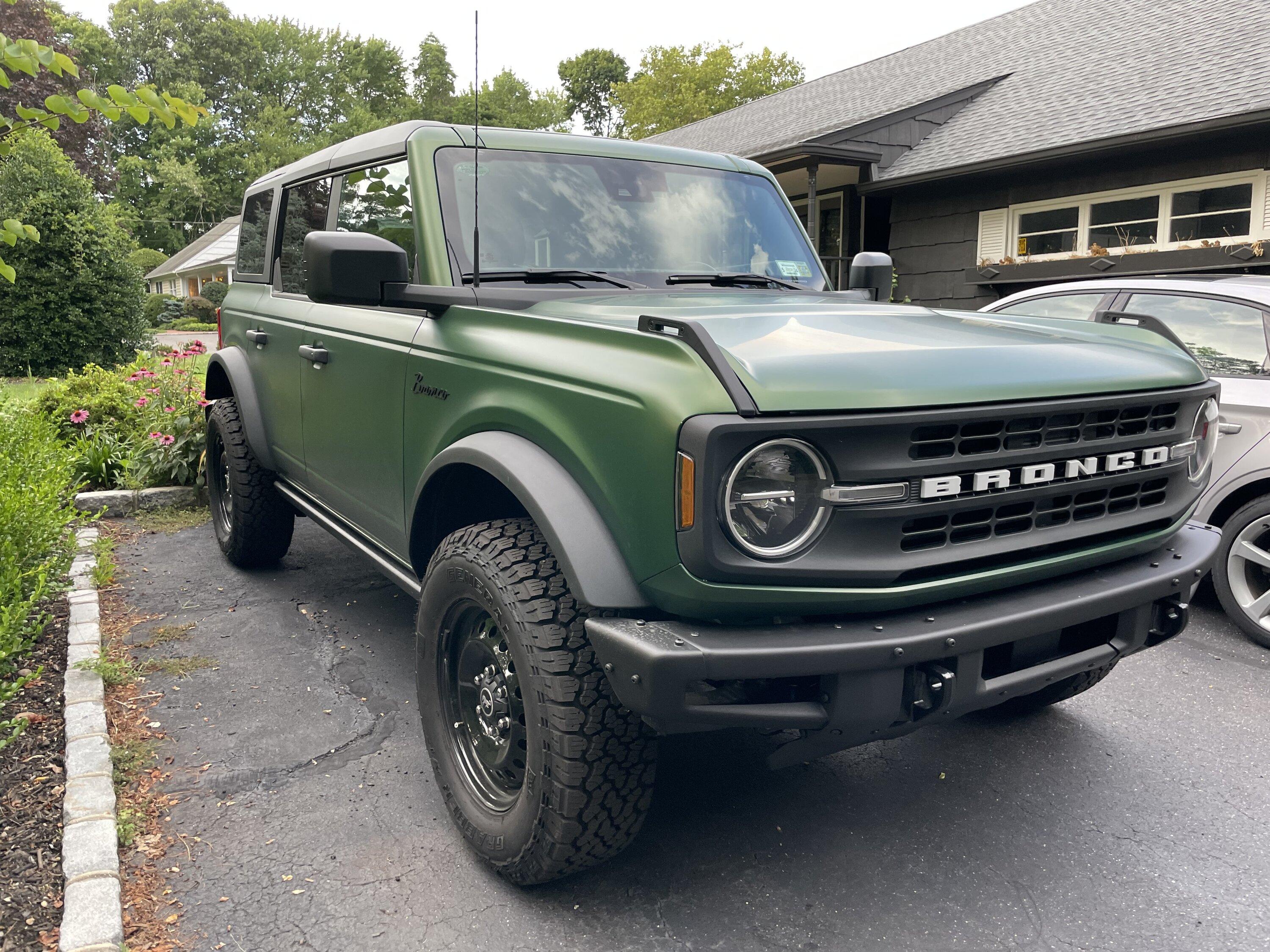

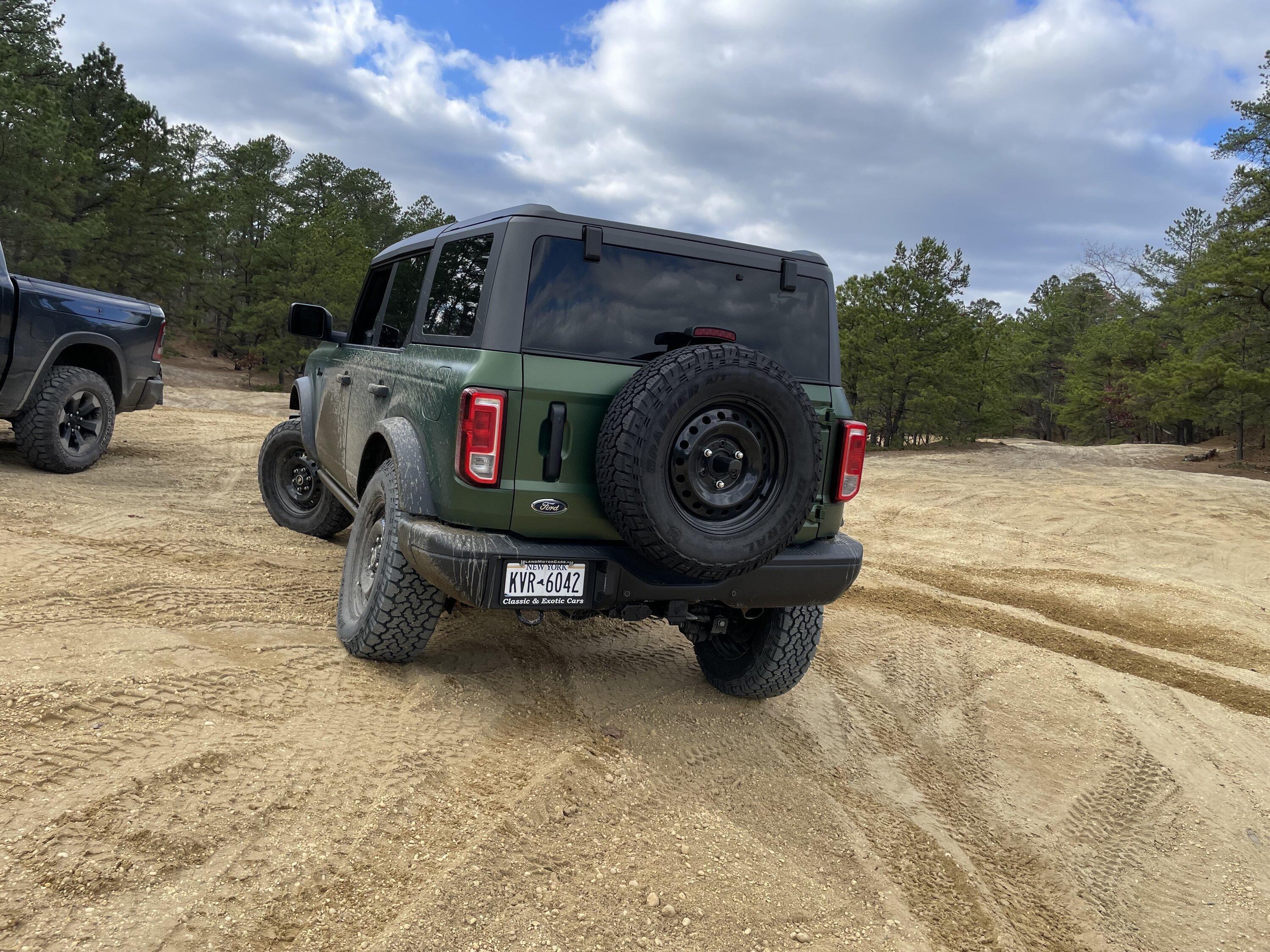

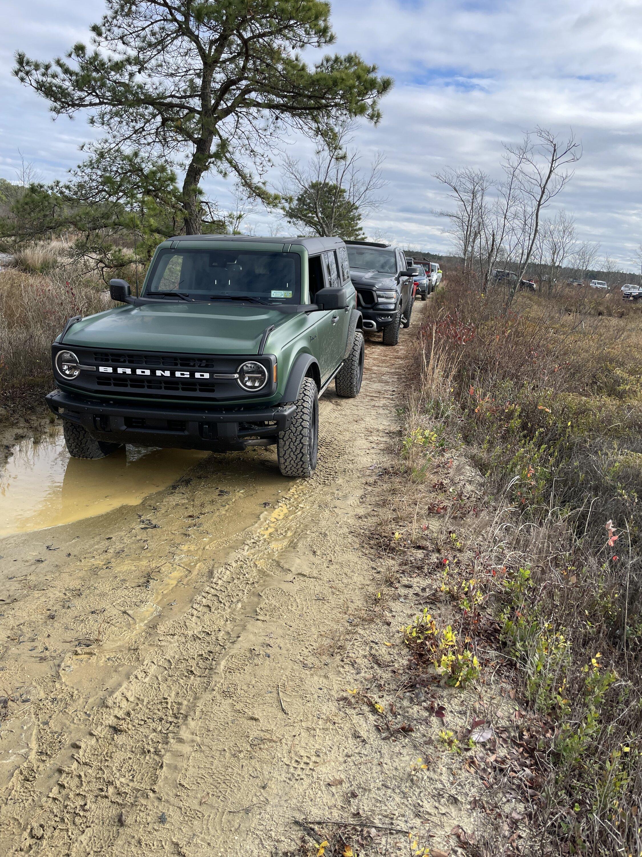

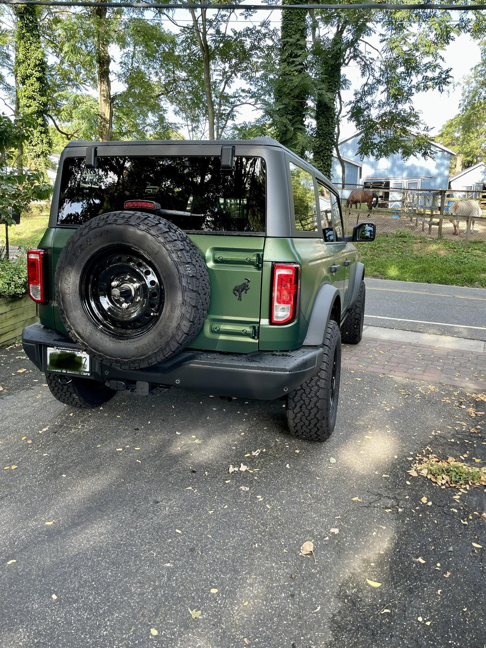

Did you ever swap to 1.4in? I'm curious about what your experience was. I've got the same wheels.
Thanks
1.4 was out of stock at the time, so I ended up getting a set of 1.25 Bora branded spacers and they fit perfect. Very happy with them.

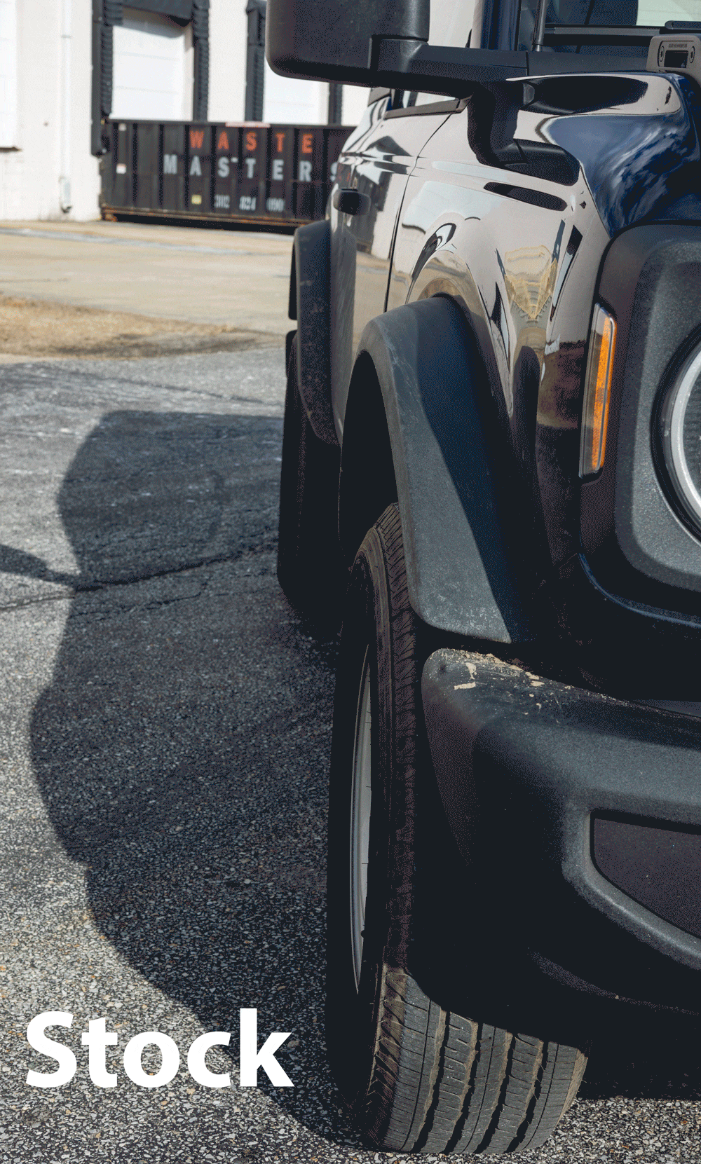

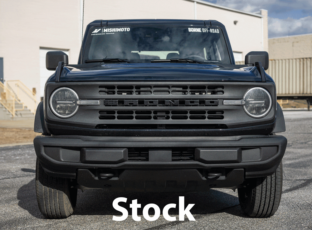

Hey Guys!
I spent some time yesterday with our 2.3L base to create some visuals on our wheel spacers! We installed a set of our 1" and 2" spacers with the base steel wheels:
Ford Bronco {thread} {filename}
Don't hesitate to reach out with any questions that you might have!

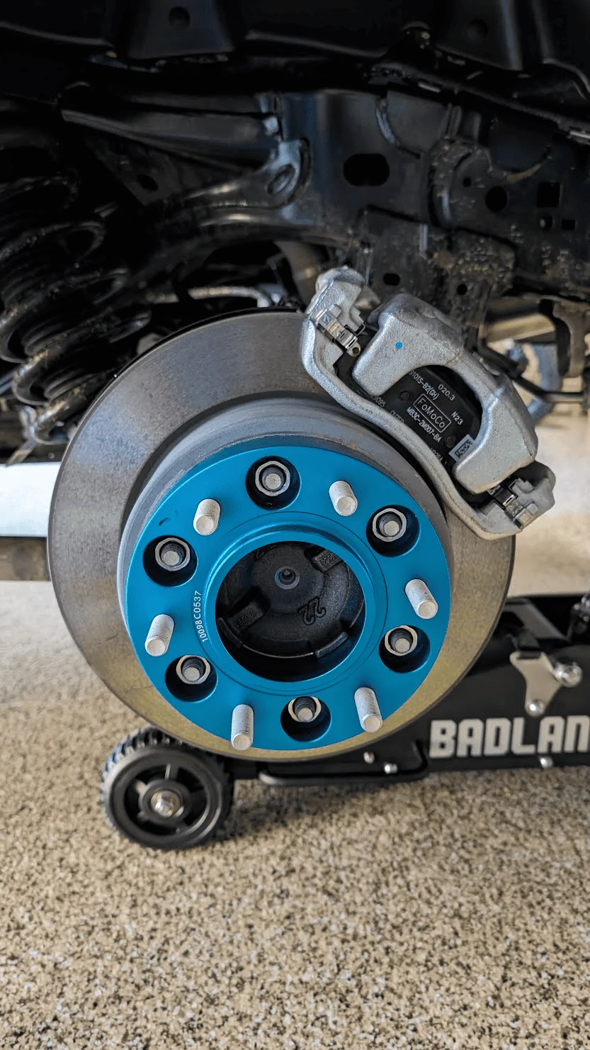

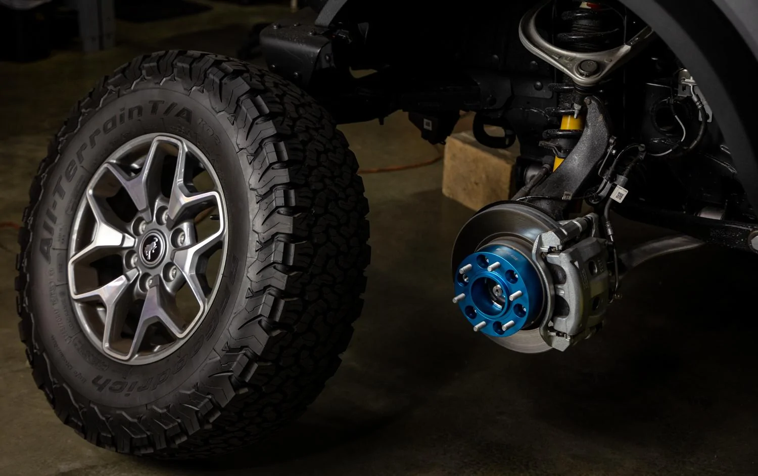

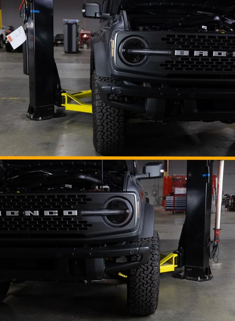

Hey Gang!
Nick here from Borne Off-Road! I just wanted to kick off this thread with some exciting news that we have a solid selection of wheel spacers available for the 6th Gen Broncos! Make sure that you head over to our Engineering Blog for some more insight on wheel spacers and our design:
FINDING SPACE – BORNE OFF-ROAD WHEEL SPACERS
Here's a quick look at the difference with our 2" (50mm) spacer installed on our Badlands:
Make sure that you also head over to our website to pick up a set today!
Borne Off-Road Wheel Spacers, fits 2021+ Ford Bronco 2.3L/2.7L
As always, don't hesitate to read out with any questions that you might have!
-Nick

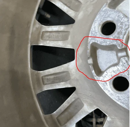

Hey @Migo - It depends. You may need to shave down the studs a little, but that's only if the wheels do not have a pocket on the back side between the mounting holes (pictured below).
Hope this helps!
-Josh

Thank you! My Methods do have a shallow recessed area between the holes. They look different than the picture (and maybe not as deep) but I think they will work. Fingers crossed!

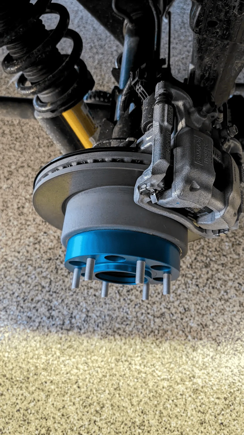

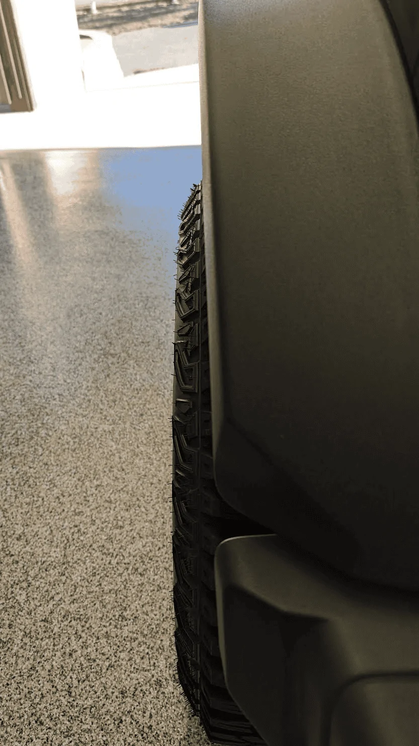

installed these (1.4")on my stock badsquatch and all is good. I had the stickerfab front mudflaps and after install, the passenger side tire rubbed on the mudflap at full lock. i replaced them with the IAG mini flaps and now plenty of clearance.

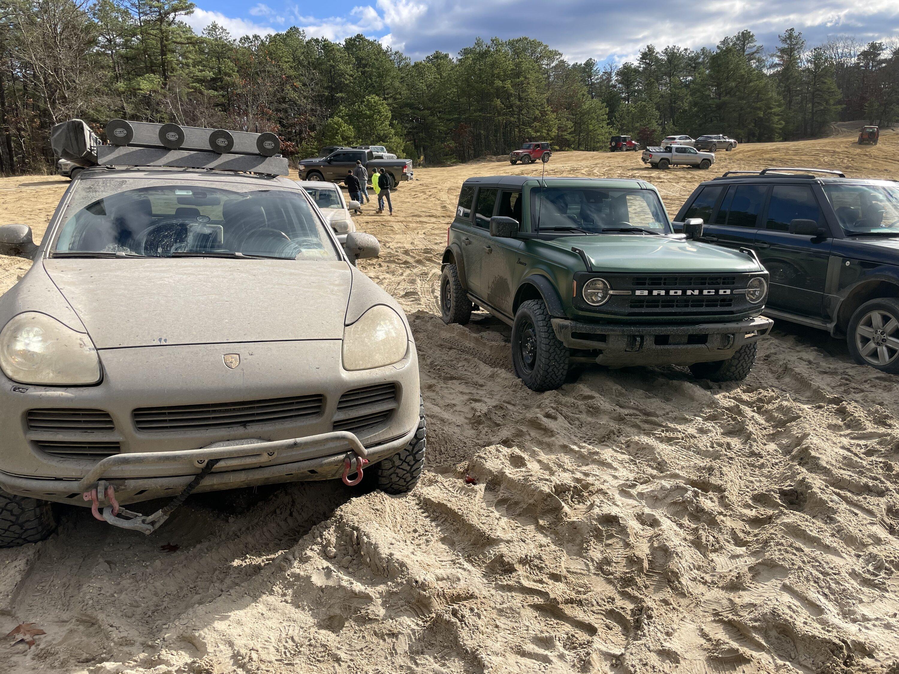

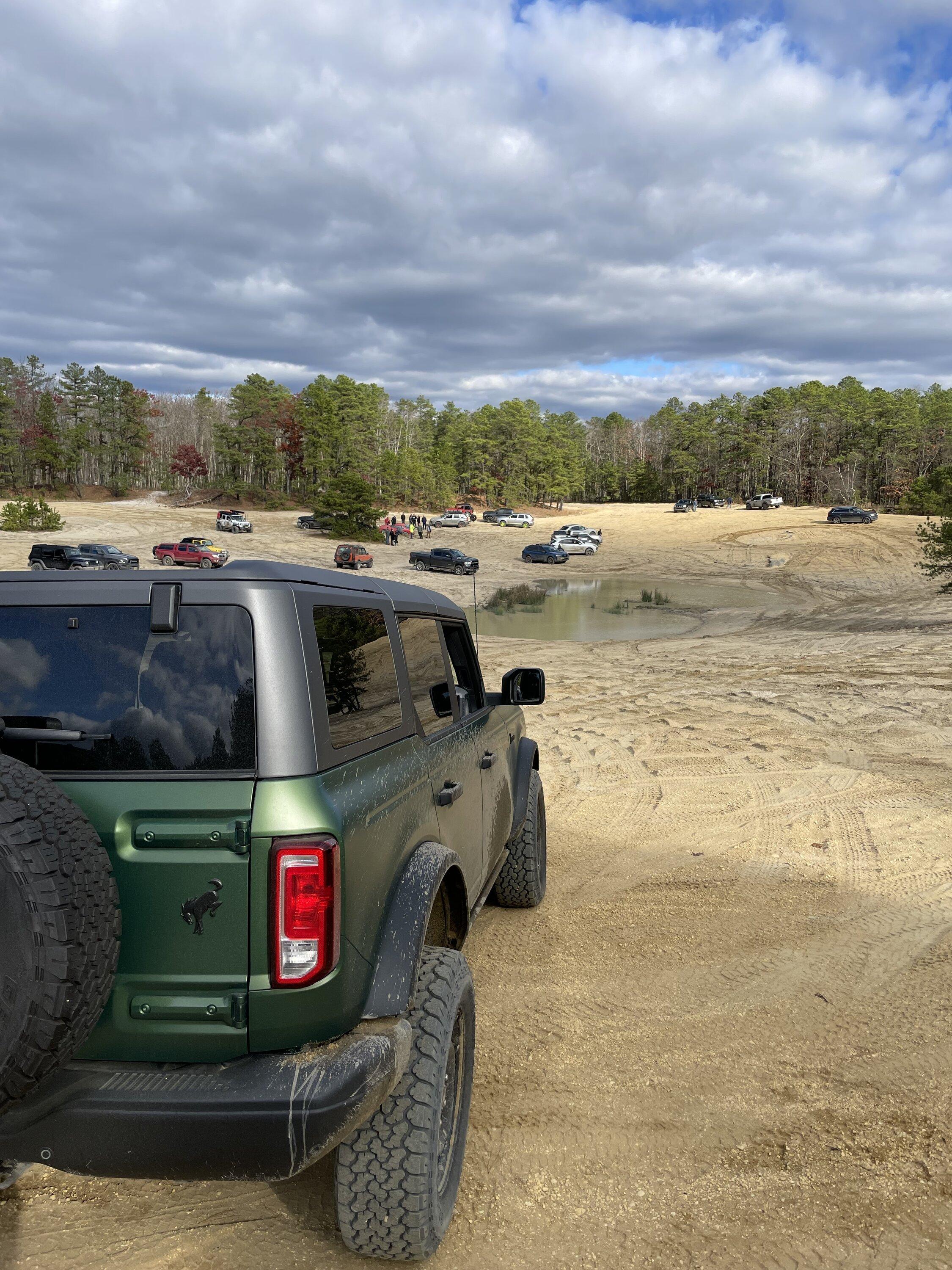

stance after install:

Installed the 1.2” spacers today and had zero issues with fitment on the Method 703’s. They look great, although I have a tinge of regret not going a touch wider. I suppose my CV joints will thank me!
