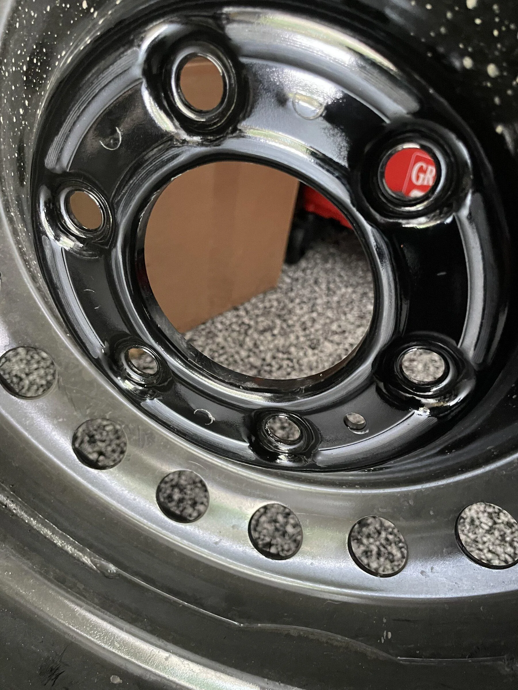

Just a heads up, 1in will not fit on oem black diamond steelie wheels without trimming studs. Fronts almost fit, rears need probably 1/4in of trimming. I’m going to be swapping out for 1.4in since I do not want to trim.
Did you ever swap to 1.4in? I'm curious about what your experience was. I've got the same wheels.
Thanks
