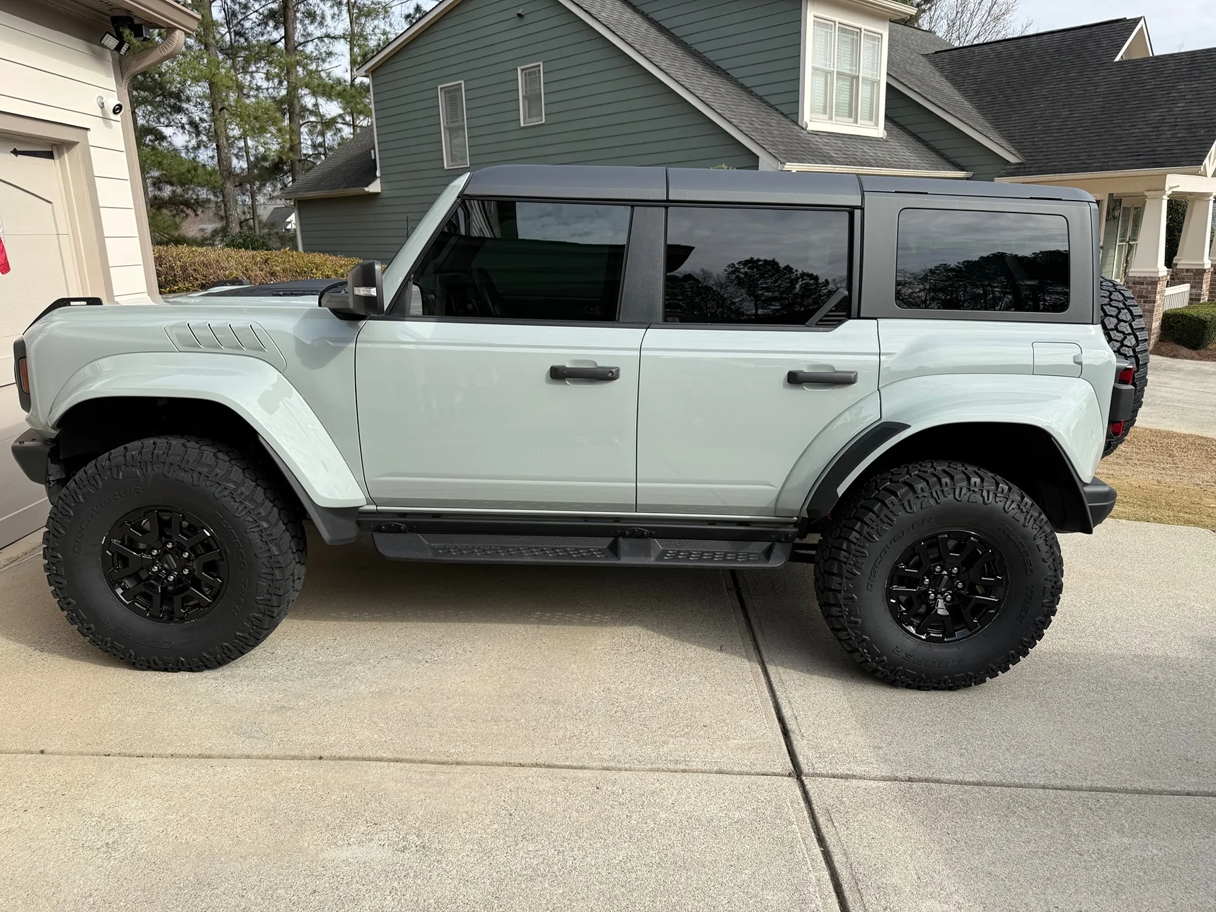

Need advice on tires other than BFG- I am just not impressed with the BFG’s inability to stay balanced. According to the Michelin rep at my dealer (Akins) this is a common and “known” problem with the K02 on the Raptor, so I’ve decided to replace them.
Note that I’m not a huge off roader, I’d say 5% or less of my driving and when i do go off road, it’s driving through trails at parks, in north GA, nothing crazy. In addition to running around the suburbs, I do a fair amount of road trips/highway driving.
I’m looking for a direct replacement, something that performs decently off road and has good on-road manners from a ride quality perspective.
Appreciate any recommendations!
