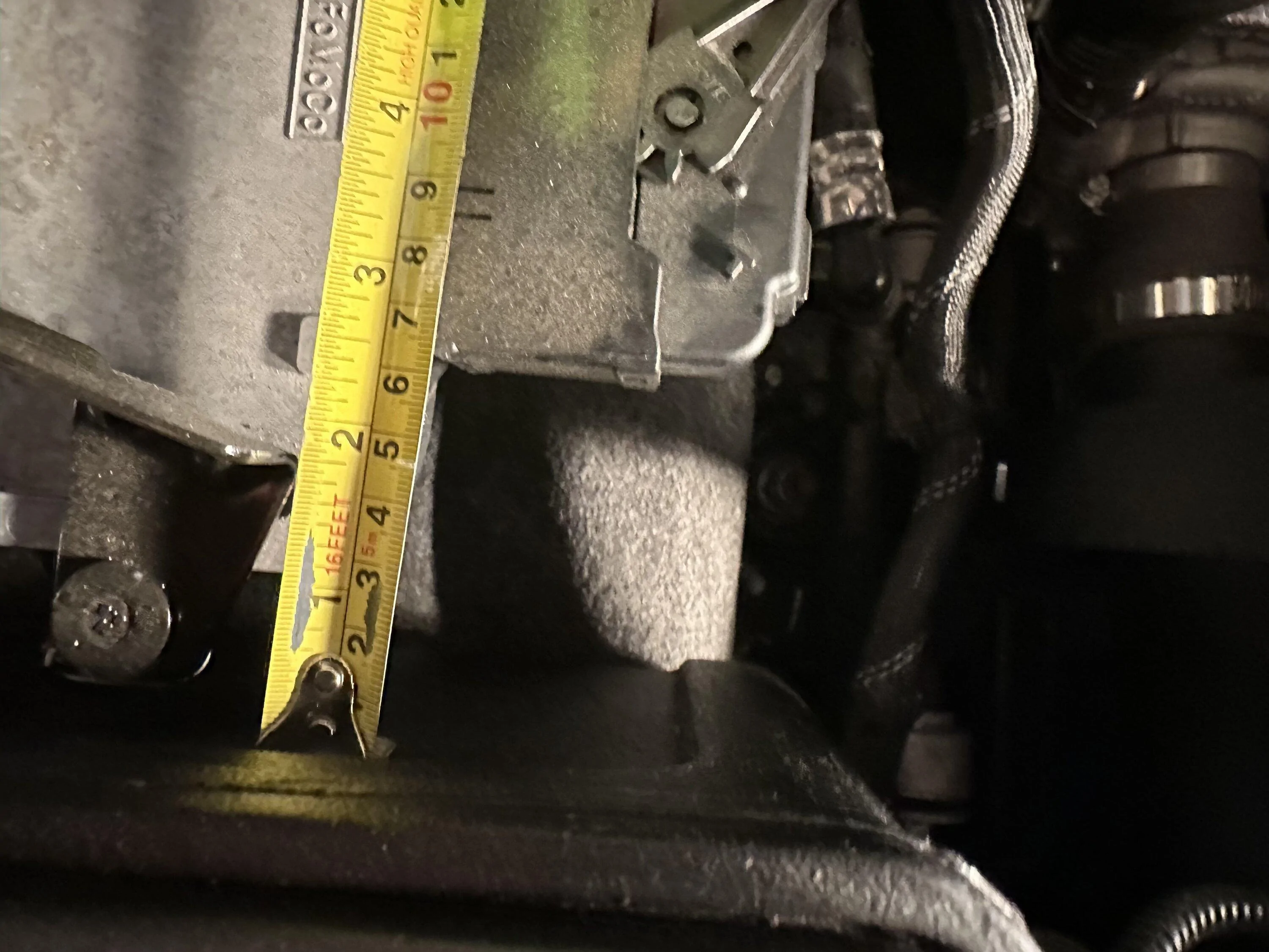

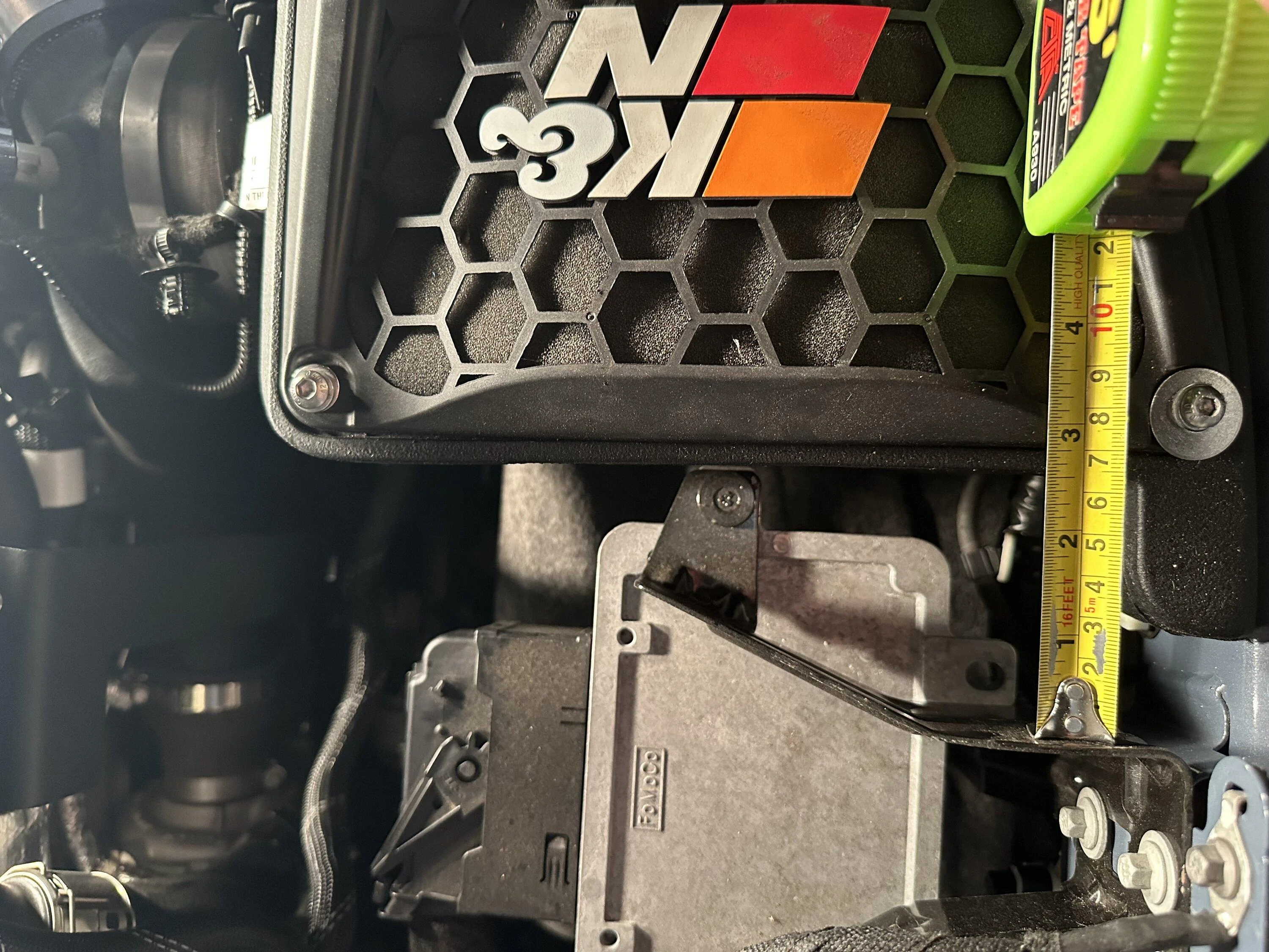

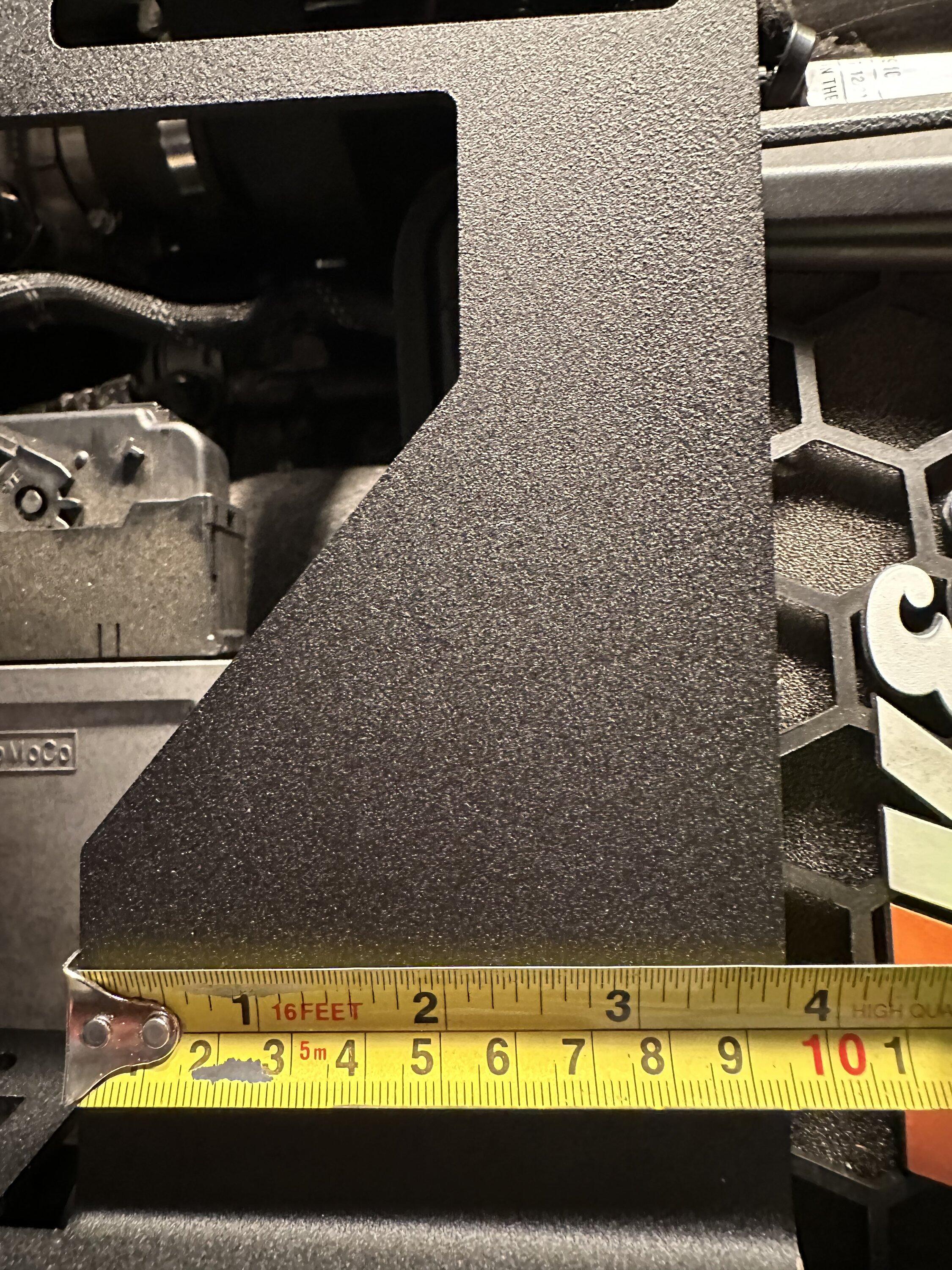

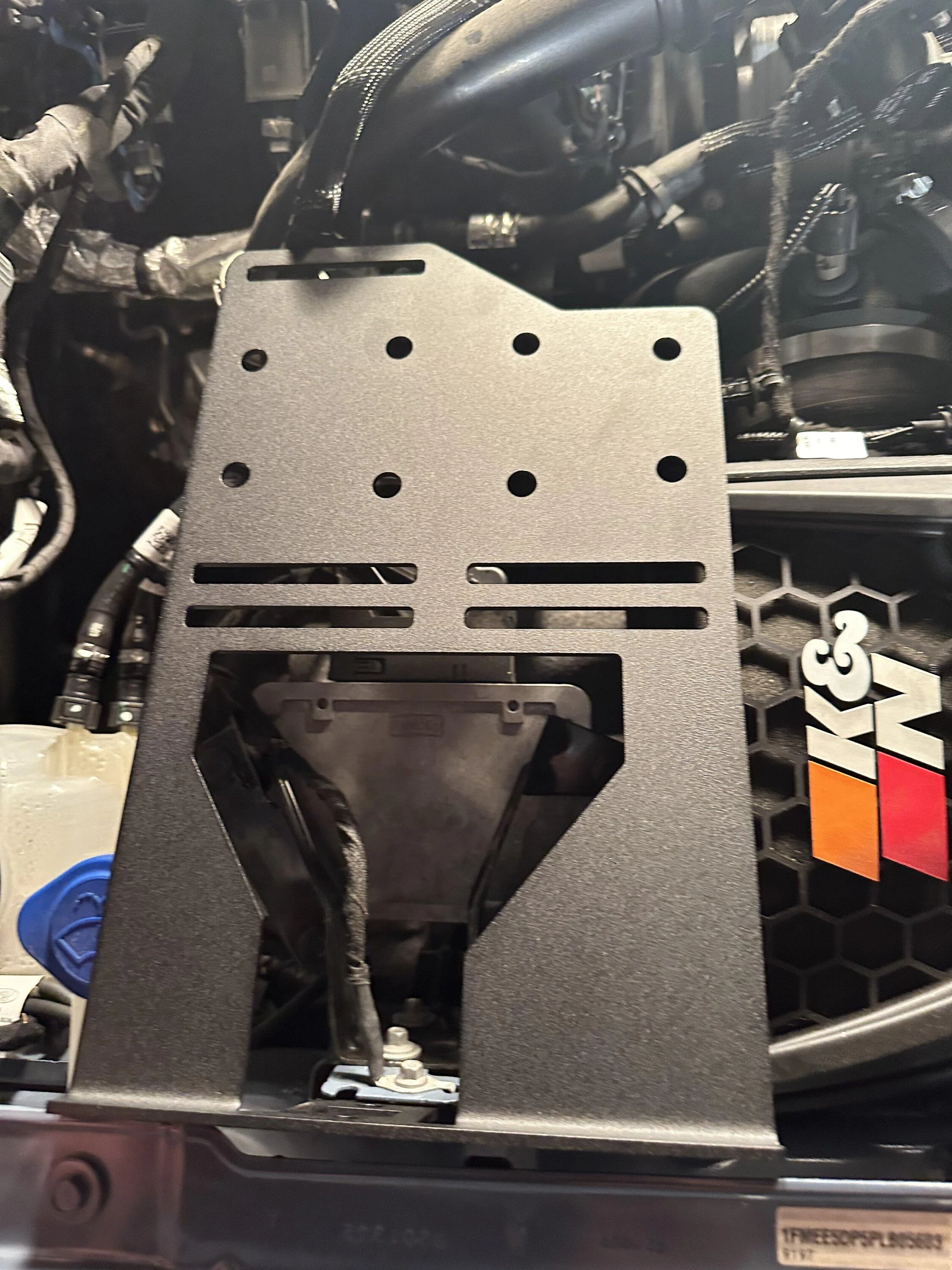

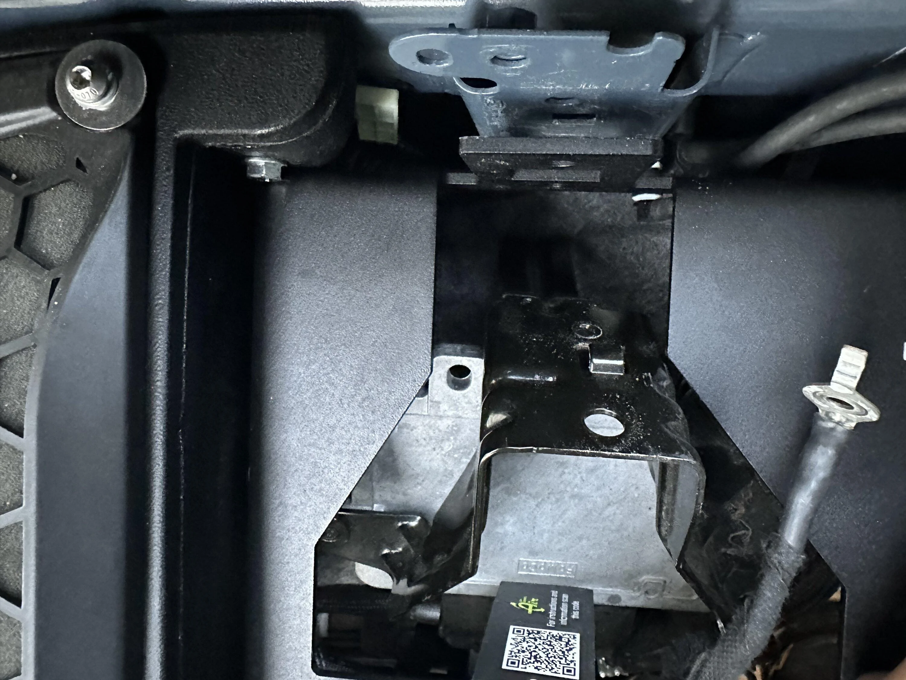

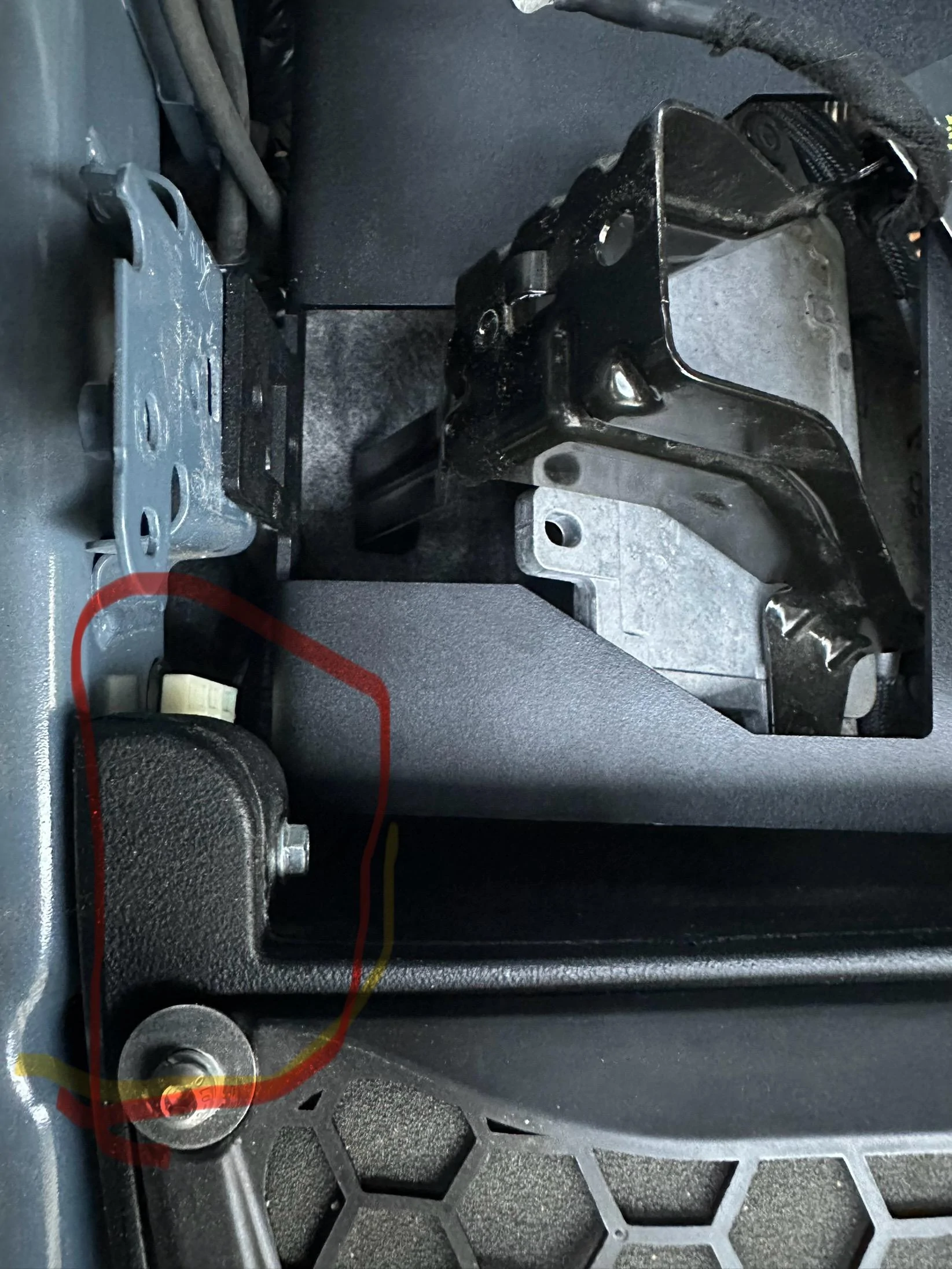

Help me please, I just got your kit today. I have a K&N CAI and before I ordered it I was told there had not been any reported issues with this. Well I didn’t get very far. I am not sure it would even clear the rigid turbo pipes. I am screwed and sad :(
What can we do?

you have it upside down … flip the bracket around

After we went back/forth with Gotchaa via email/messaging we ended up ordering a K&N Filter to test fit in or shop truck. So the K&N bolting spot gets in the way of the compressor. Customers who had ran this combo in the past never told us there was an issue. They just stated it fit. But what we learned was these customers modified the bolt a bit to make it work.
We've since re-designed our brackets to allow for the compressor kits to work with the K&N filters and maybe some others. However we JUST received a fresh batch of brackets from powder coating with our older design. So we won't see the NEW design till the end of the year when we do another production run.
BUT we took feedback and made modifications.
