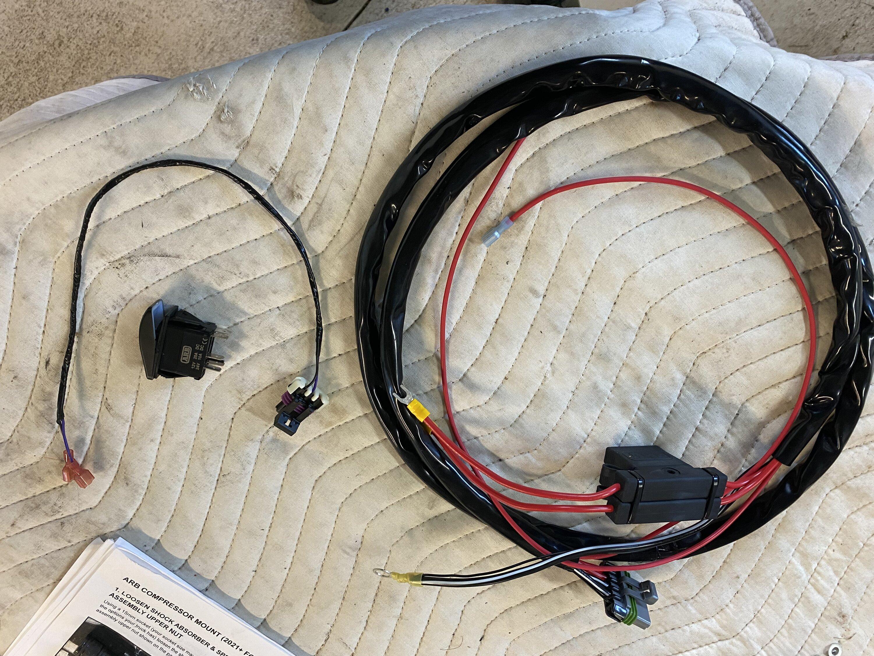

Pictured below is all the wiring that is needed for a Very clean install. I like the Switch mounted close to the Compressor as well. This way you do not have to use an AUX switch inside.
The Purple and Black wires with Plug are from the ARB Harness that comes with the Compressor. You only need about maybe 1 1/2 - 2 feet of it. I added an additional Red wire to the Main Power Harness that goes to the Fuse box via Fuse Tap. Cut to length and terminate and these 3 wires plug into the switch.

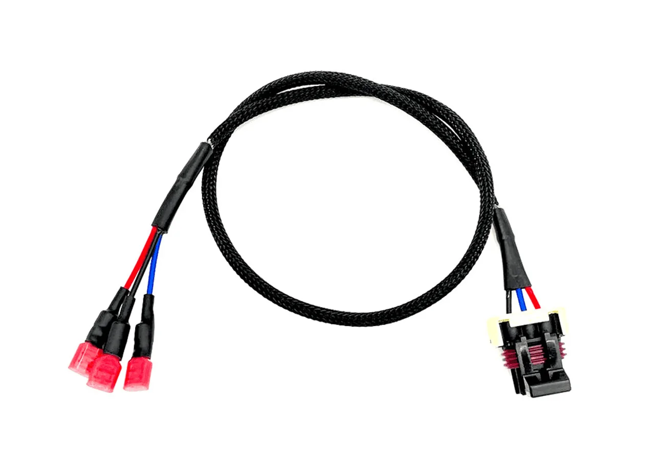

We have a new harness/pigtail for the switches. No need to run a power line for the switch anymore. Plugs into the back of the switch and into the compressor. That's it, nice and easy. It's something we started including about 1-2 weeks ago

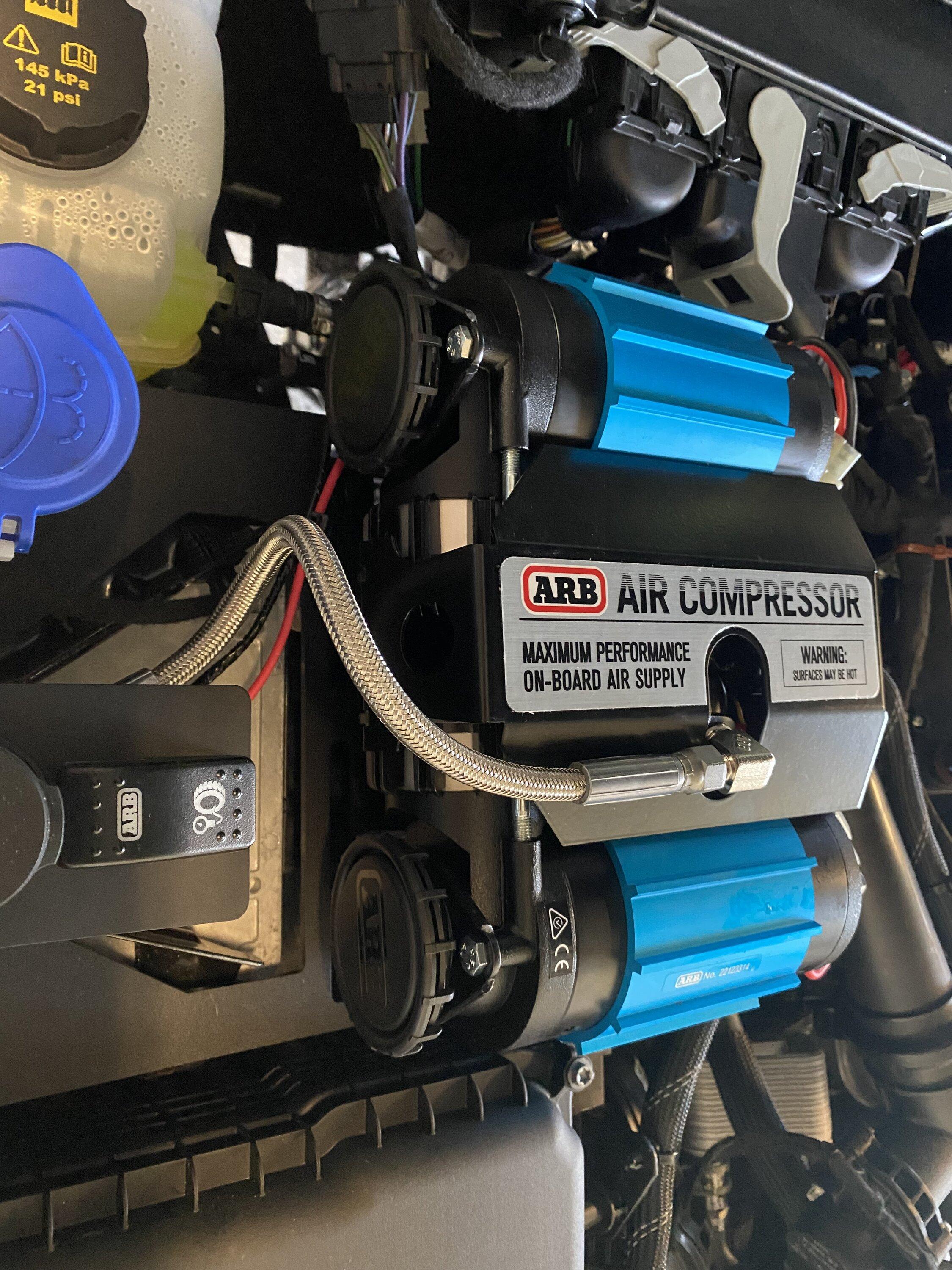

I did the dual compressor kit from 4x4TruckLeds.com to mount in the engine bay. I read lots of threads, talked with multiple folks at events and decided on this for a few of reasons.
I'm new to car mods and installs - so something I could do and be comfortable doing was important. Running heavy gauge wire to another area of the vehicle if not mounted in the engine bay was not really an option.
The horizontal mounting bracket options (there are a few on the market) were appealing to me so that I didn't have to relocate the PCM module. The compressor vibrates a lot when operating - perhaps not much more than extreme roads without moving it anyway - but I was compelled enough to not introduce that risk and keep the PCM mounted just as it came from Ford and not add the vibrations of being on the same plate as the compressor.
When I compared installation options for the various horizontal engine bay brackets, I went with the KR mount because of where the support arm mounts. It is a contact point that is easily accessible - both for the original install, as well as any maintenance or visual check.
And I'm 5' tall - so in addition to the KR kit, I also added the KR bracket and relocation fittings to move the switch and air coupler to the very side of the engine bay. I have hood struts as well - which makes it easy and convenient along with this access location for me to air up.
I'll add that I also have the uplifter switches, but I opted to wire the compressor independent of them. I didn't want/need to be going into the vehicle to turn off/on the compressor. Anything I'm doing with the compressor will already have me in the engine bay to access the coupler - so it made sense to me to not give-up an uplifter switch or not have the switch near the compressor coupler.
