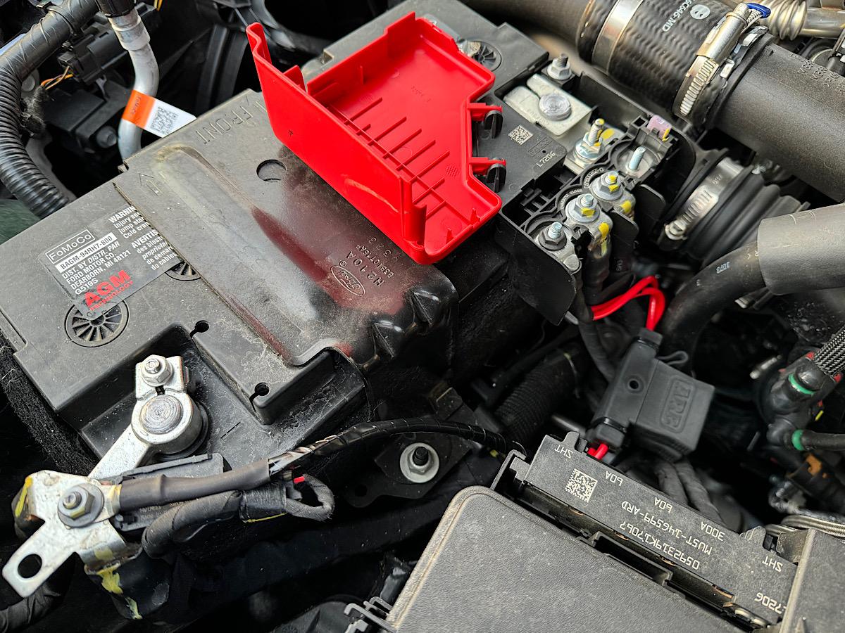

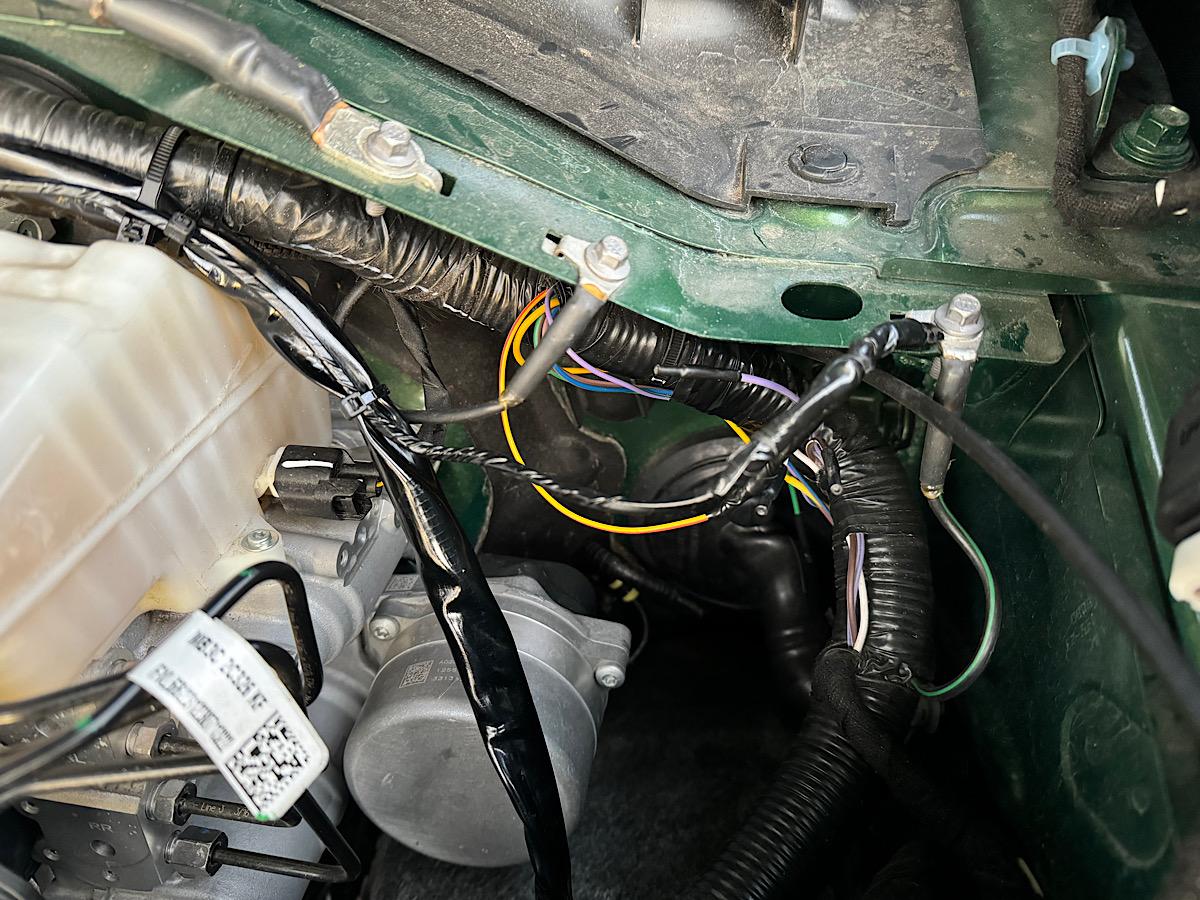

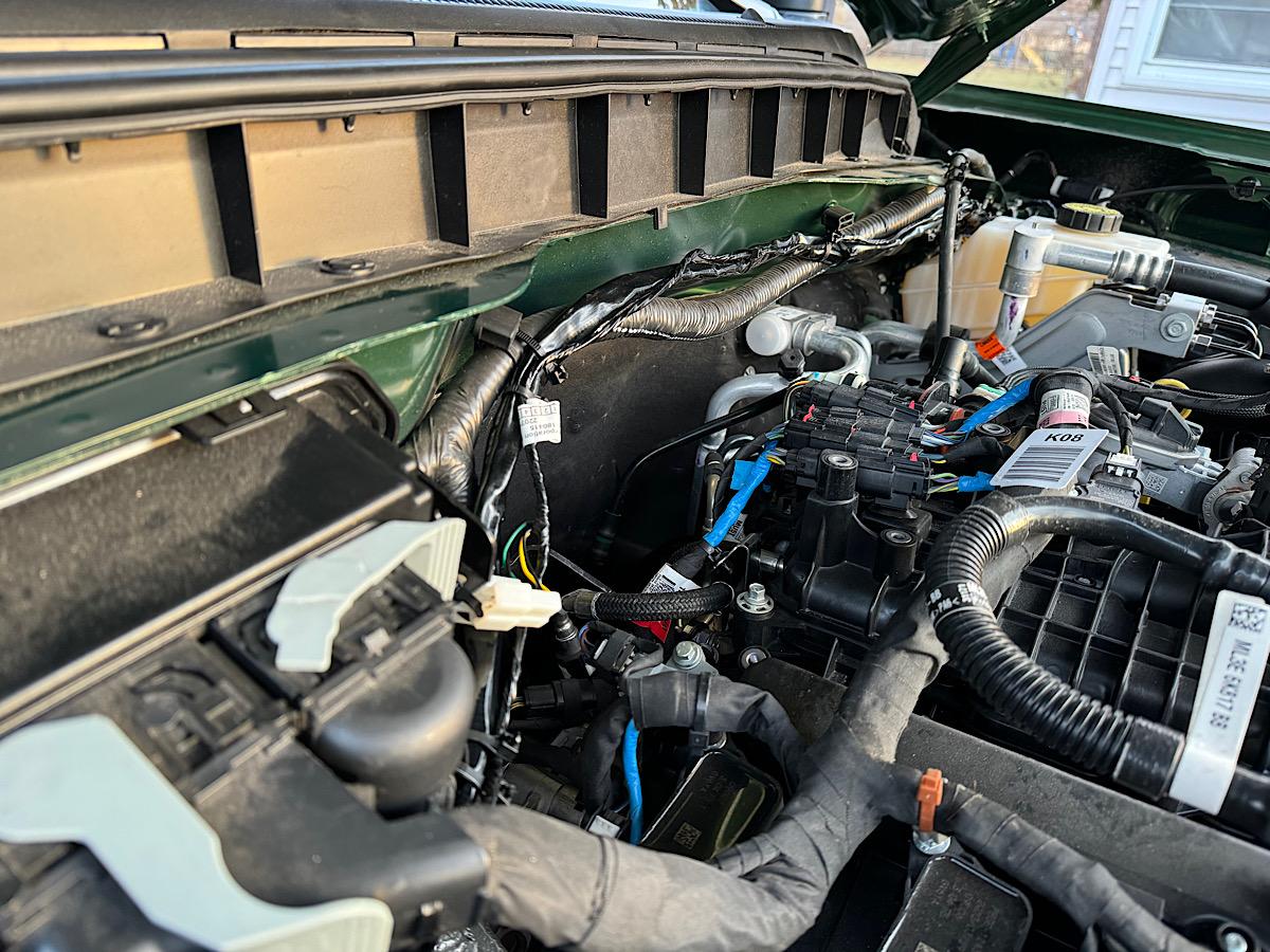

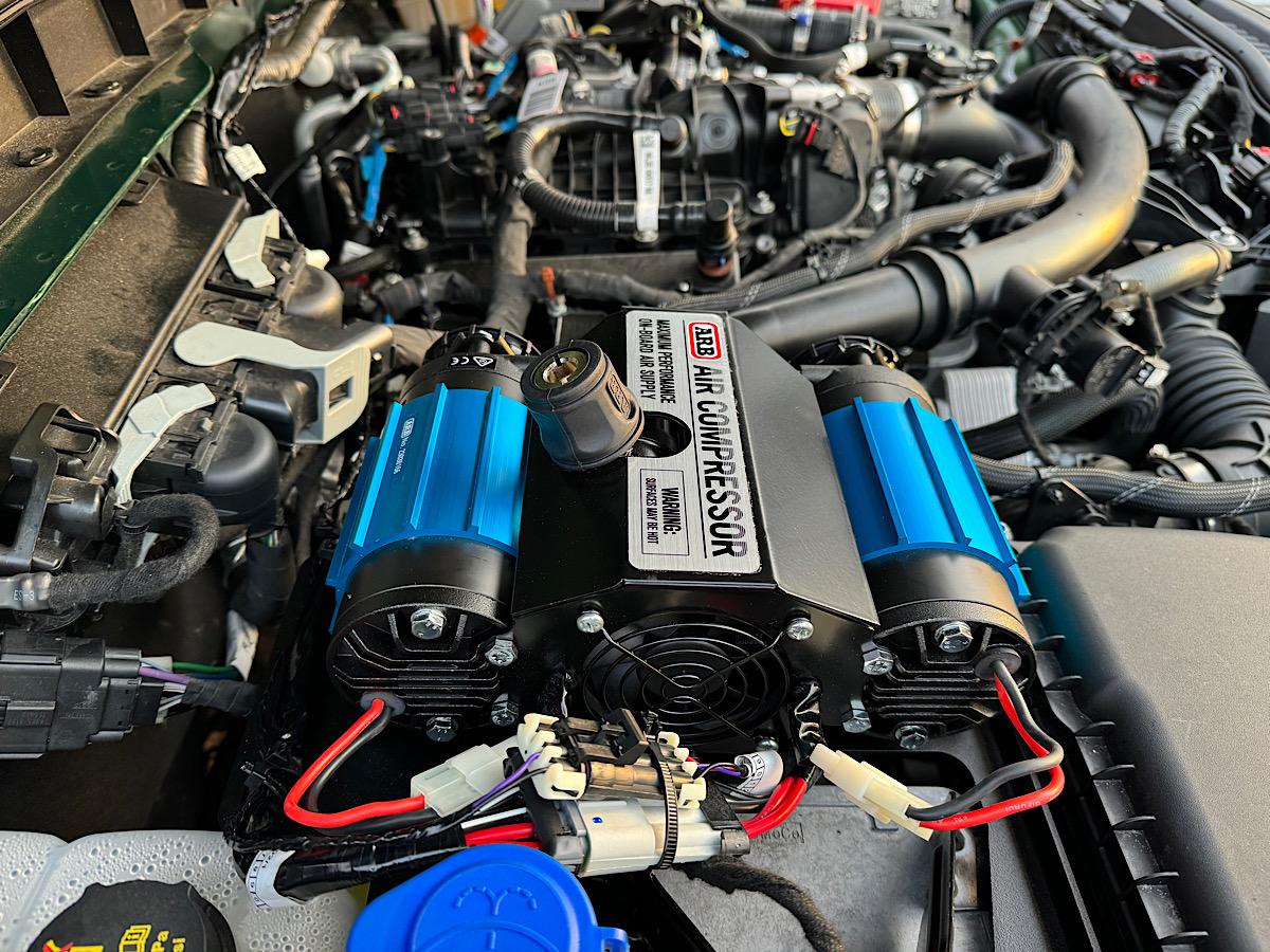

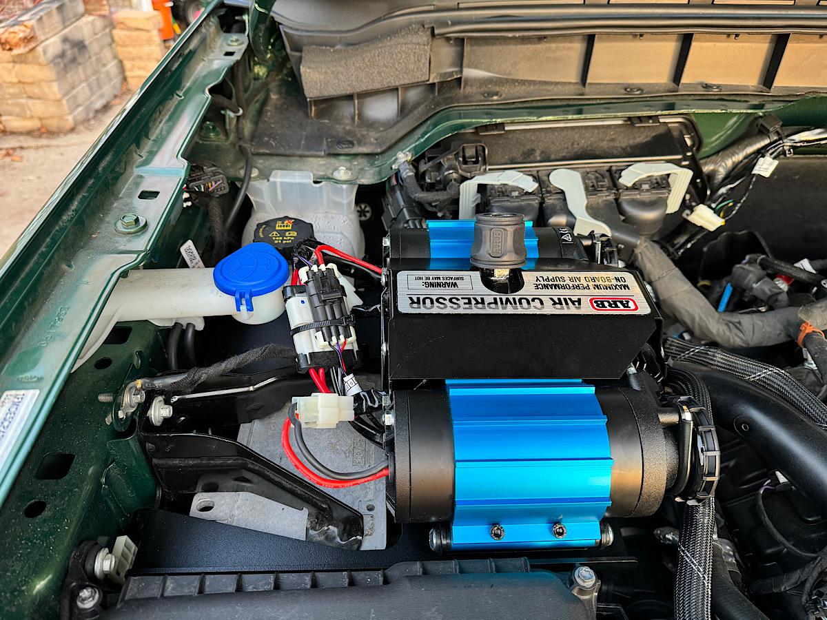

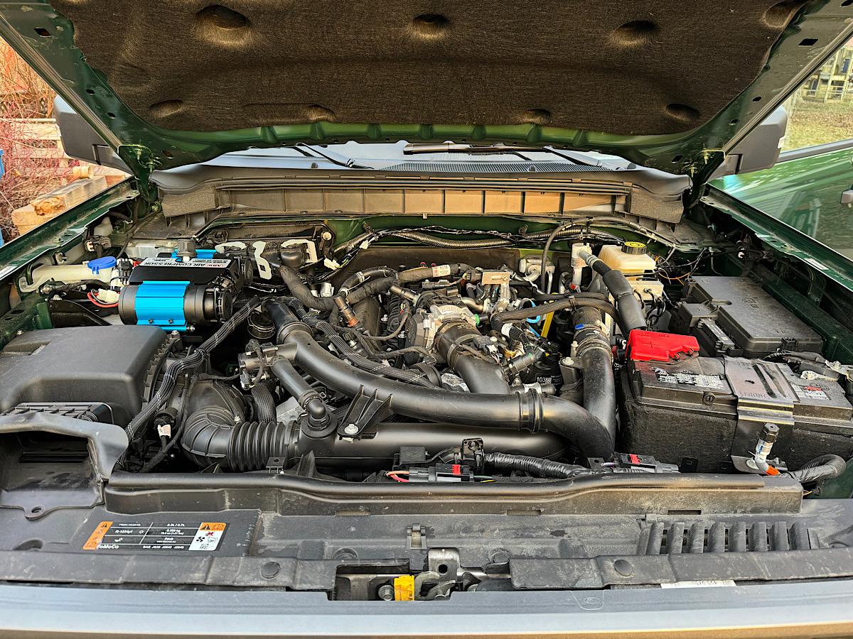

Got some nice weather here in MN. Decided to finally install the ARB with the Barnes bracket. Their instructions aren't the greatest, but I figured it out. Watched some various Youtube videos to figure out the wiring. I wanted to use one of the Aux switches, so Chase Gentry's video was the most helpful in that sense.

Very straight forward install. Just take your time. I’d pre-assemble everything first (main bracket, leg brace, compressor) if I did it again. There were a couple blind bolts that were tricky.
Then the wiring part again just need patience and think your routing through ahead of time. I wired into the Aux switch which imo makes it easier than having an extra switch under hood which you need to run power to and ARBs instructions are shit for that.
