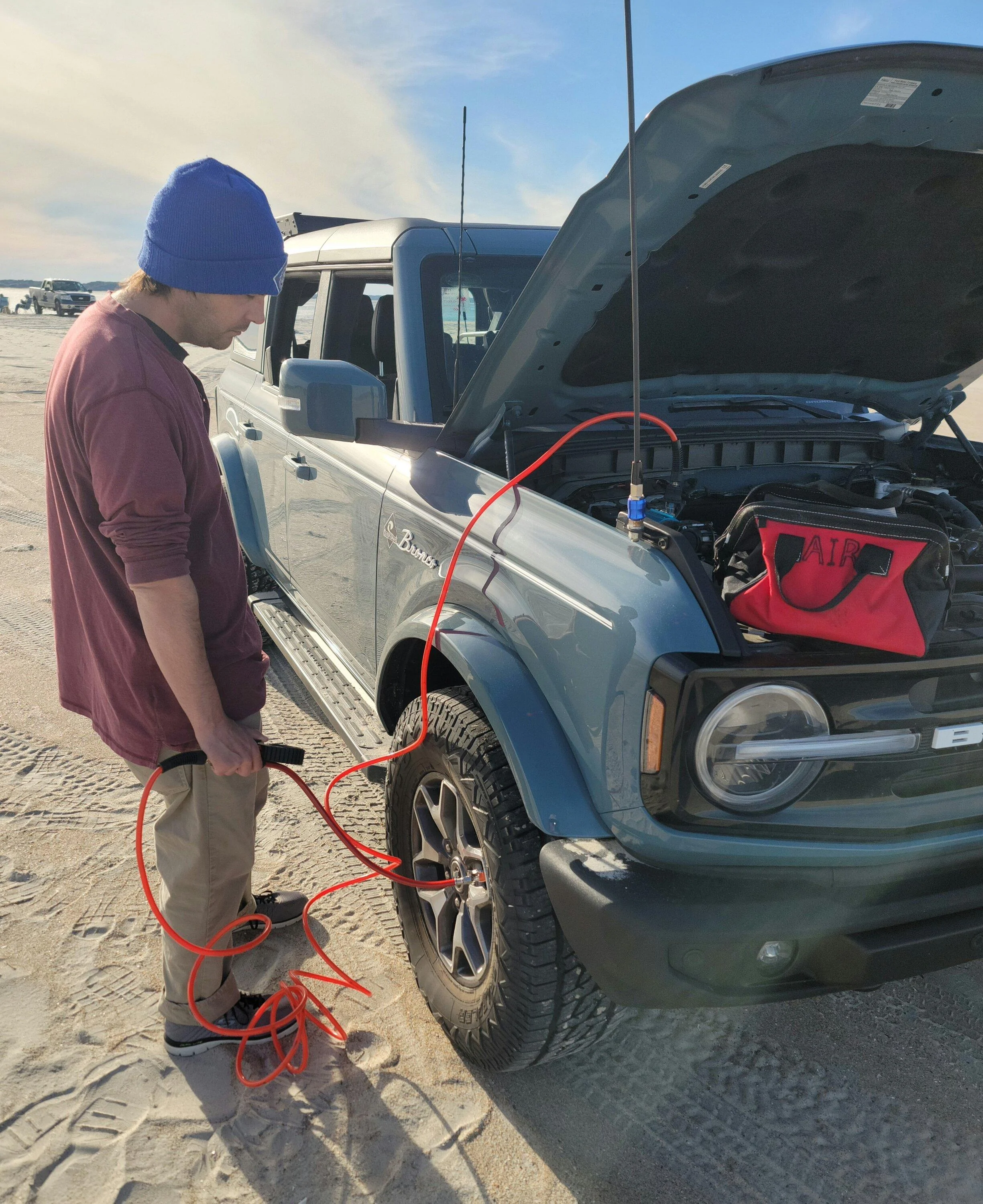

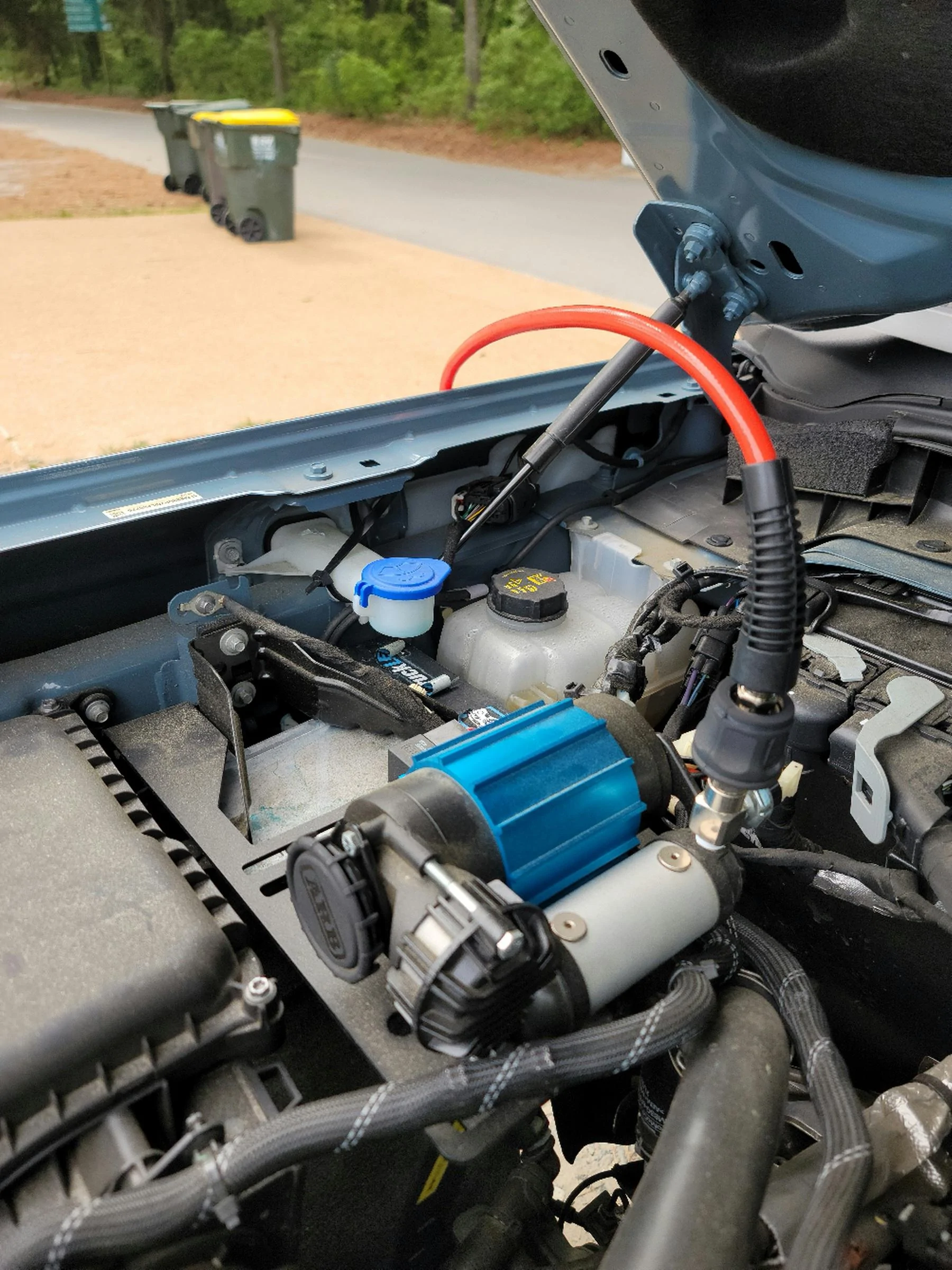

Is there a best bracket? I used the KR/4x4 Led Bracket. I'm no mechanic, and it was difficult for me to use the bolts at the top of the shock mount, its a long way down, so I wouldn't call it easy. I bought the ARB single, since i run 33" tires, but it turns out that the wiring of the single (also used the upfitter switch) is more complicated than wiring the double ARB. I installed the bracket and the pump myself, and then brought the Bronco to my local 4Wheel Parts store, and they did both the electric wiring and the air connections. Beautiful harness job, we went straight clock time, 2 hours for $250. Im very pleased with my set-up. I did not understand how the relays and switches were wired, so I know my limits.
I think that you have to decide the best bracket for your use. These are expensive, so dont let price guide you, it may be that you get what you pay for, and who hasn't cheaped out and regretted it later? KR was first to market, it works for me, there are others. Just don't mount an air pump inside the car! If you have family members when you go off-roading, if they like to wait in the car while you air up the tires, too noisey!

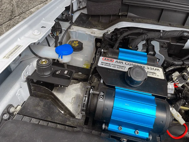

Yeah you'll want to use an extension to get to the strut bolt. It's pretty straight forward of an installation if you have a good socket set (since you need the extension).
The twin is a LOT easier to install. We actually charge extra to install a single (an extra hour) since it takes longer with the wiring. The twin though is pretty straight forward as far as wiring to an upfitter. Or if you don't have upfitters we make a switch panel as well (a lot of customers get this just to free up an upfitter)
Our bracket IS expensive but it's a world of difference then the others. We actually use stainless steel which is very expensive BUT it lasts the life of your truck. And we have a lifetime warranty on our products.
The switch kit is here for those interested, it works with our bracket: https://www.4x4truckleds.com/kr-off...-coupler-switch-bracket-for-2021-ford-bronco/
Ford Bronco Best on-board air compressor mount 1691601829807
(Old prototype photo, which is why you don't see the air line going to my compressor but you get the idea)
