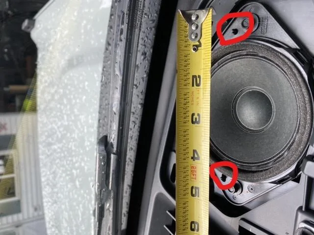

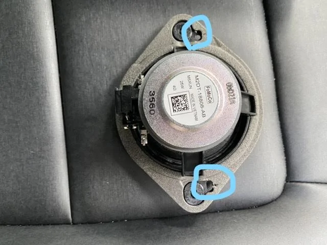

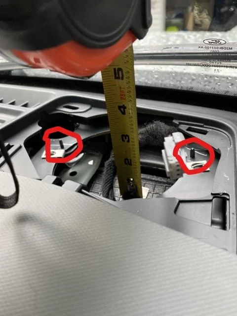

There are 2 locating pins for the factory speakers and thru holes on the the speakers themselves .... my replacement speakers dont have the thru holes ..... what did you guys do about this?

Cut them off with a pair of side cutters or similar.
