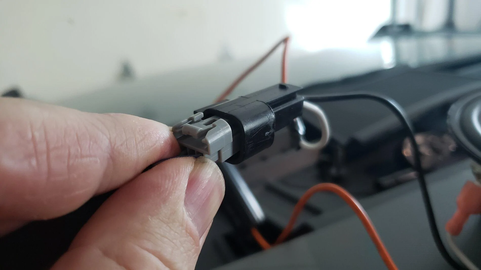

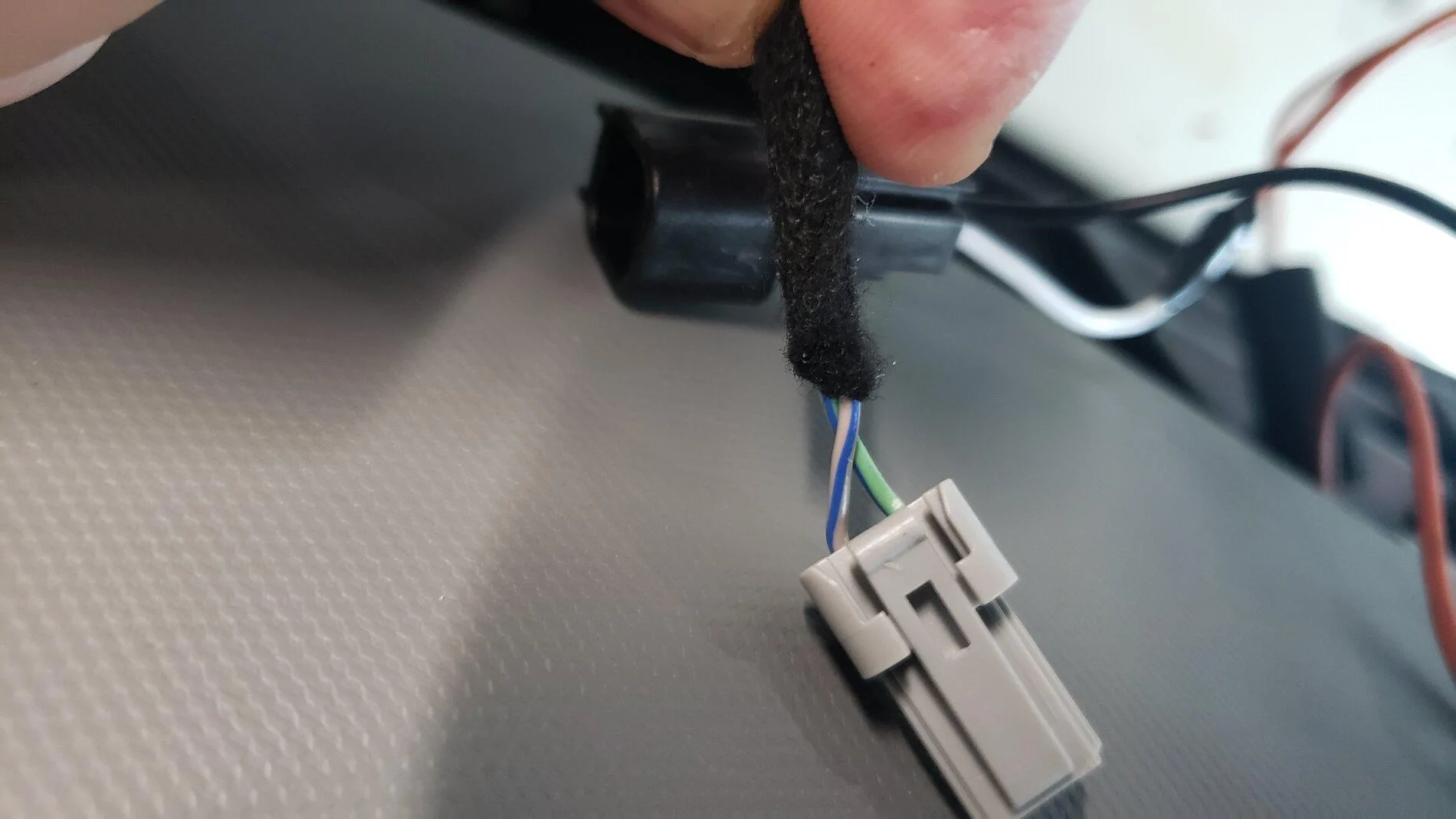

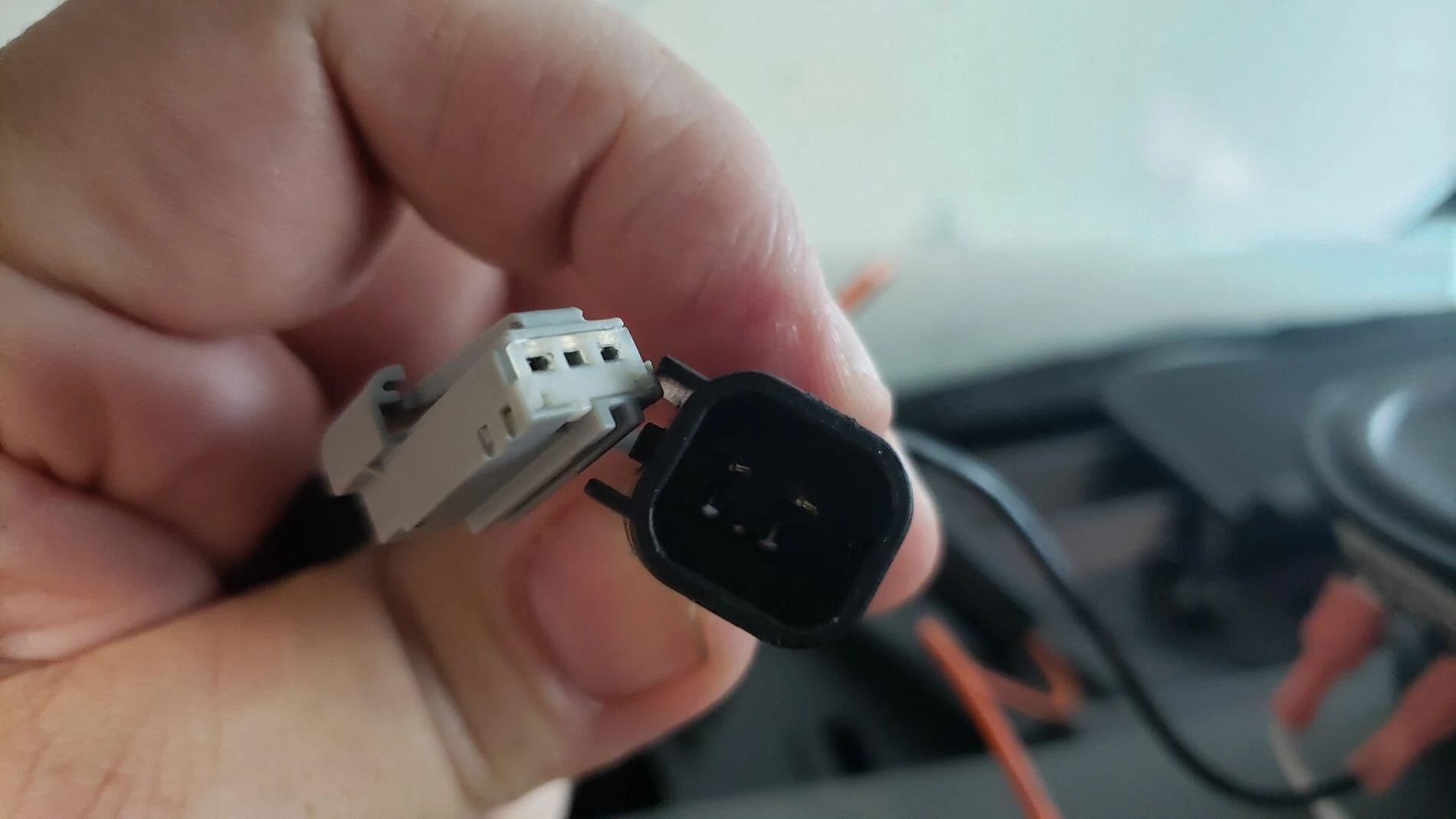

Metra 72-5600? I don’t think that’s the right connector.
You are actually correct. I got that # from this post it isn't the right connector but it worked, updated my post to reflect this (didn't even remember it didn't fit properly, I'm such an airhead, lol)
Does anyone know the actual # so I can update my post?

From the PP5 video it looks like the Factory plug is 3 prong. Both adapters noted. One is 2 and one is 4. So i dont think either mentioned would work plug and play?
The connector I linked does work, it just doesn't fit nicely into the factory harness.
