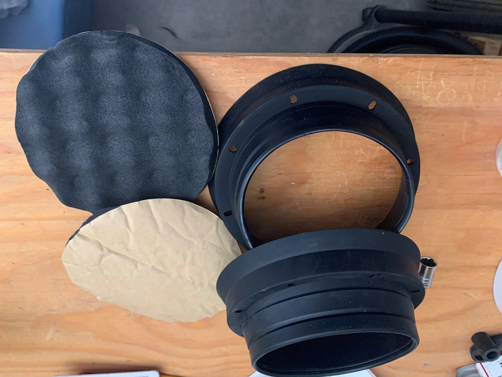

The kick panel speakers are plastic on metal with a gap. Definitely helps. Most other trucks I have had there is at least some kind of gasket.
I've used these before, easy to install and work great ...... (p/n NVX XBAF65)
Ford Bronco Base Sound System Upgrade/Build 6.5 baffles

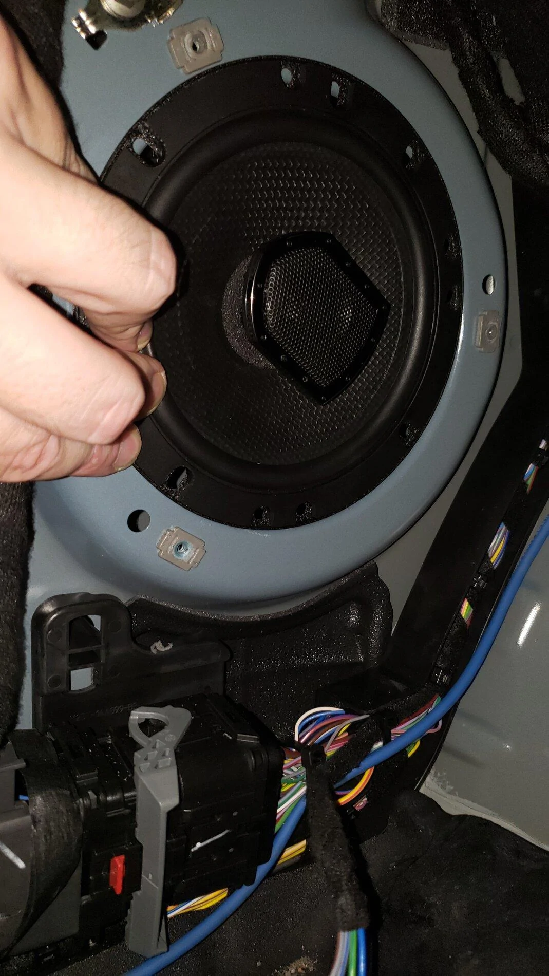

So anyone who replaced the 6.5" kick panel speakers, did your speakers actually line up with the enclosure's fastener points or did you have to use some sort of adaptor?
My 6.5" speakers pretty much fit inside the cutout in the sheet metal and don't come anywhere near the fastener points
Ford Bronco Base Sound System Upgrade/Build 20211009_151413
*EDIT* Found the answer in this post need Metra 82-5605 speaker adaptors (his post says 82-56055, but I could not find that on Metra's own website so I think it was typo?)
*EDIT* Found the answer in this post need Metra 82-5605 (his post says 82-56055, but I could not find that on Metra's own website so I think it was typo?)
Yeah, it definitely pays off to look at previous peoples upgrades to see the clip pattern.
